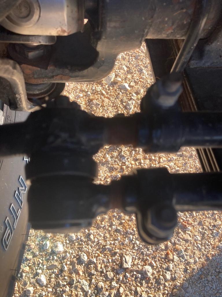

Hey guys wondering if I can get some help understanding something. When steering left or right I am having the drag bar twist and click while turning. Looking at it the tie rod ends bottom out at that angle which causes the clicking noise. Might just be paranoid but wondering if this is normal or not. I am worried about the wear on the tie rod ends.

I have the same question, it can't be good long term to have them moving that much. I think there is a post on here about silencing them.

Hey guys I ended up going with the cure. Took care of the dragbar twist and dead spot in the steering. Thanks for the help!!!
