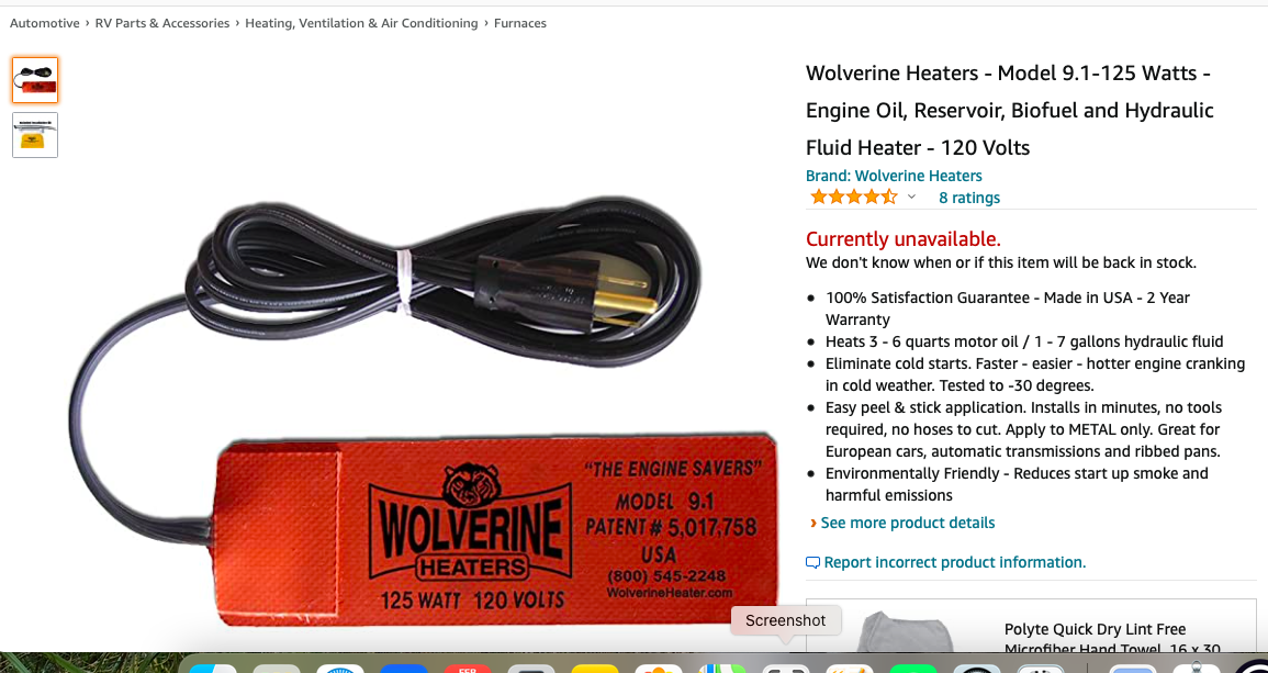

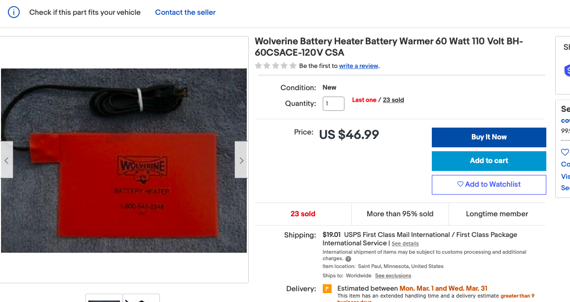

Try cycling the grid heater twice. Might help. A battery maintainer will help. Roxor had a cold start bulletin I saw sometime ago that suggested 2 oil pan heaters, one on each side (125watt if I remember), a battery maintainer and a 60 watt battery heater.
9.1csace-120v | eBay
Wolverine Battery Heater Battery Warmer 60 Watt 110 Volt BH-60CSACE-120V CSA | eBay

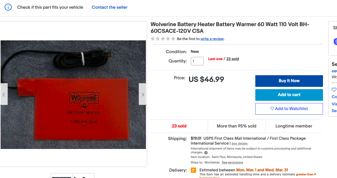

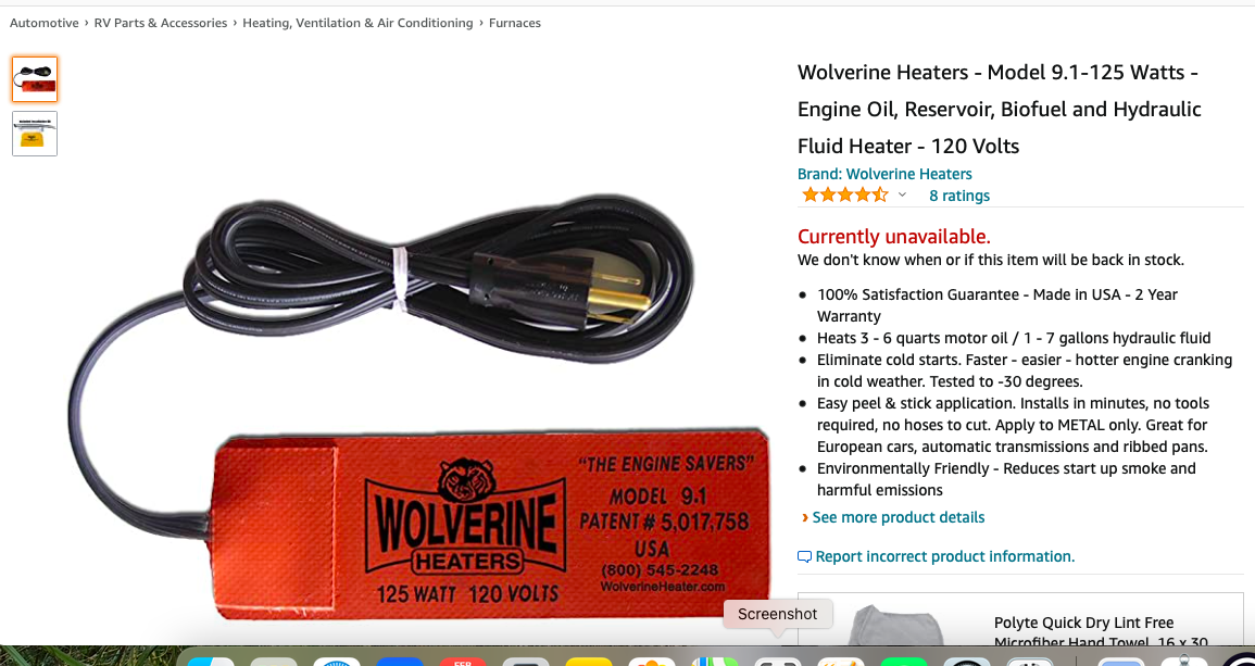

Thanks< I did cycle the heater a couple of times. Will look into the oil pan heaters for future use.
The pan heaters should help. A good maintainer is never a bad thing. I have a few of them on things or move them around every couple months on things that are sitting lots or parked for the winter. I keep one on my pick up cause I hardly use it and when I do its usually dead. It will sit for a month or more sometimes. If you have a maintainer on it, that will do more than a battery warmer I think.
