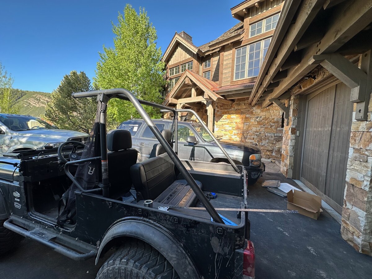

I stumbled into some roll bar braces that are almost a drop in fit for the back
the photo is a work in progress
weld some base plates, straps on the top, trim the stubs up top, krylon, ready…
part # C3185 $82

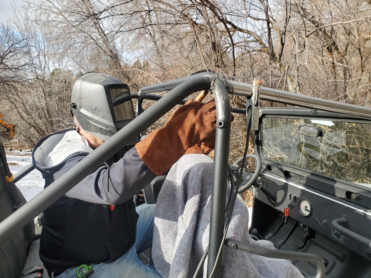

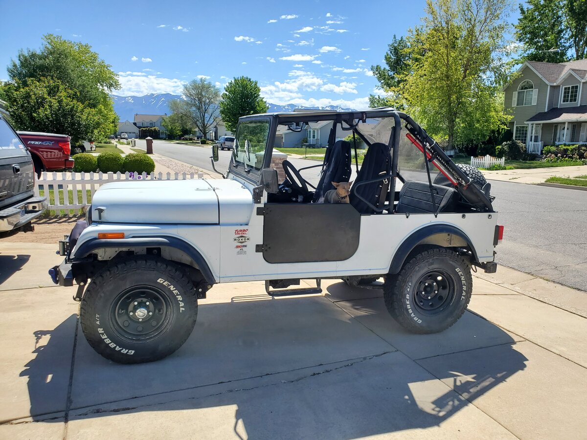

I went the cj route with my 2020. Bought a new windshield Frame for $89 bought glass for less than 100. Cj mirrors. Cut off top brackets and welded Sport ropes directly to windshield. Running a Cj bikini top. Made brackets to mount horizontal bars directly to windshield. Wow I checked out That website I didn't even spend half that amount to get it and I'm also running the jeep dash

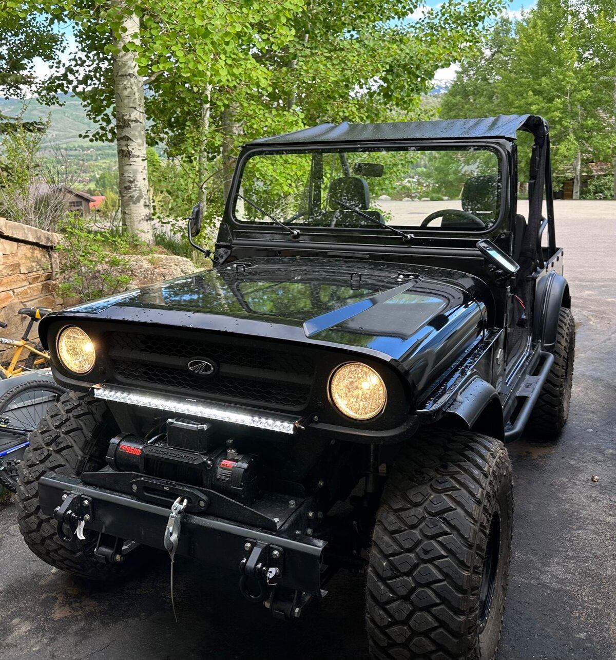

I was in the market for a new windshield, so I reached out to jeepglass.com. I really like the minimal frame around theirs as it would minimize any blind spots. The guy I spoke with was very helpful, but not very familiar with roxors. It turns out, like the cj frame, it is not compatible with the rops. Seems like a great product if you are willing to remove or modify the rops.
I spoke with Wade at diesel freak and ended up going with his. I like the idea of keeping the rops intact, while also gaining the cheap/easy replacement of standard cj glass when needed.
