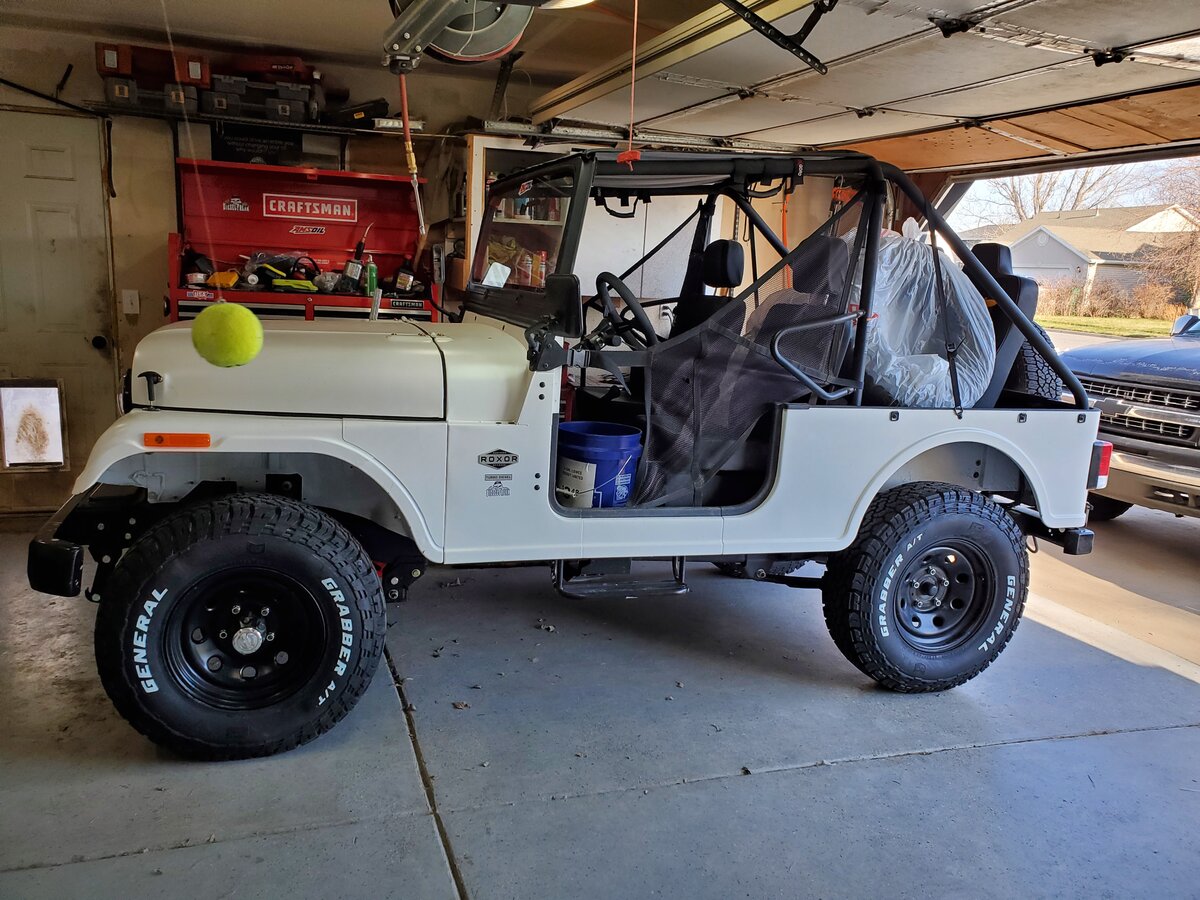

Anyone have pics of stock to 235 85R16 pics

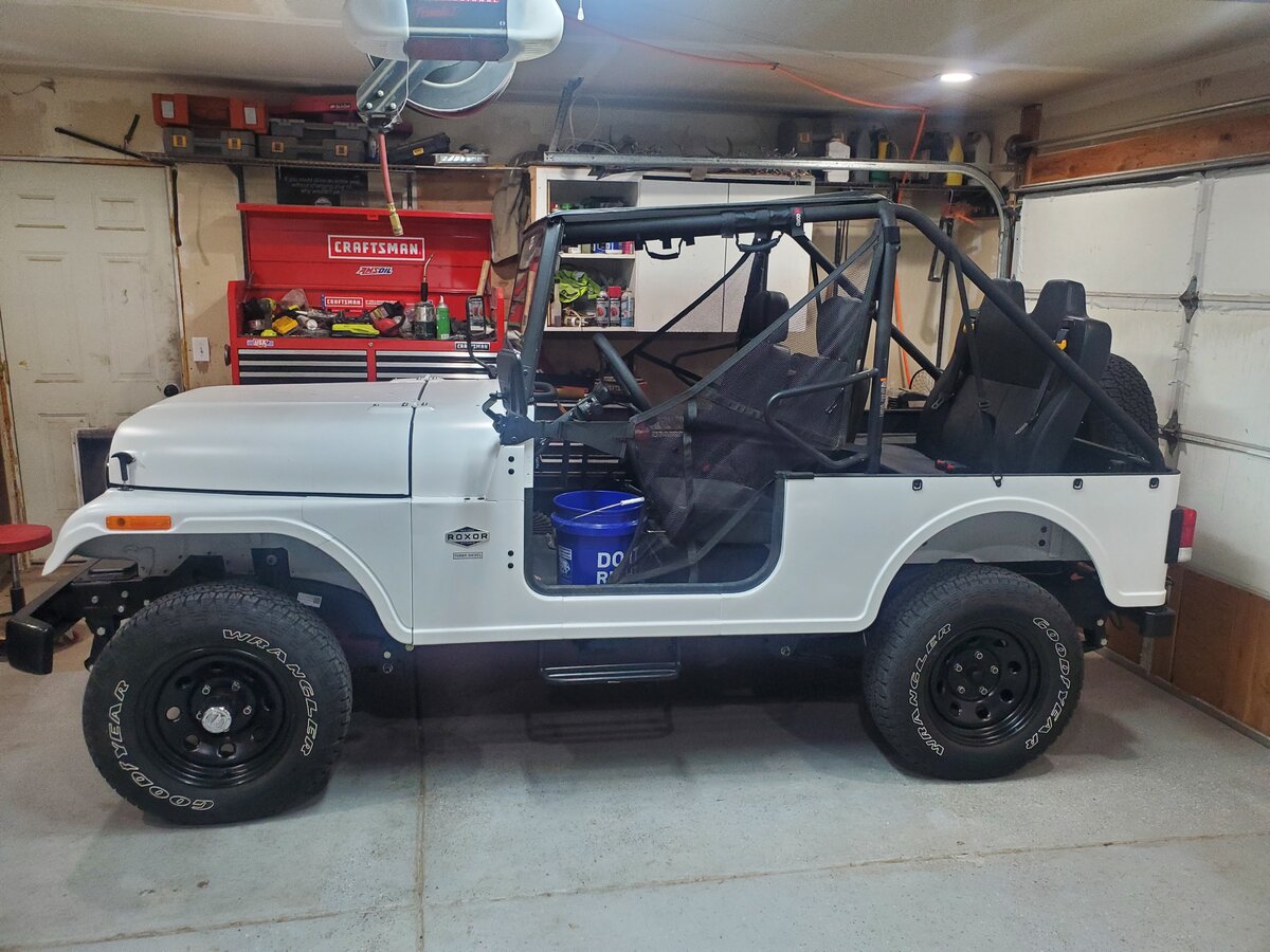

Well those almost worthless tiny tires sold. 200 for the 4.
All I did was leveled the front. Still think it would have fit but it's looks alot better now

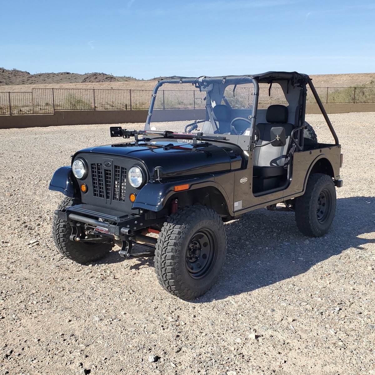

Those Crosswind MT are nice. Did you ever get them installed?
I went with Multimile tires instead ,a little rubbing but stops are all the way in ...So if I use the 1.25 Cmax shackel lift on the front only will it steer ok?
You might need to use shims to adjust for just the shackle lift. Talk to Max.
