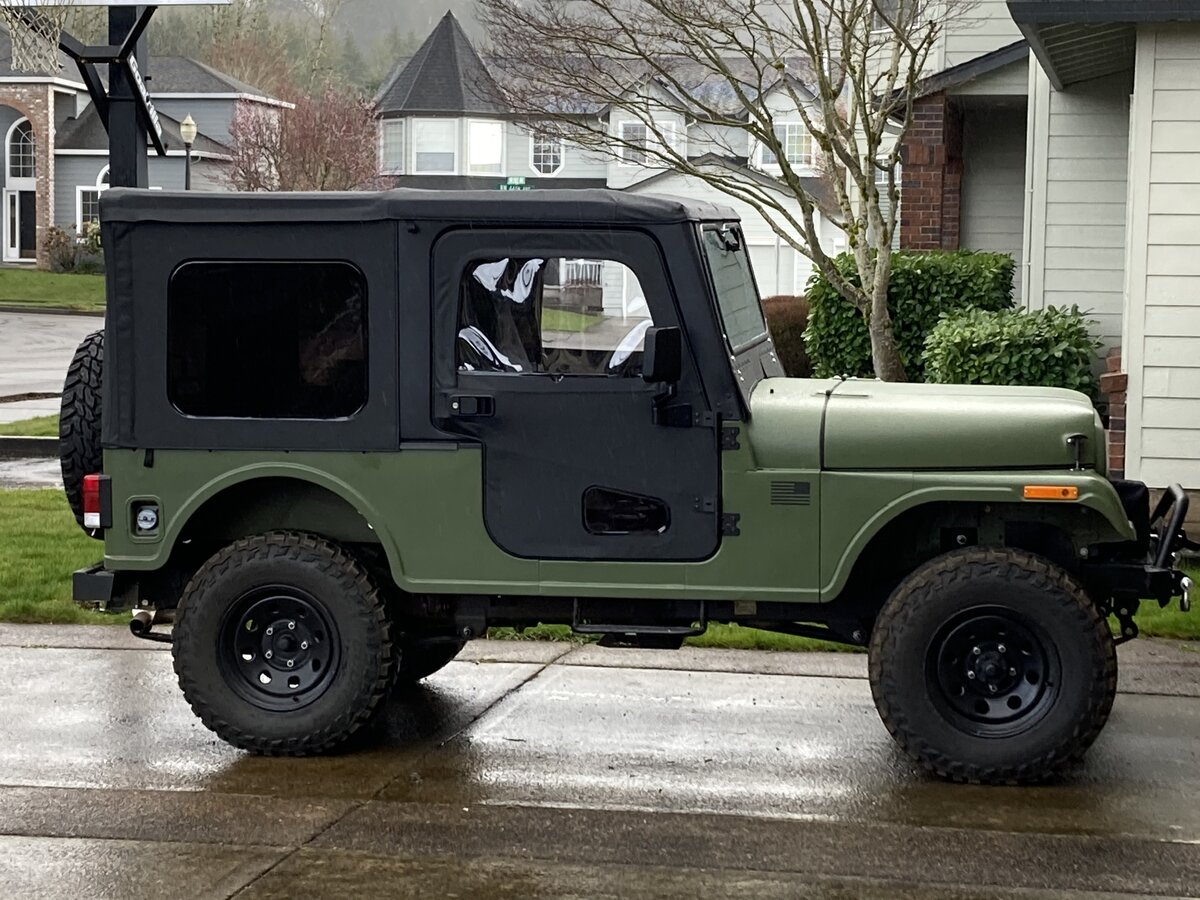

I was one of the guys that got a bad set from Sherwood/Roxor. My scenario was a bit different though. After waiting 10 weeks, I got the shipment but it included 2 right side ROPS bars. One was a perfect fit and the other would’ve required some filing. Waited another 6 weeks to get a replacement. All I needed was a left bar but they sent another full set. The “new” left side bar did require some filing to fit the B and C pillars. I had received the full soft top after 6 weeks and finally got it installed after 16 weeks, due to this rear ROPS issue with QC from Roxor. Obviously, it took some patience on my part but Sherwood (Dustin) was good to work with. All in all, it was worth the wait and the full top is outstanding.

Looks nice. Who's windshield?

It’s a Dirt Warrior fixed windshield. I really like the vents. I was fairly concerned about how it would fit with the roxor (bestop) soft top but it worked out very well with some minor modification.
