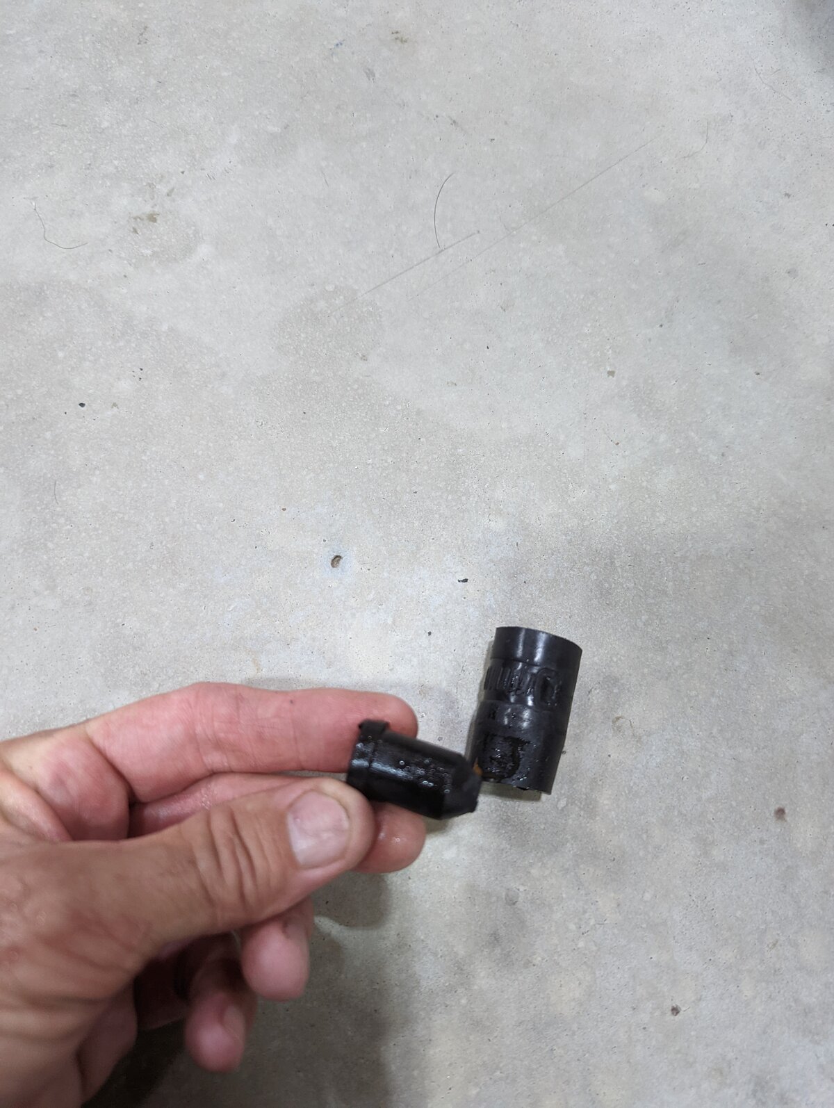

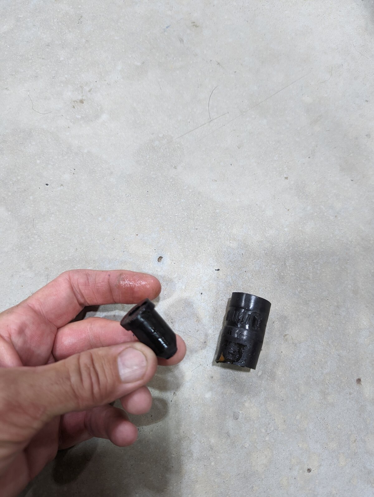

Tonight I pulled the heater hoses off and tried blowing air through the core. No air would pass through from either side. Something is wrong with the core. I'm calling the dealership Tuesday
Barnboy
Nov 2, 2022
73
Cleveland Oklahoma
Yep it's a plug's on the core.
Barnboy
Nov 2, 2022
73
Cleveland Oklahoma
You will need to remove the heater hoses and pull the rubber plugs out. It's not an easy task. I didn't remove my dash all the way and it was a one handed one eye kinda a job. It would be much easier to remove the dash if your ambitious. I had to cut the hoses and replace them. The factory didn't leave any extra hose.

Factory didn’t pull shipping plugs from heater. I had dealer do mine last week. 2 hours to cool off, then drop the ac box find hoses then pull plugs out. Heater works now. Big production line snafu. Mahindra knows about it. Dealer had 5 units and one delivered with same. Rubber shipping plugs from vintage air In heater core.
