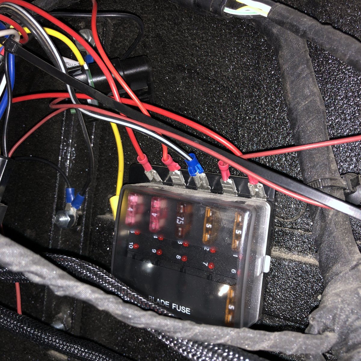

The Roxor harness was designed and is built in the US specifically for the Roxor. As for adding accessories, I added a separate fuse box that comes on with the key using a relay off the low power wire going to the power point in the dash. Now all my accessories go on there. If they are high power and require another relay, I use the extra fuse box to trigger the relay which is then run direct the battery. Doing it this way insures everything gets shut down when you turn off the key. The other option is to buy the Roxor power box, plug and play. I didn’t crawl back under yet to tie everything up nice.

Thanks for the clarification. I kind of suspected that the harness was Roxor specific. I totally like your wiring idea and may end up getting the Roxbox.
