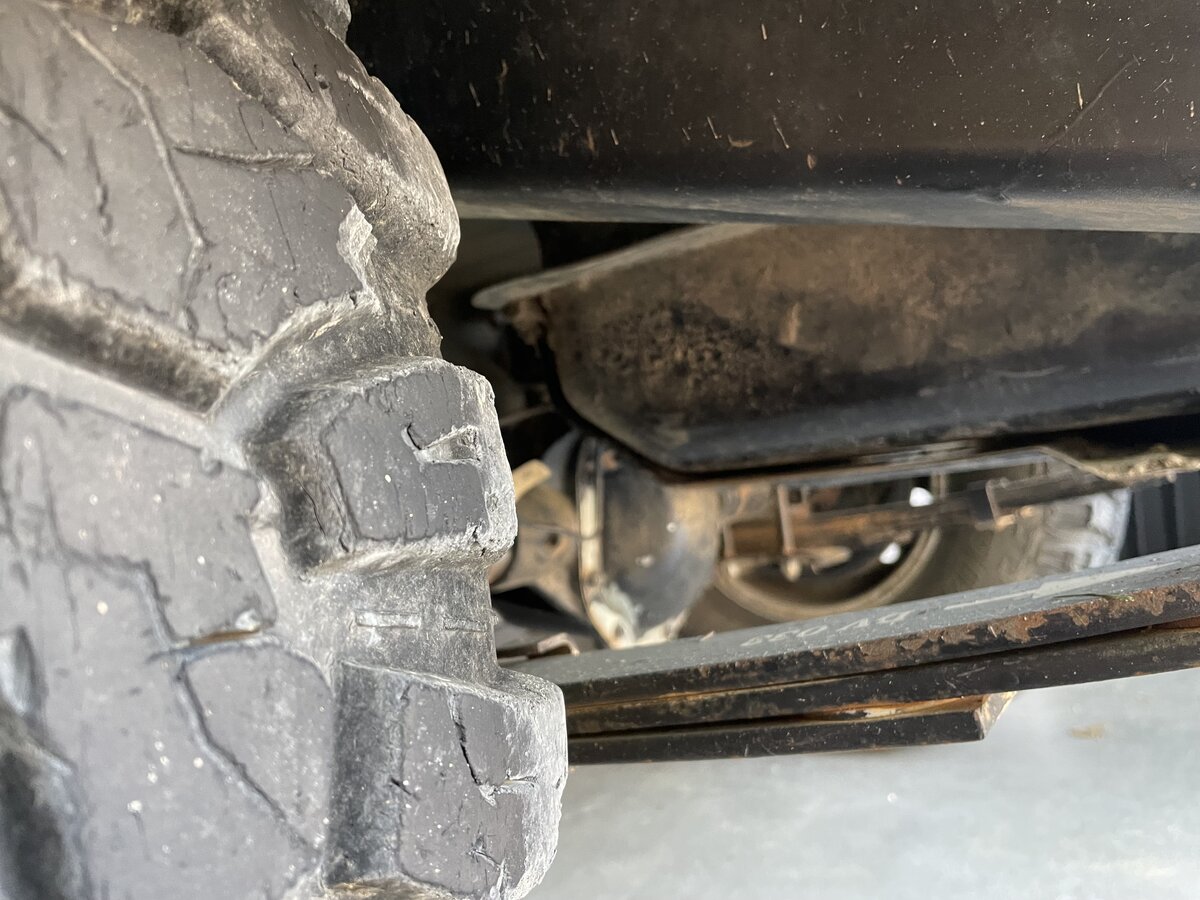

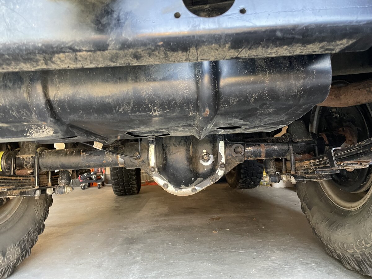

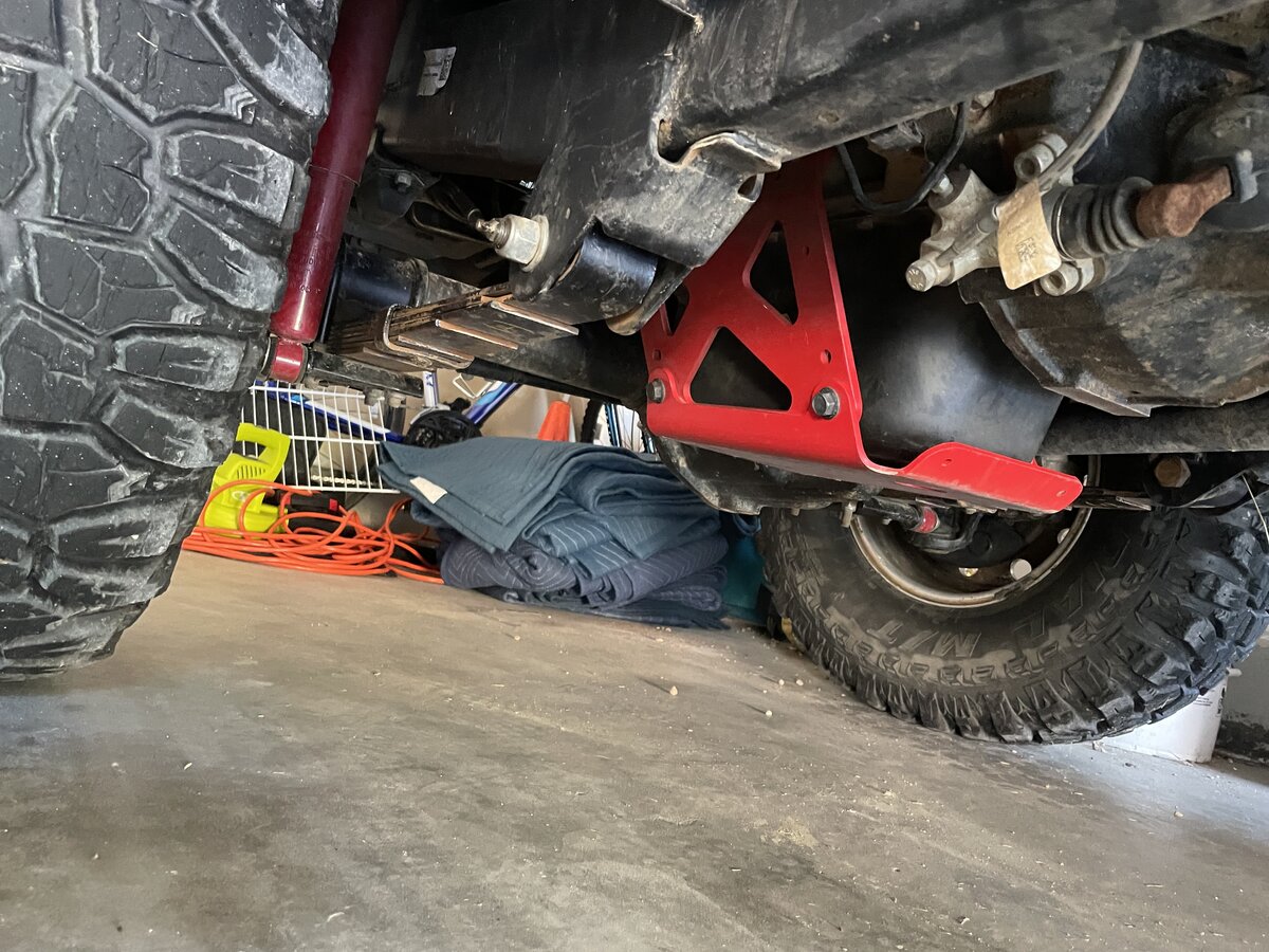

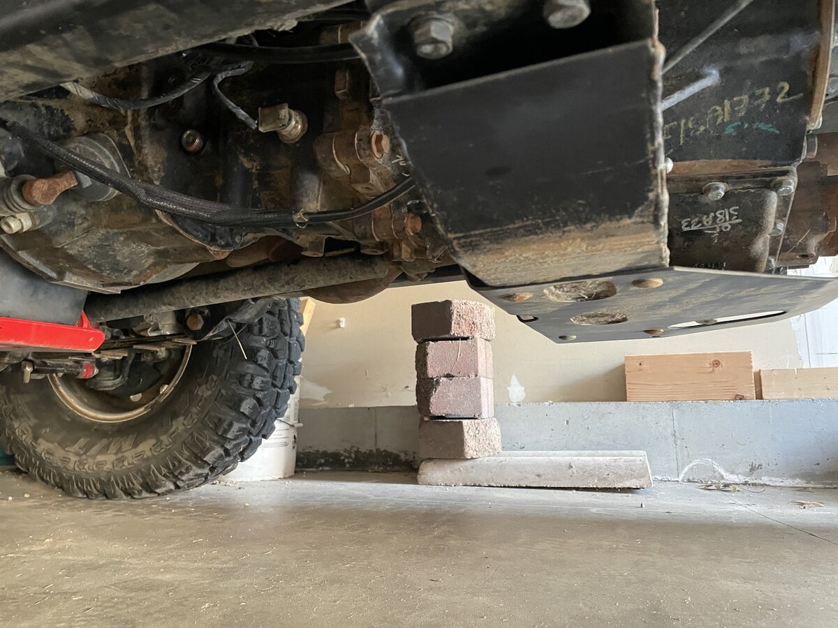

Here are 2 pics of my fuel, one of my tranny and one of my oil pan. Can anyone tell me the maker of the oil pan? I assume the others are OEM? They do not impress.

Those are all factory skids.

I’ve already said it’s a factory oil pan skid.
Yes you did and thanks for the info. This is the only ROXOR I've ever seen and it was so different than the other two OEM aluminum foil useless pieces that I wasn't sure. Didn't mean any offense and truly appreciate all the help you and others have given me. Thanks
