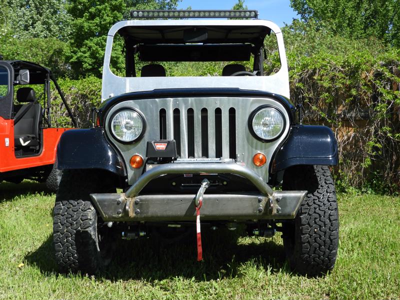

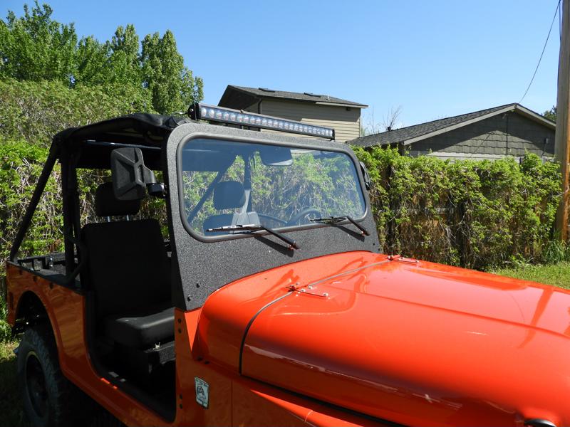

Hey everyone! We are currently working on getting our turn signal harness packaged up and available for sale! We are also working on a glass windshield frame along with wipers and everything else that we would need to help get these street legal! Check out our Facebook and Instagram pages as well, we will be developing aftermarket parts for every aspect of these Roxors! We will make sure to let everyone know as soon as we are ready to ship!

Our glass windshields, and turn signal conversions are developed and we will begin taking orders as soon as our packaging comes in. In the meantime let us know now if you want one! We have eight turn signal harnesses ready to go!

The LE does not come with a windshield FYI
