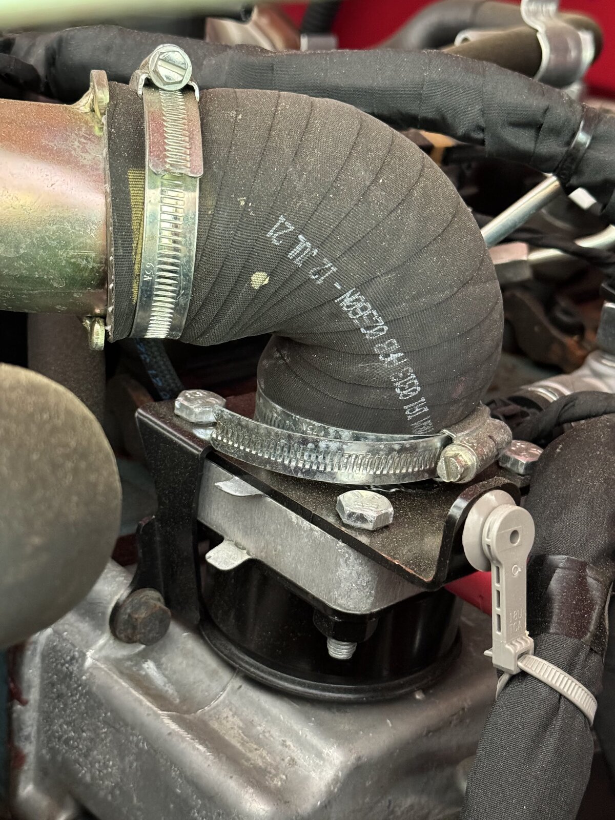

I picked up a new (2022) Roxor Friday from a dealer (had 31 miles on it). It already had a tune from Diesel Freaks on it. How can I know for certain that it is tuned? I just took it out for a spin and on the highway, I could not go any faster than 60.
Sasquatch
Jun 6, 2024
86
GA
7953

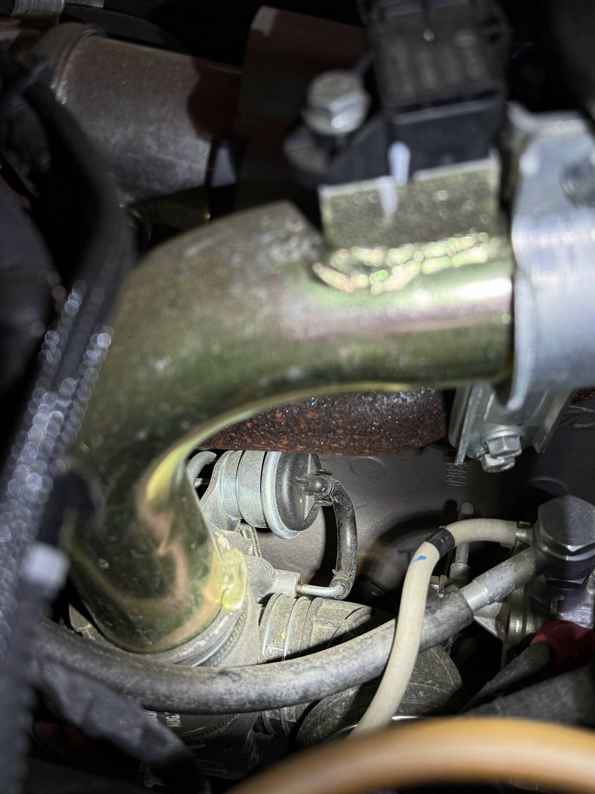

I also don't see a boost valve?
Is this at least the Diesel Freaks intake?

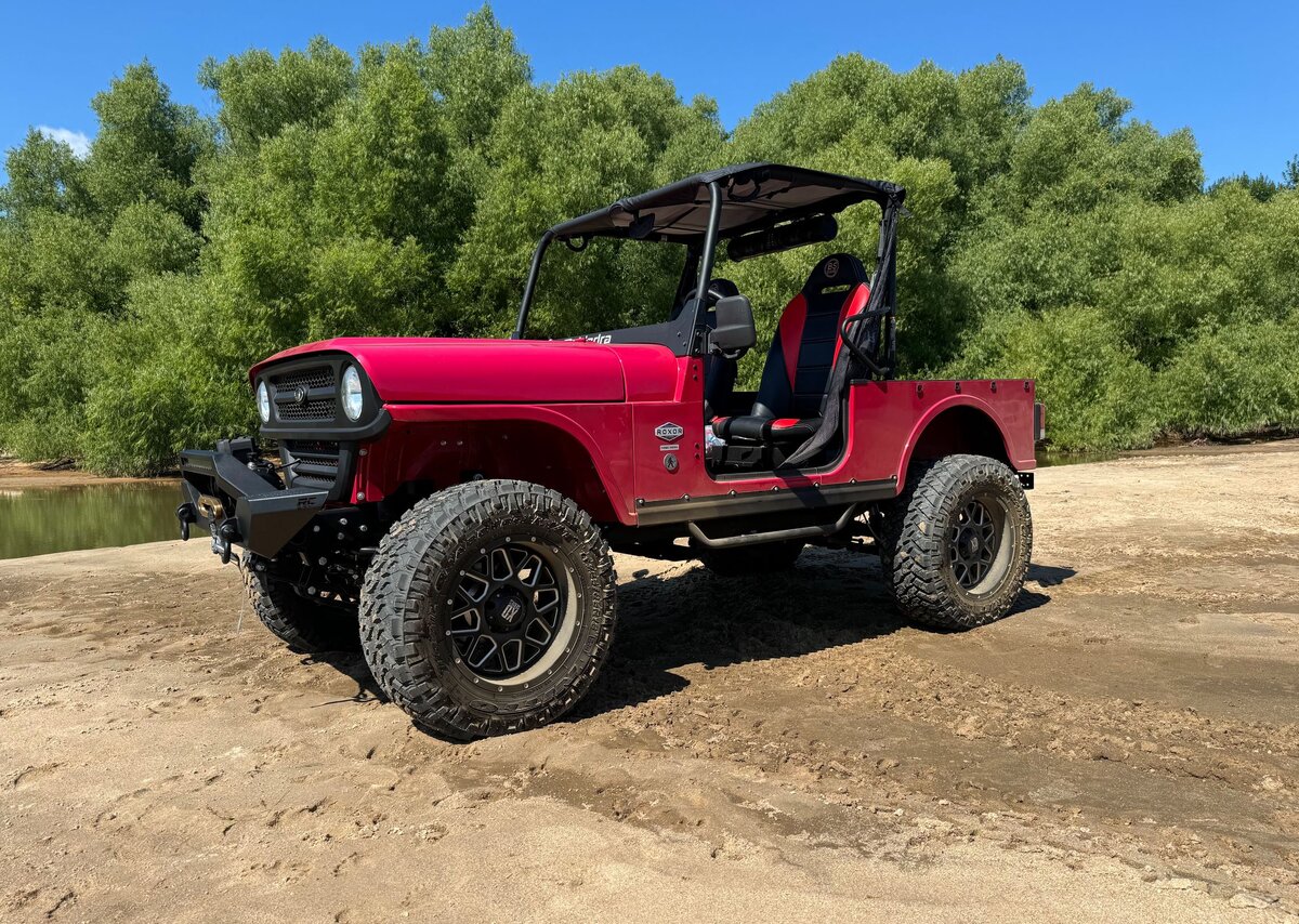

Looks like it’s this one.
