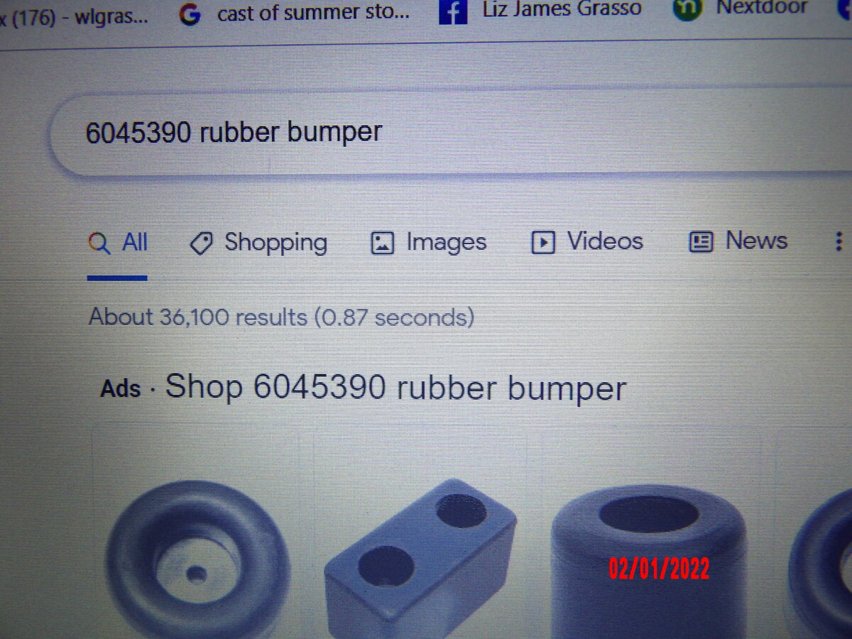

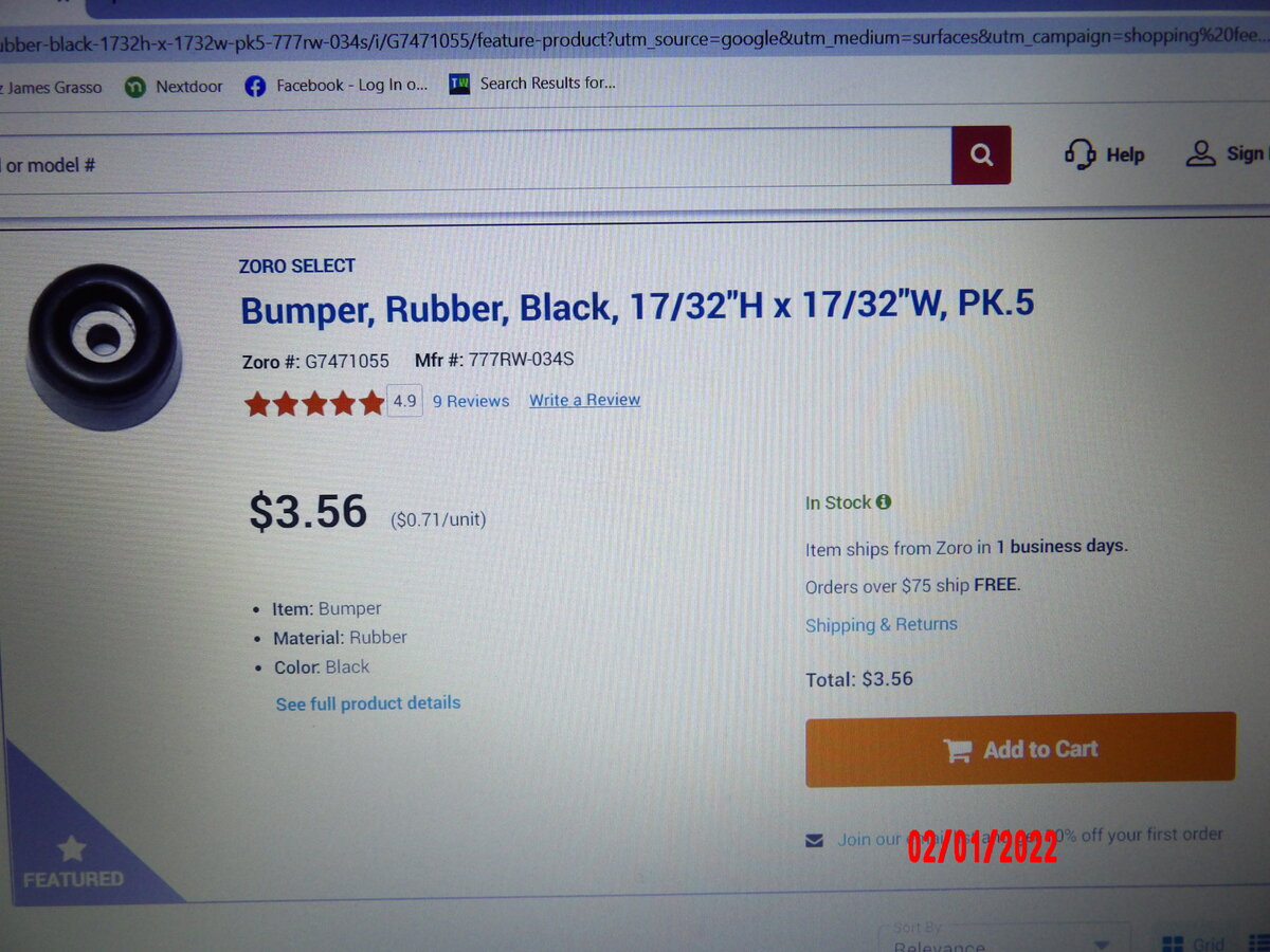

Basically, depending on the space that you have between the tire and the tailgate, you're looking for a piece of rubber that will fill in the gap. Check this out....there are multiple sizes and shapes that you can customize. Do a google search for #6045390....nobody will see it, it will be behind the tire and you just customize it to fit.
