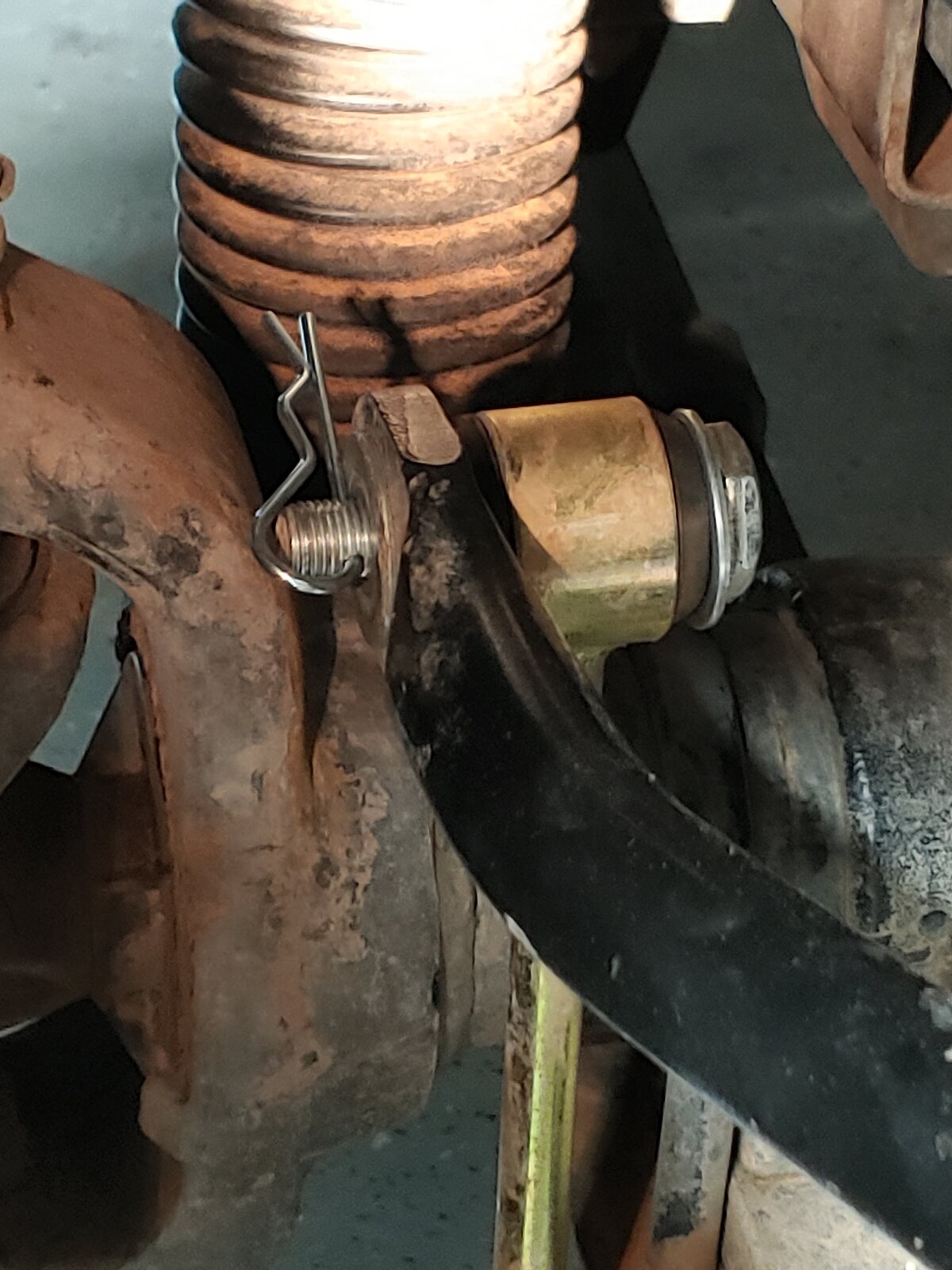

I quickly removed mine when I did the level lift and left them off. Works for me. The increased sway is not detrimental IMO. Just be cognizant of it when driving and don’t try and drive it like a drift car.

Put YJ springs and bilsteins on it. OHVs don't need sway bars if you know how to drive. With springs only, no front shocks, it was a little scary how much body roll I got doing a 90° turn at 10mph.
814
You guys bring up the why. My 85 CJ7 didn't have a front sway bar why is this on the Rox. Cloud you're crazy without shocks it dangerous. Remove sway and put on shocks.

I used a set of discounts from rough country. For a yj? Ill try to find the part number.

So you have left yours off?
814
I'm sure the drive style is alot like the Cjs. Had a 85 CJ7, it didn't have sways and I survived my teen years just fine. How's road driving
I put them on. Only drove about a mile without shocks.
1,203
Just fine. If your wanting to do drifts around corners you might not like it but if your driving like an adult it drives fine.

I put disconnects on mine, I found driving at speed to and from the trail to be a bridge to far at 60 to 65 mph. I live in Southern AZ and it takes some miles to get to any trailhead and having that extra bit of stability is nice.
2,194
That's kinda where I'm at. I like the option of using it or not. Around town, definitely, off road not so much.
Do you remember the part #?
2,194
We will see how this works.
