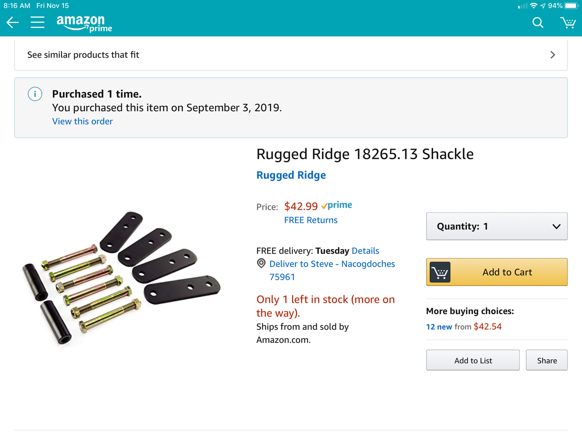

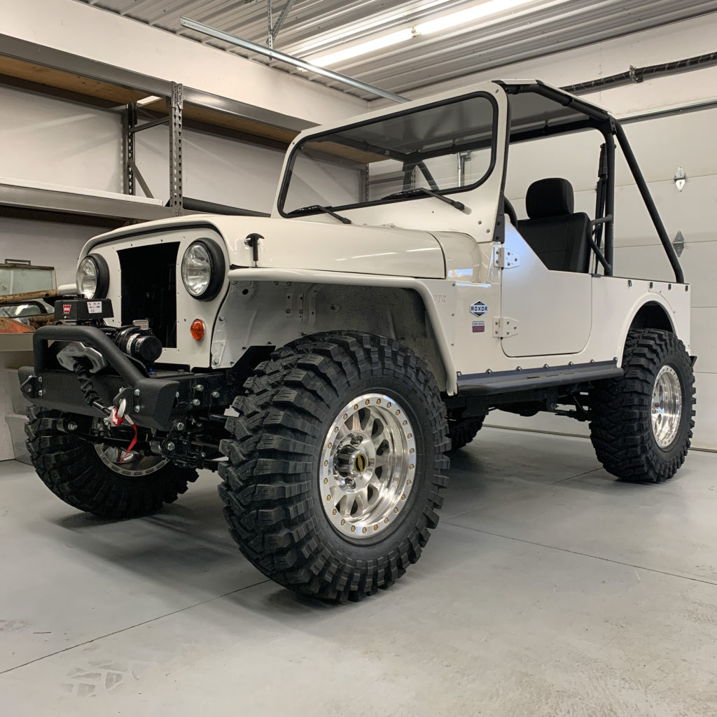

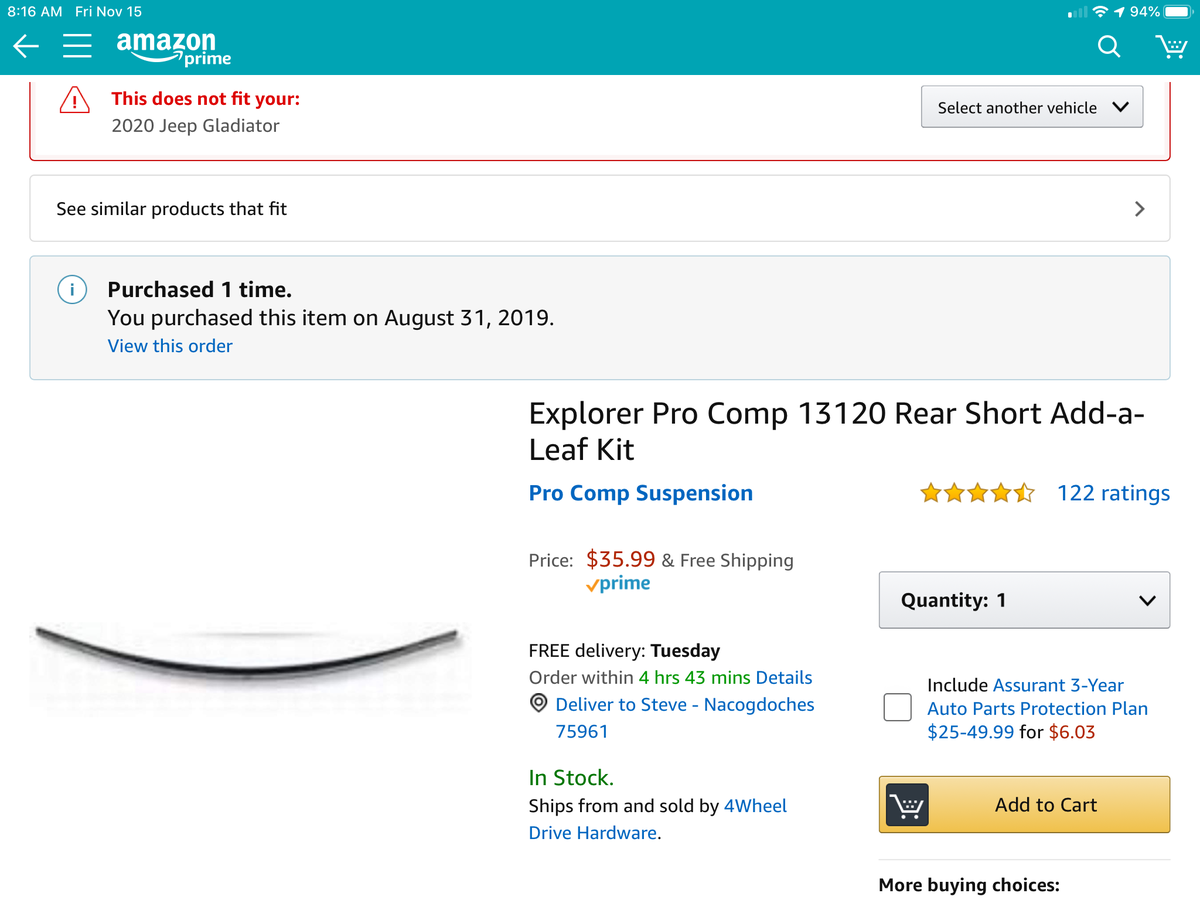

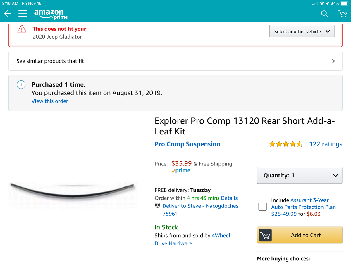

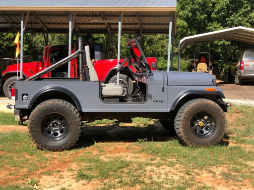

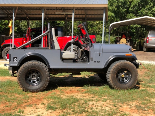

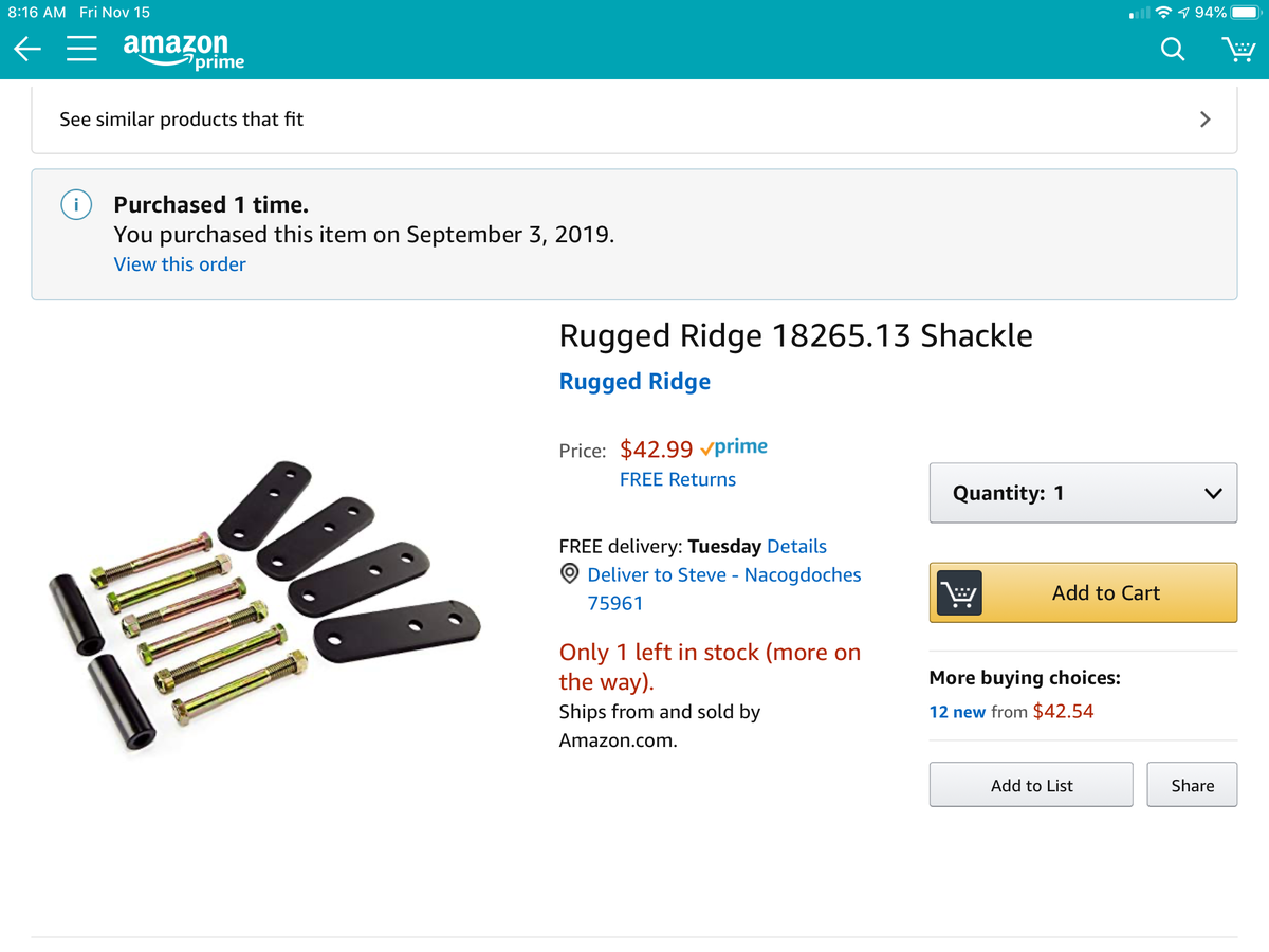

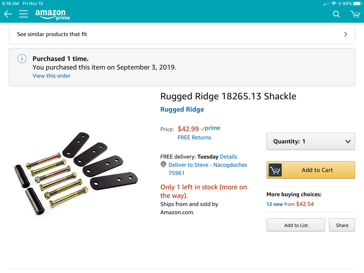

What size tires are you runningI installed an add a leaf to the front and shackle lift to front and rear for around $120. 00. Didn’t have to change shocks or brake lines. This is the add a leaf and shackle kit. Installed shackle kit front/rear.
Sent from my iPad using TapatalkView attachment 5255View attachment 5256View attachment 5257
