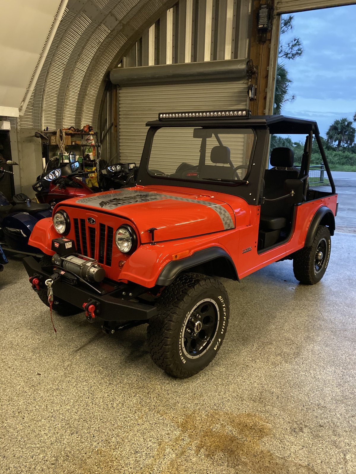

Just installed rough country lift 299.00 looks and rides excellent
1,123
The rough country kit relocates the shocks and has longer brake lines. It uses shackles in the front to lift it but also has a drop bracket that lowers the rear spring mounts. doing it this way retains the same caster and pinion angle as stock.

Thank u it’s rained every day since I’ve installed them but but I’ll get more time on them this week end

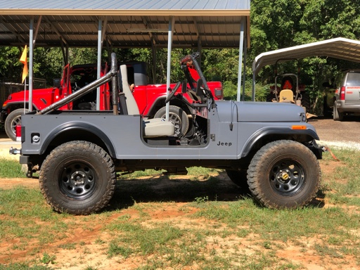

I installed an add a leaf to the front and shackle lift to front and rear for around $120. 00. Didn’t have to change shocks or brake lines. This is the add a leaf and shackle kit. Installed shackle kit front/rear.

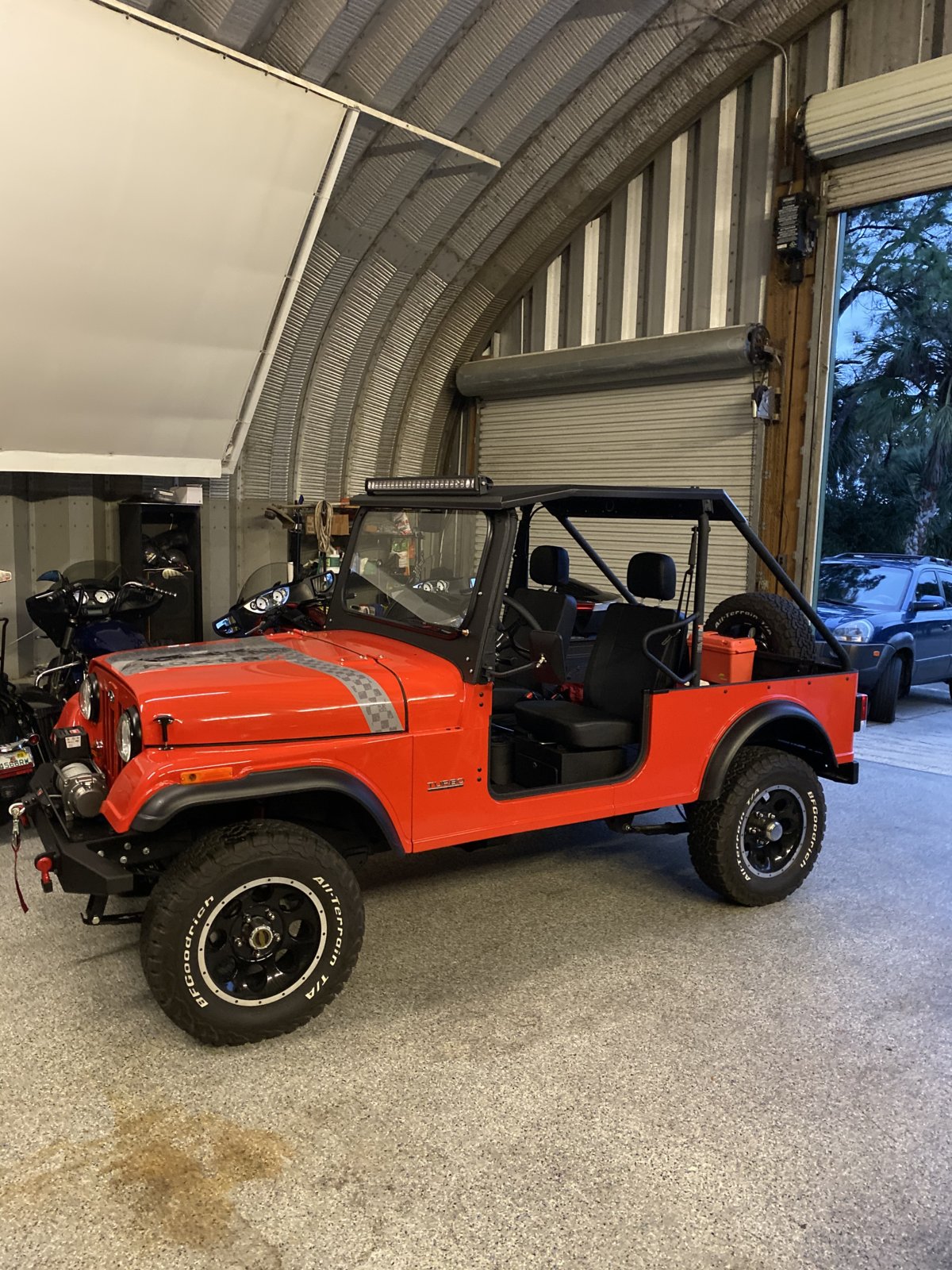

Roxor looks good Steve I started with add a leaf and slight recurve but it still wasn’t level and ride was little firmer the little time i got to drive this the day of install it felt great but it’s rained four days in a row typical Florida tomorrow is supposed to be great so I’ll test it then what type of seat u running that will be my next upgrade would like some input

Bestop CJ seats
