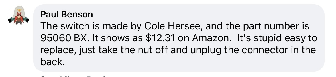

Here’s the info you need for your key switch
