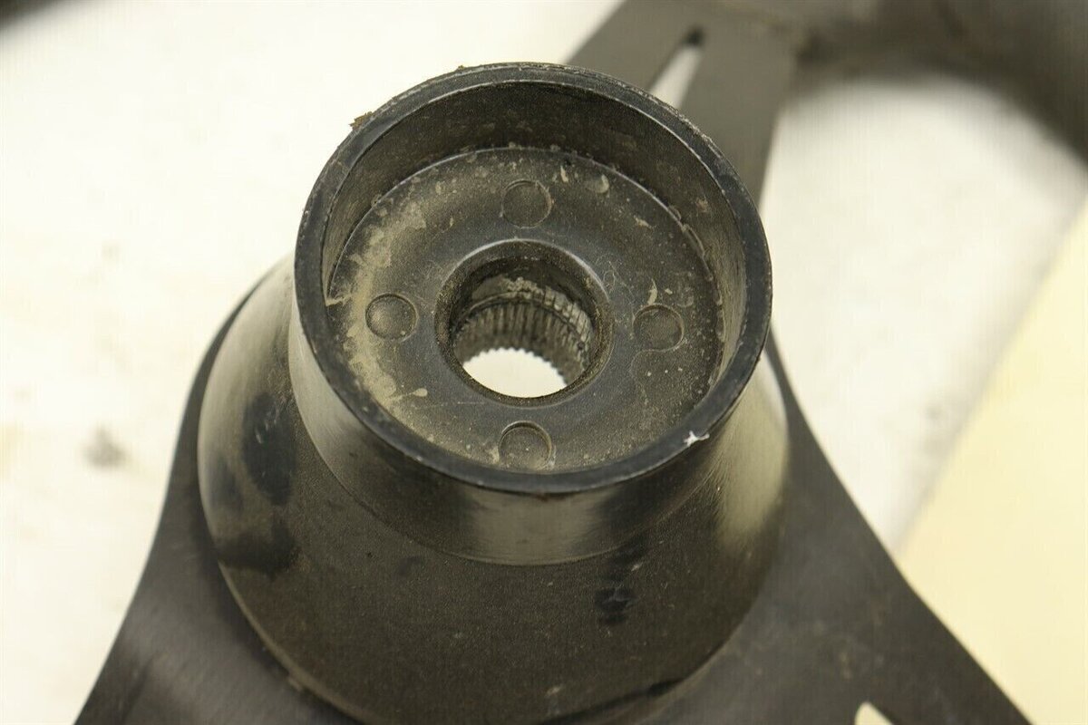

Thinking about replacing the stock Grant steering wheel with a retro Willis wheel. Is the steering column splined ? Any advice out there from the retro crowd?
All steering columns are splined. Looks like a standard 11/16 shaft, 36 spline. Haven't pulled it off to verify yet.

Anybody know??? I guess i could just pull the steering wheel off, but to be honest I dont know what I am measuring to get the correct size?
The Roxor steering wheel is basically a Grant 1160 with a textured grip.

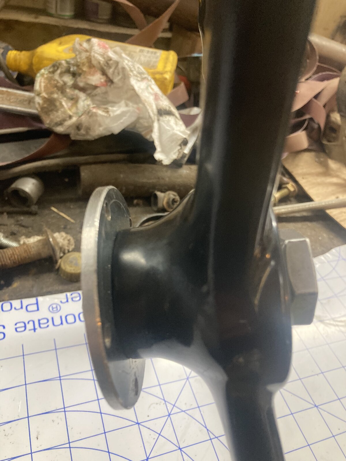

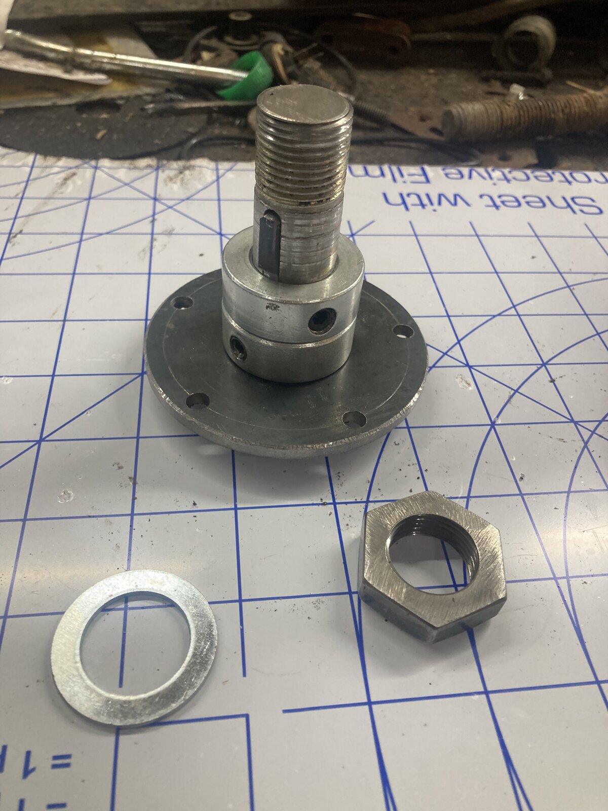

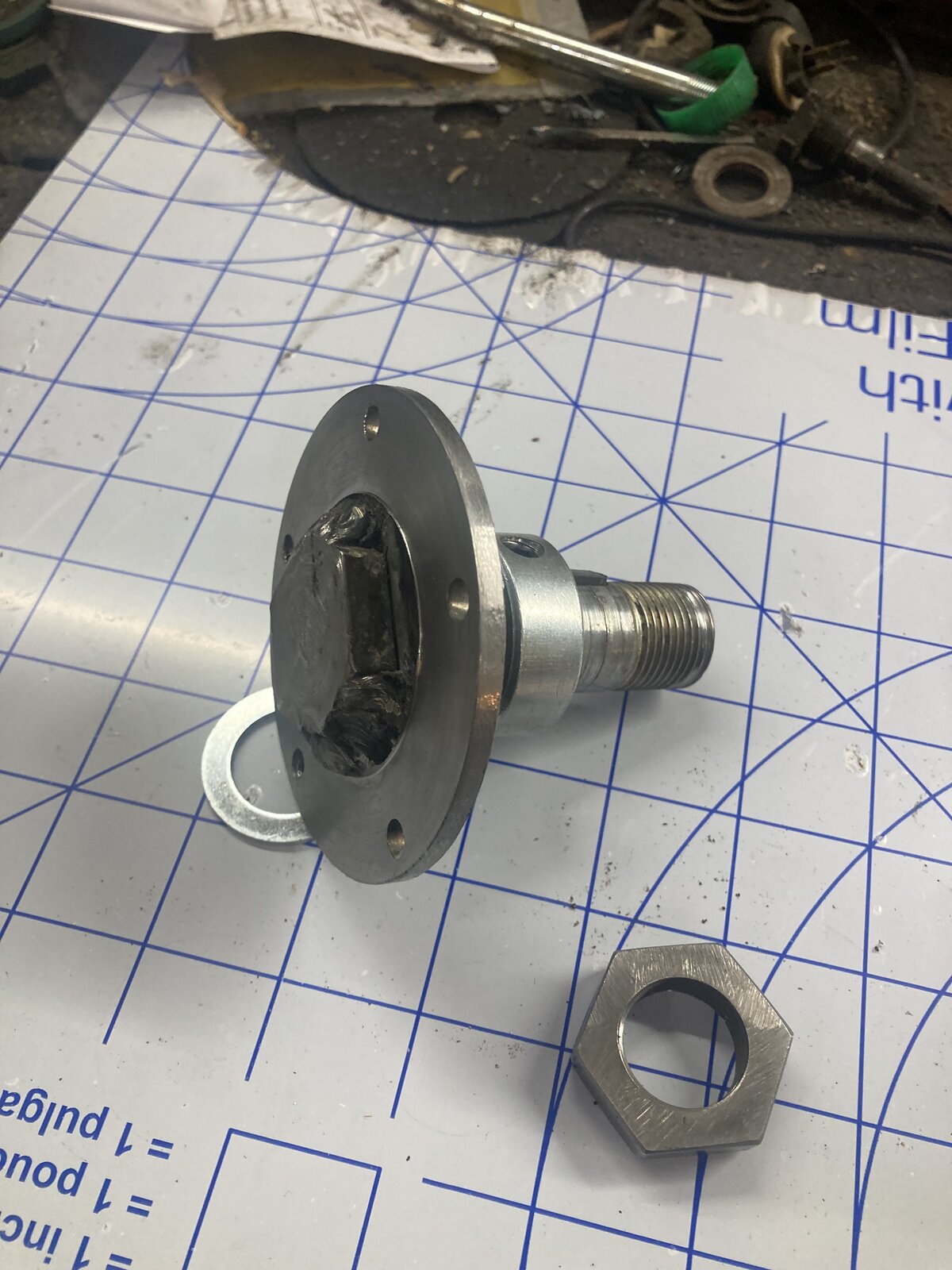

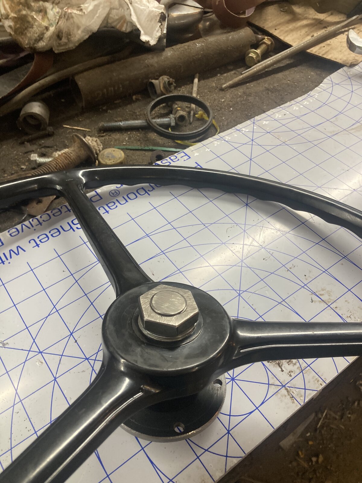

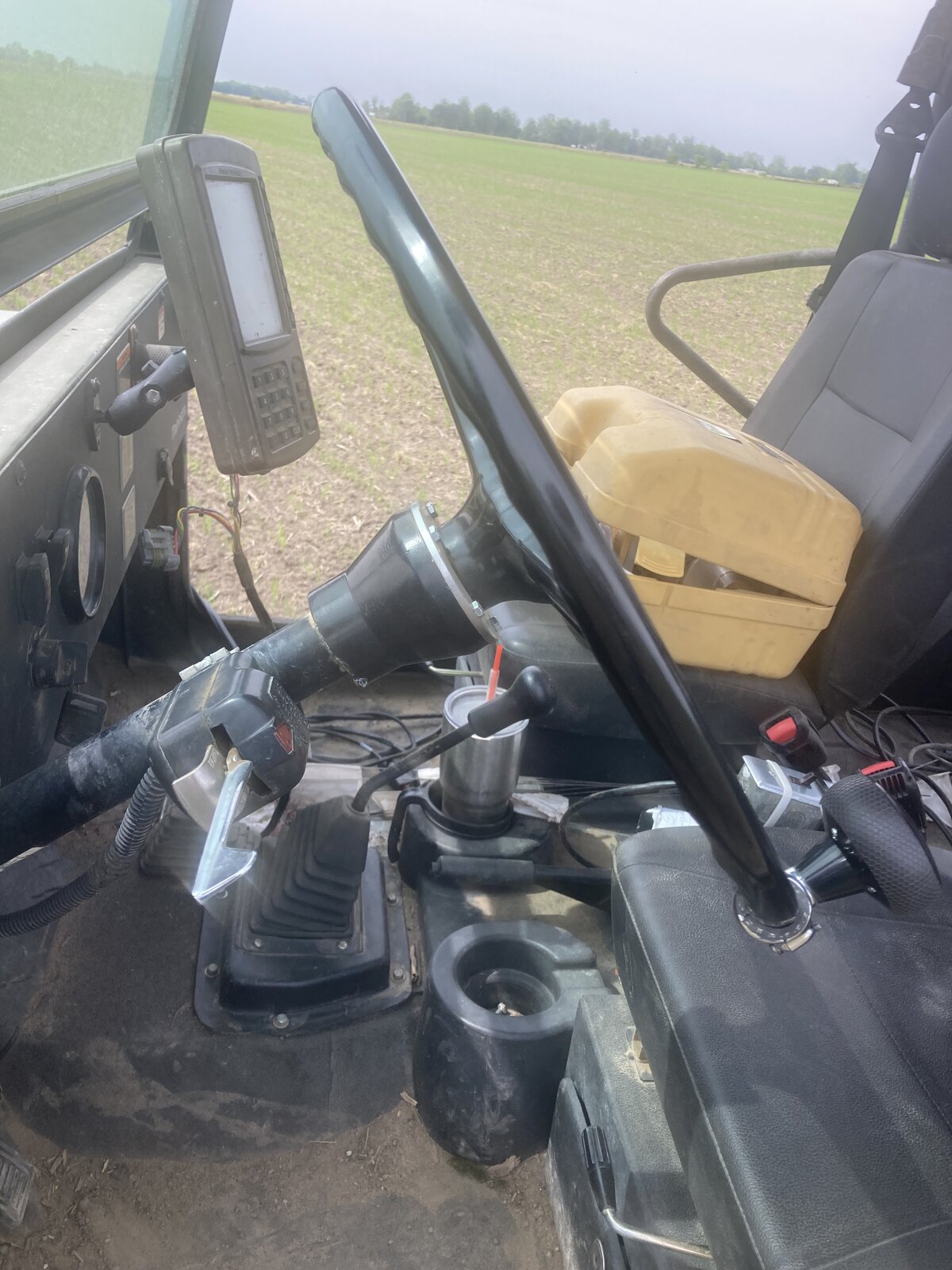

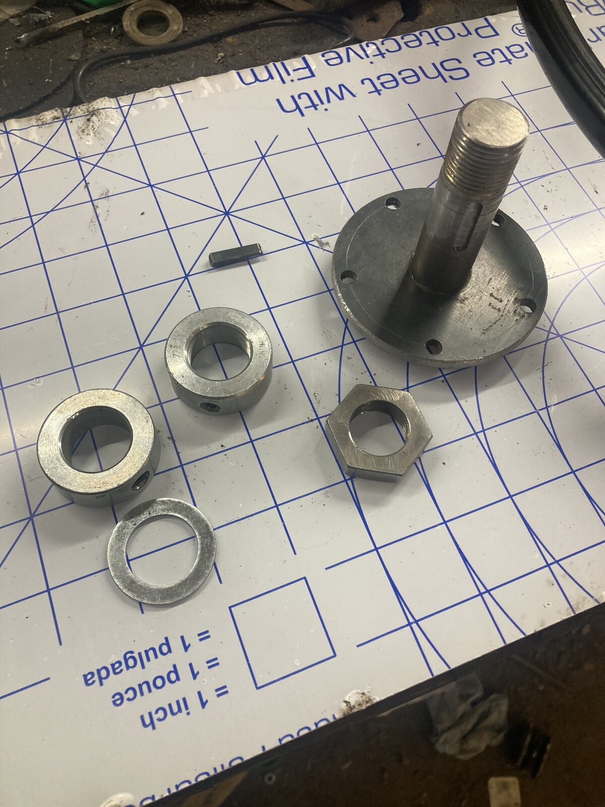

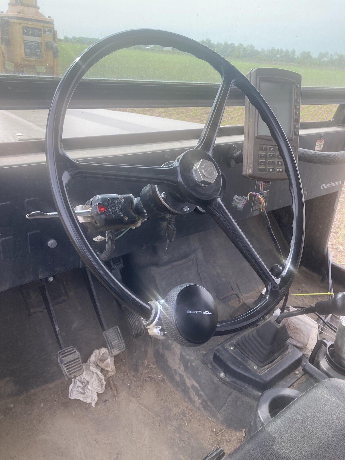

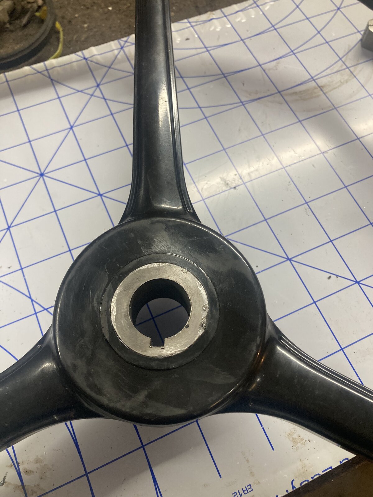

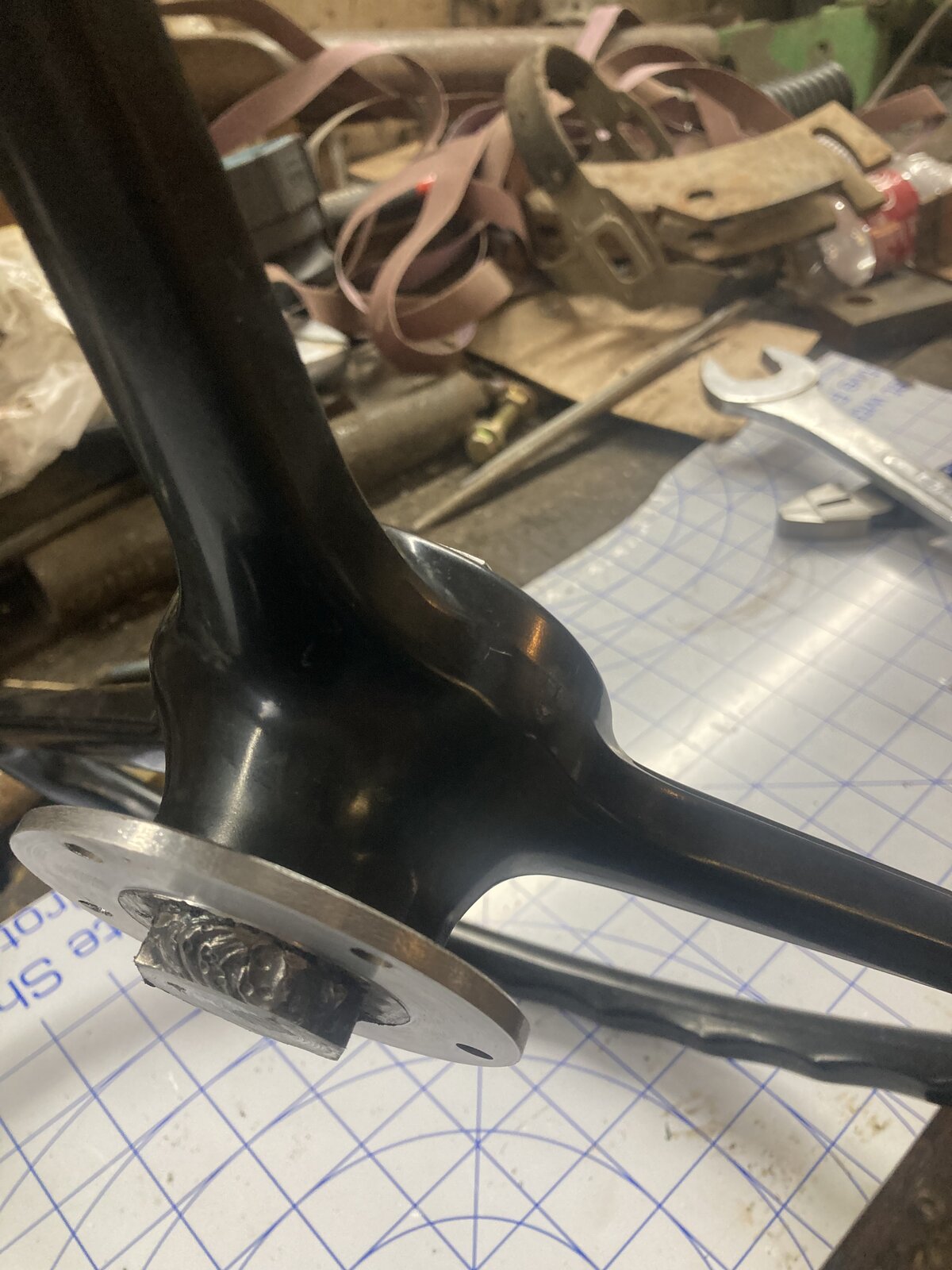

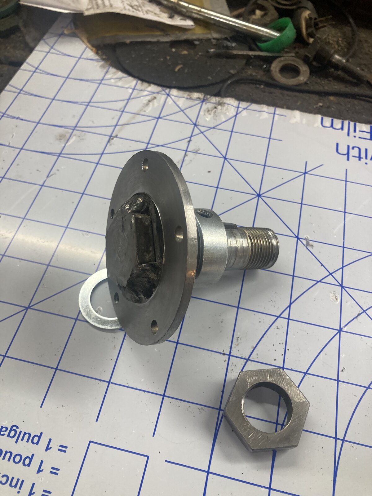

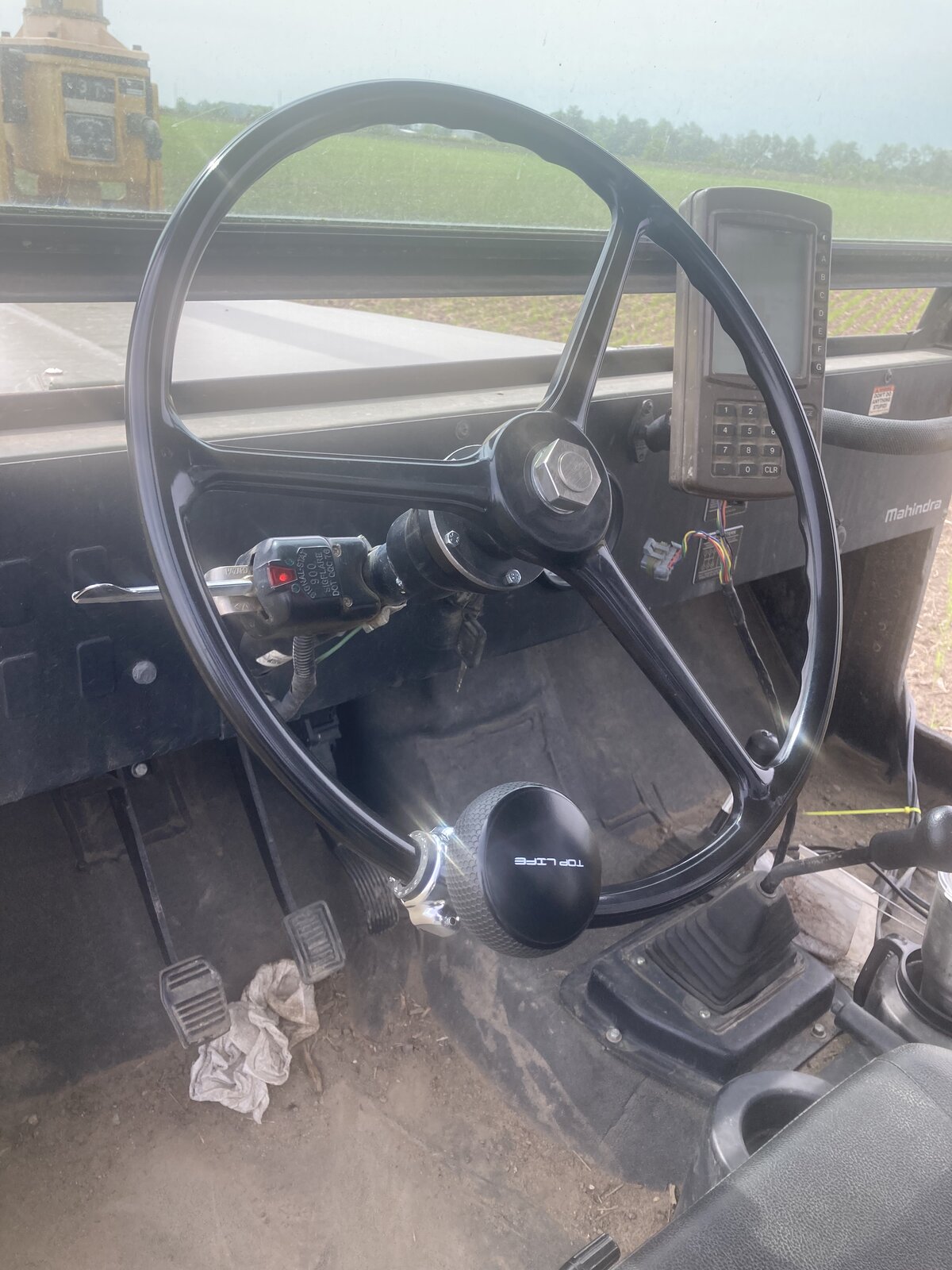

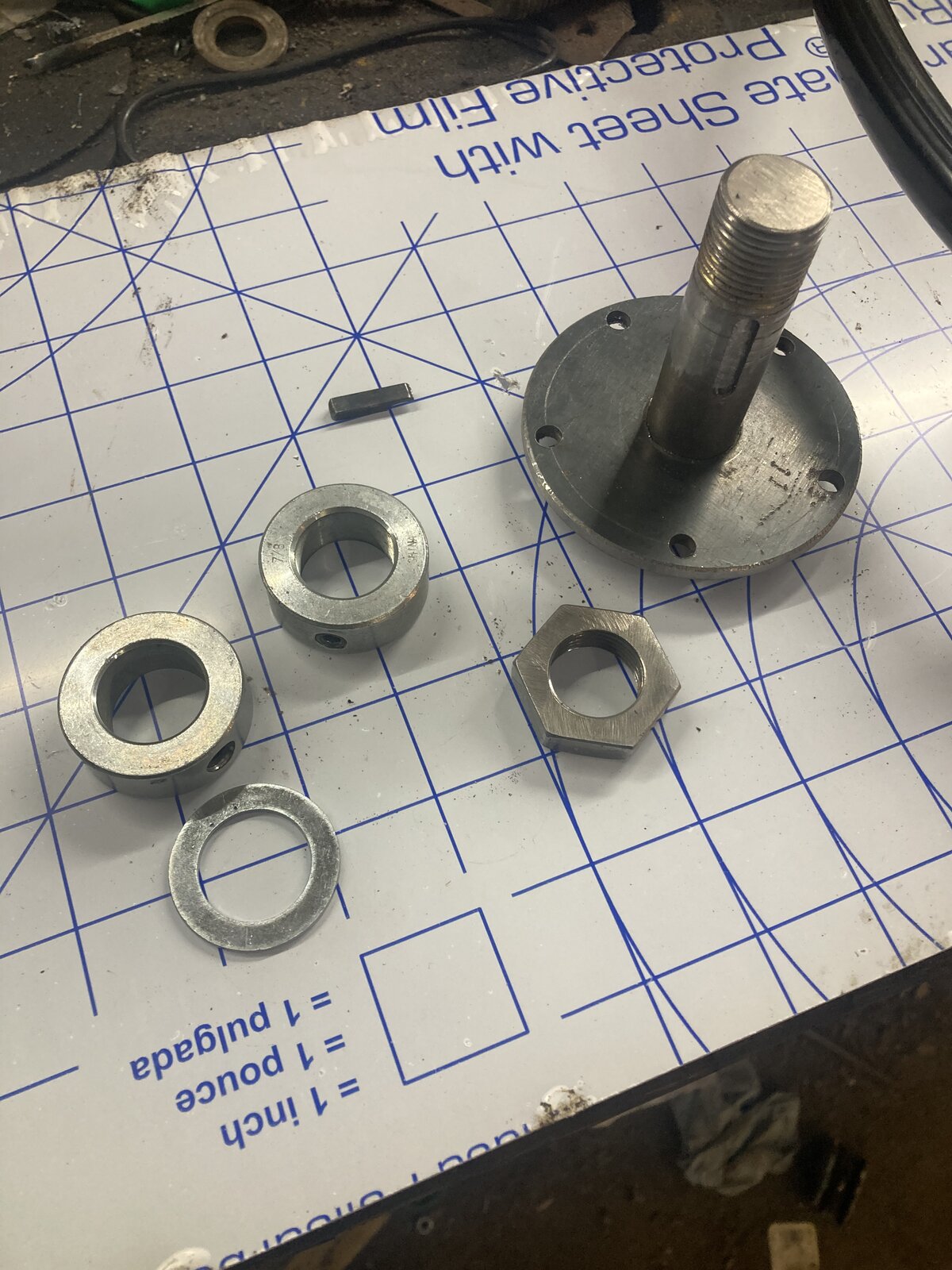

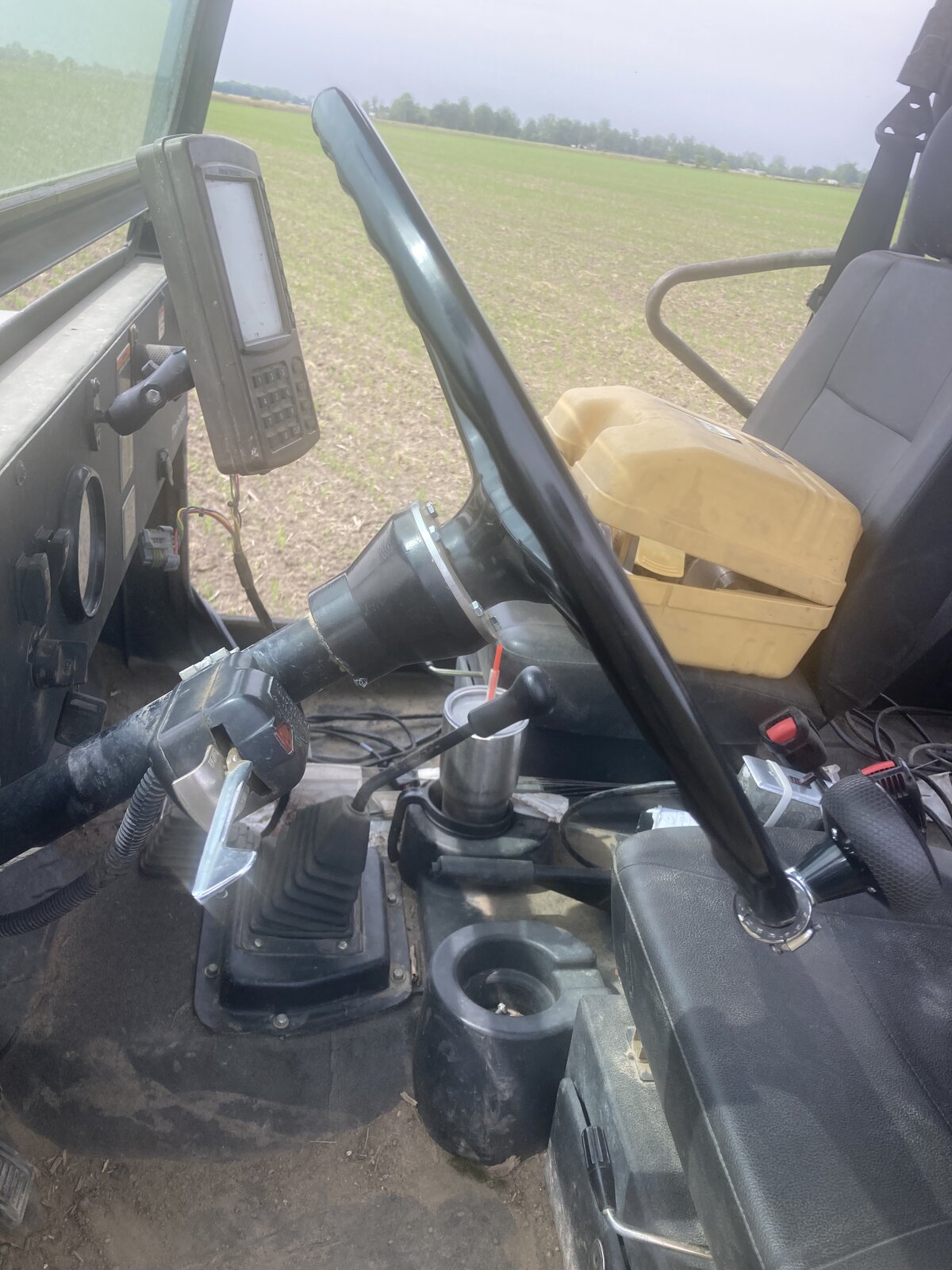

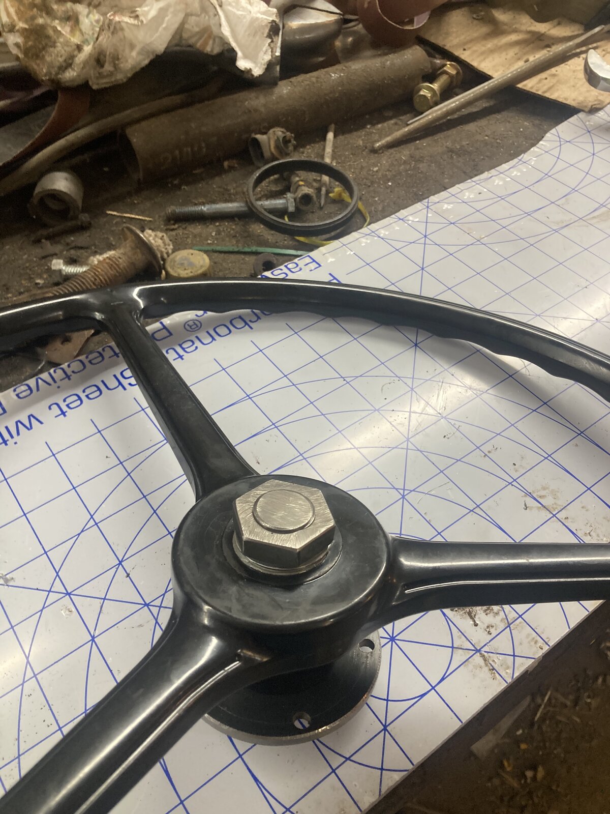

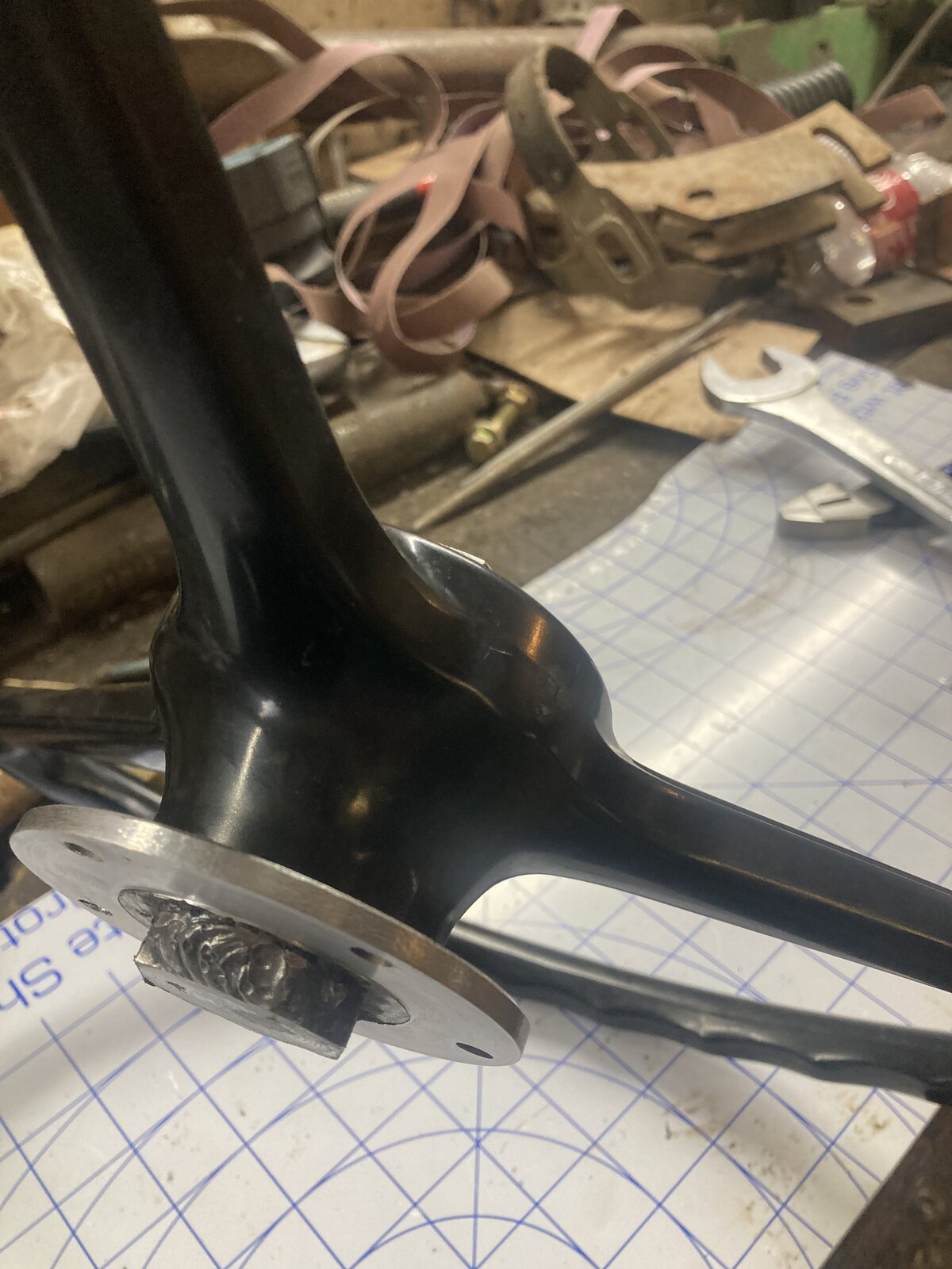

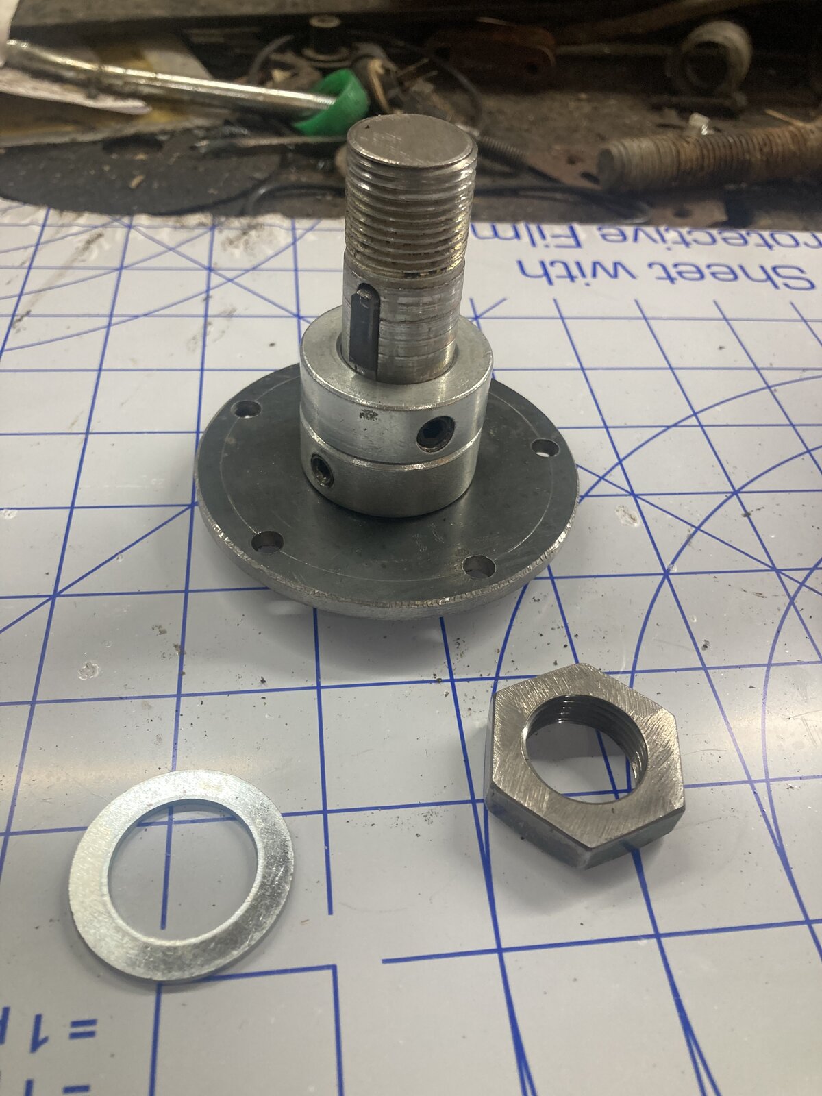

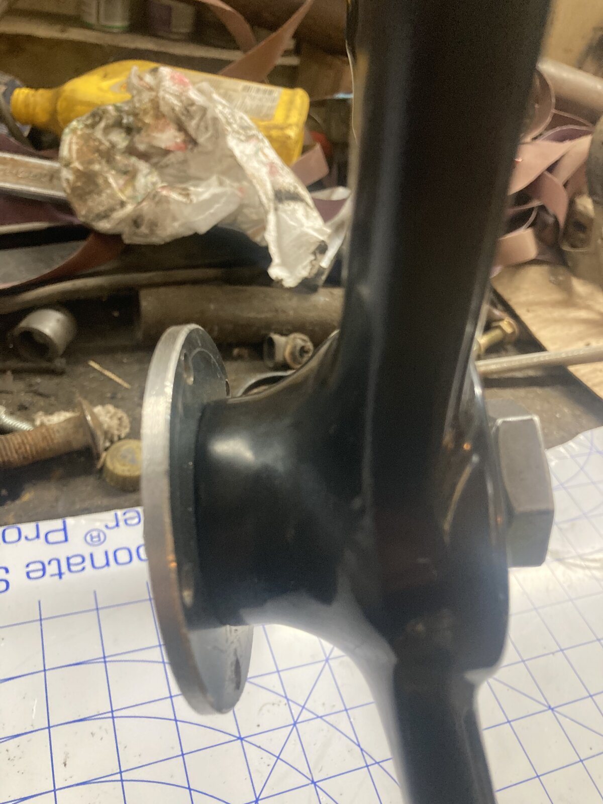

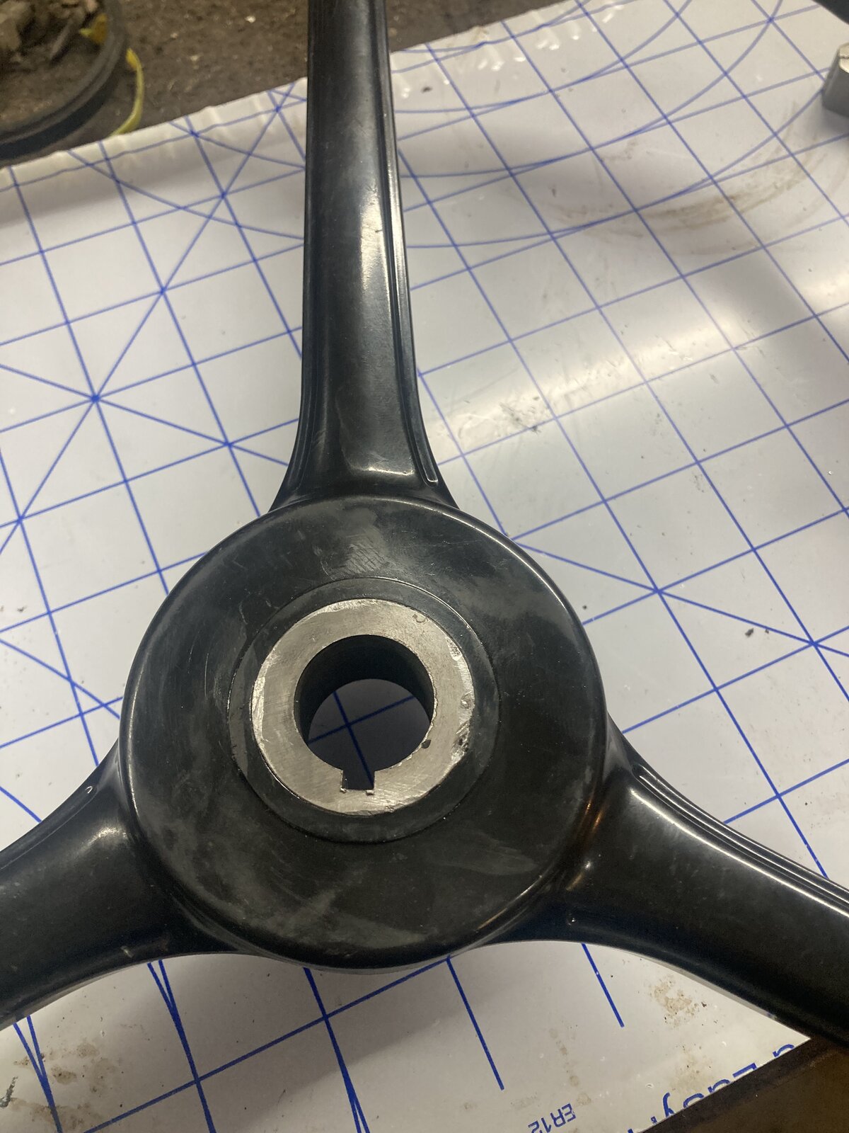

Shaft is 11/16 - 40 splines. Couldn’t find a steering wheel like that so I used the factory adapter and a part I built to bolt a willy
steering wheel on. Drilled the wheel to 7/8 inch and keyed it to a bolt welded to a 1/4 inch flat using set collars to square bolt. B8BA9B58-AA65-4119-908B-28DFCC50D847.jpegE756DCE0-D245-4D1B-B901-C336559B8F8E.jpegE33AE32D-20AA-4546-8395-6F13DB703E91.jpegB23D12C8-D0A0-4EF5-80F1-09964BE8F500.jpeg3FCB6A72-37E9-4E3E-82FB-6FEFD73364F5.jpeg5AA70B60-C9FF-4377-B0F1-D92ABE26EE5B.jpeg822981C0-7BD8-4EBD-A098-B5AD2FA7049C.jpeg4E550BED-A3B2-44E5-8FAE-F02F1E90A05B.jpegE3075B73-F5BB-4BA9-B757-893FEE713DCD.jpeg

The Retro conversion is very good !

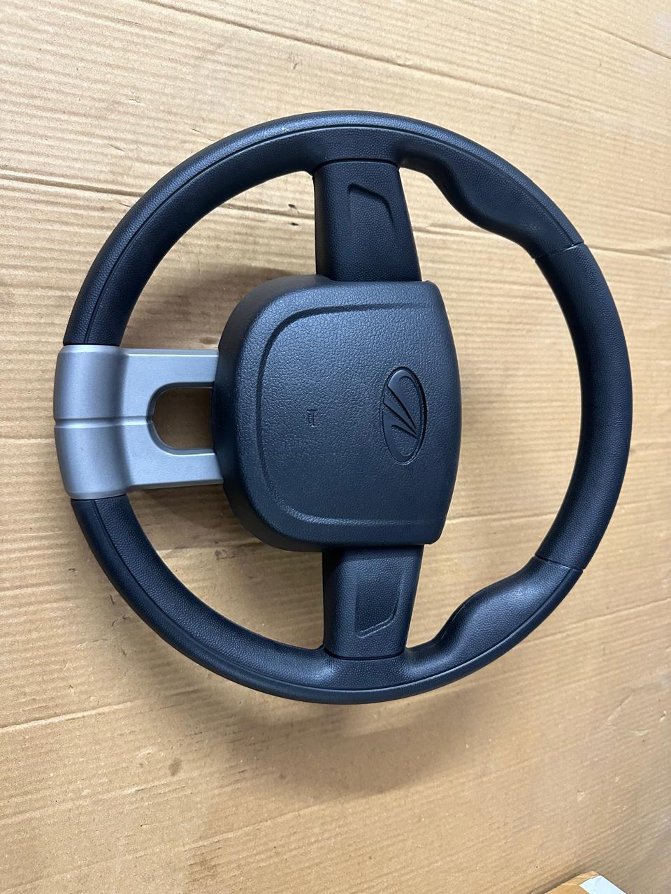

Another Mahindra OEM Option is also available
steering wheel on. Drilled the wheel to 7/8 inch and keyed it to a bolt welded to a 1/4 inch flat using set collars to square bolt. View attachment 13582View attachment 13583View attachment 13584View attachment 13585View attachment 13586View attachment 13587View attachment 13588View attachment 13589View attachment 13590
where can I buy this steering wheel? Is this all metal? I am looking for the same configuration
I am going to make the same modification as you, thank you for this insightful post. How many hours was the project time? was it hard to do?
