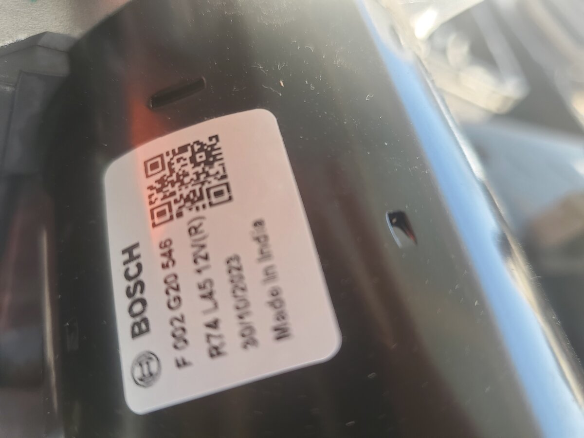

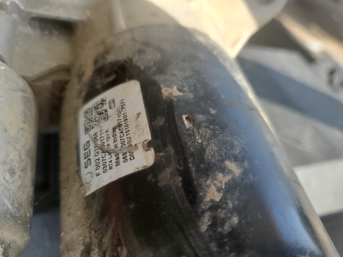

I had to replace my starter this week . I had trouble with it last year, but it started doing ok then, so had ordered one anyway and had it on the shelf. The one I just put on was around 180 off of ebay. The ad for it said it was an upgrade. It spins fast and I'm pleased .
The numbers were a little different .
