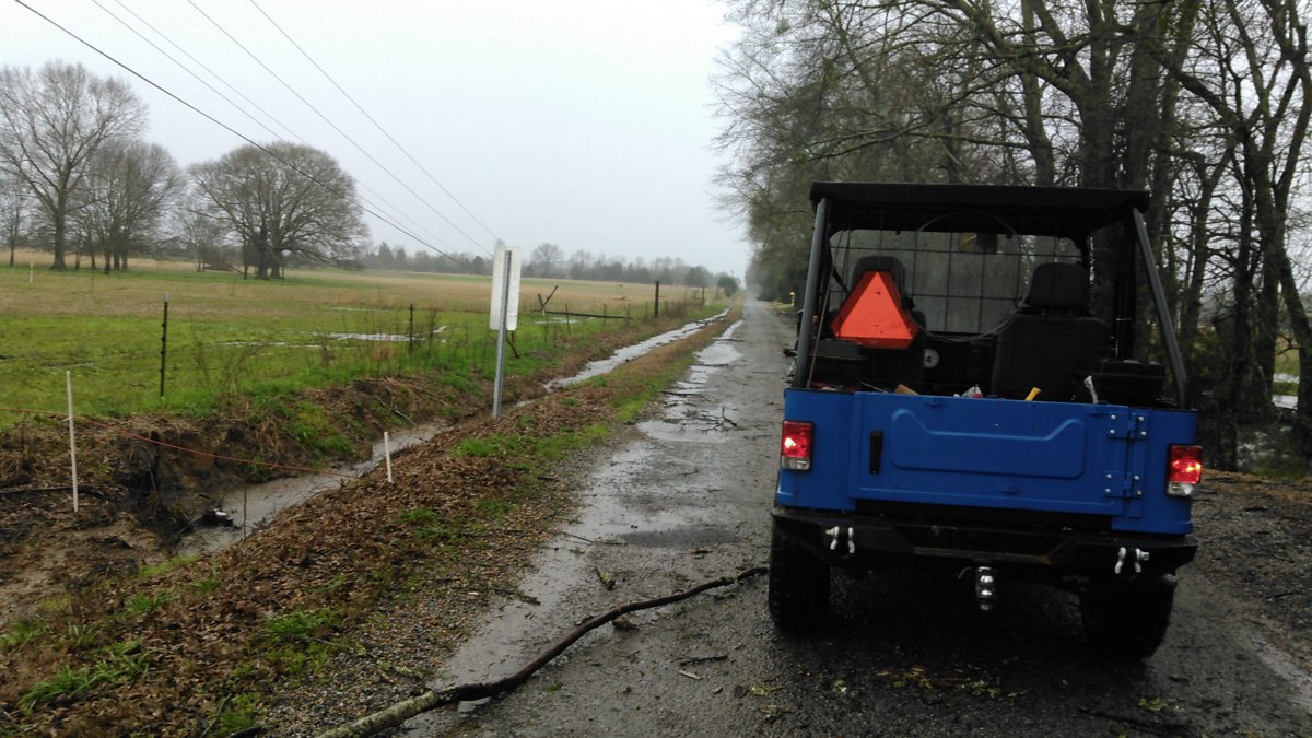

My starter just started making a noise occasionally , last week. It sounds like when you try to start a gas model that is already running - Like the bendex is spinning or not engaging ? Then it will start fine. Will be keeping an eye out. My warranty is supposed to be for 3 years but need to find my paperwork as I'm coming up on my one year anniversary . Do you have to take your machine in or will the dealer just let you pick up the part and exchange when it finally goes out? I can't wait in line for service for week(s) .
It's rained a lot here but I've not been in any creeks just splashed thru ditches for a few seconds.
