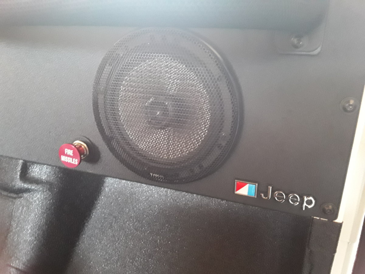

Yes most of my roxor is heavy duty BUT the only dash gauge sure looked cheap from the backside compared the multigauge I'm used to in the boating world. Will use silicone added to the nut ring on the back just to keep the gauge on place.
Are u able to take out the peg on the back that limits the speedo to 62? My 12volt plug is worse as anything falls out. Had to use electrical tape just to fire the missiles.
