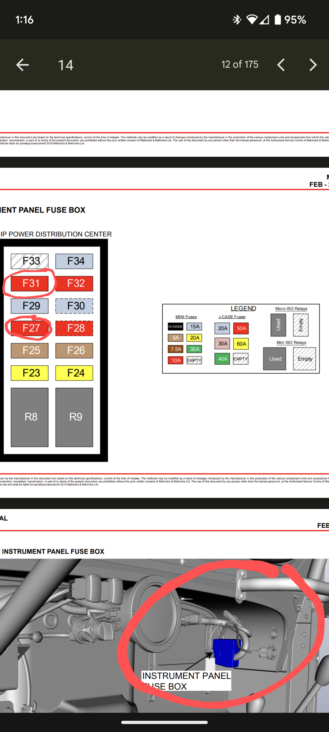

Thank you! That sounds terrific. I just bought this and it has a few issues I am trying to sort out. There are potentially some other electrical things going on (the heater and A/C don't work and a few other things on the dash). Haven't had time to trouble shoot yet but wonder if I need to figure that out before I send you the unit in case it is a bigger issue. Don't know if you have thoughts on that or are willing to discuss. Maybe there is a way to isolate the gauge issue. Thoughts?

I usually just have people check the following fuses before they send it. It they are good, just send me a private message and I'll walk you through the rest.
