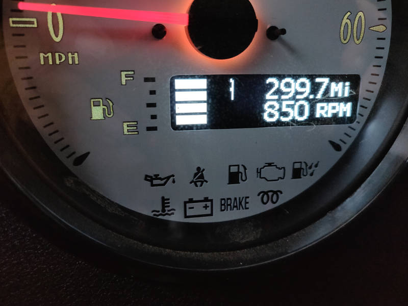

I had to have my speedometer unit replaced under warranty. The problem with mine was in the odometer display area. When it first powered up, where it begins by saying "MAHINDRA", when this disappeared and the odometer reading displayed, a portion of the "MAHINDRA" would remain displayed. It didn't do this on every start. My guess is that it is a timing issue in the programming of the unit, but it is also possible it was an issue with a chip on the board.
The odometer and hours are stored in the ECM, so this is not lost when the speedometer is replaced.

I suspect this might end up being an issue with many of the 2018 models. In the photo, notice how part of the "A" in MAHINDRA is still displayed. Sometimes, more of the name would remain such as "MAH". If it is a software issue like I suspect it is, the problem could be solved by the dealers if they had the ability to upgrade the firmware in the speedometer head. As it is, the dealer had to pull the speedometer and send it to Mahindra and Mahindra either sent a new unit back or the original updated one, I don't know which. In either case, Mahindra and the dealer were very quick about doing this. I dropped off the Roxor on Sunday and got it back the following Saturday. That included pulling the speedo and reinstalling as well as shipping in both directions.

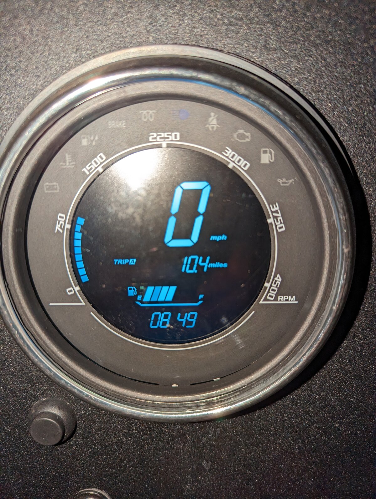

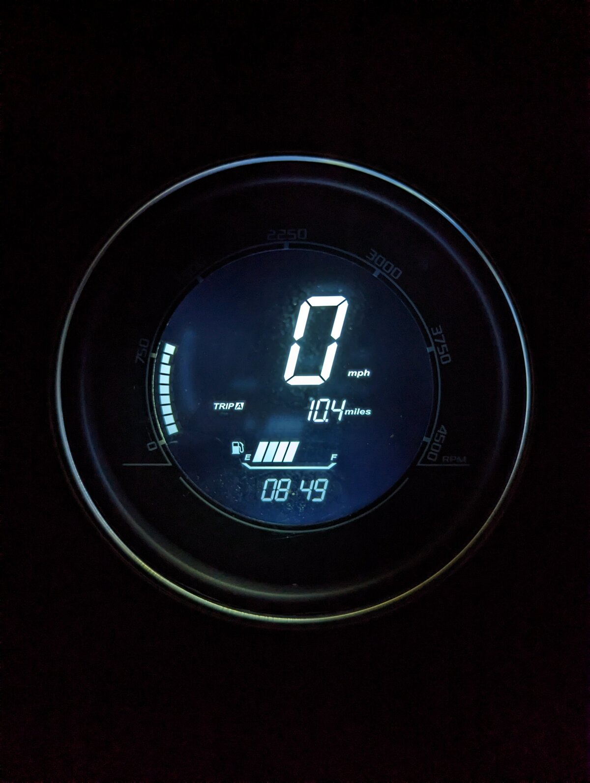

Does anyone have the pinouts for the speedo I need positive, negative, Ign.
also what are the VMAC and ENAB on the board?

where do you get this speedometer from? also can you take a picture of the back so I can see the wiring?
This speedometer is a factory installation in the 2022 models.......digital. It works and I'm not going to fiddle with it to get a pic from the back....sorry.
GnadenAce
Jan 14, 2023
24
Gnadenhutten, Ohio 44629
I understand it only comes on the enclosed cab models in 2022. Open models still come with the old style speedo.
