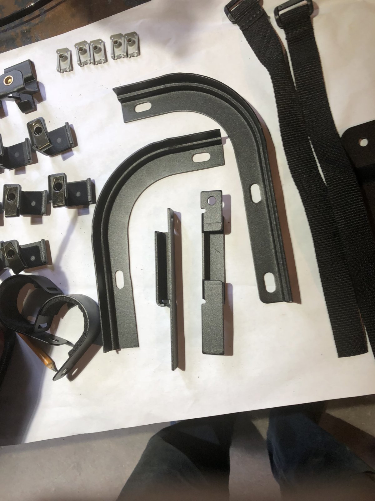

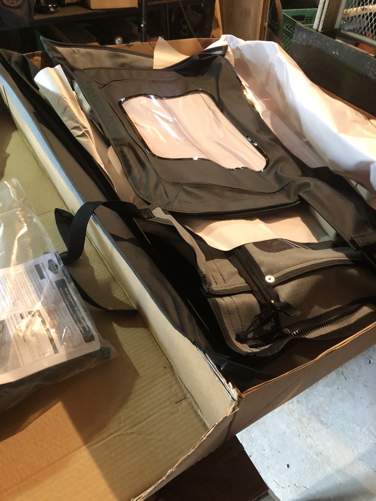

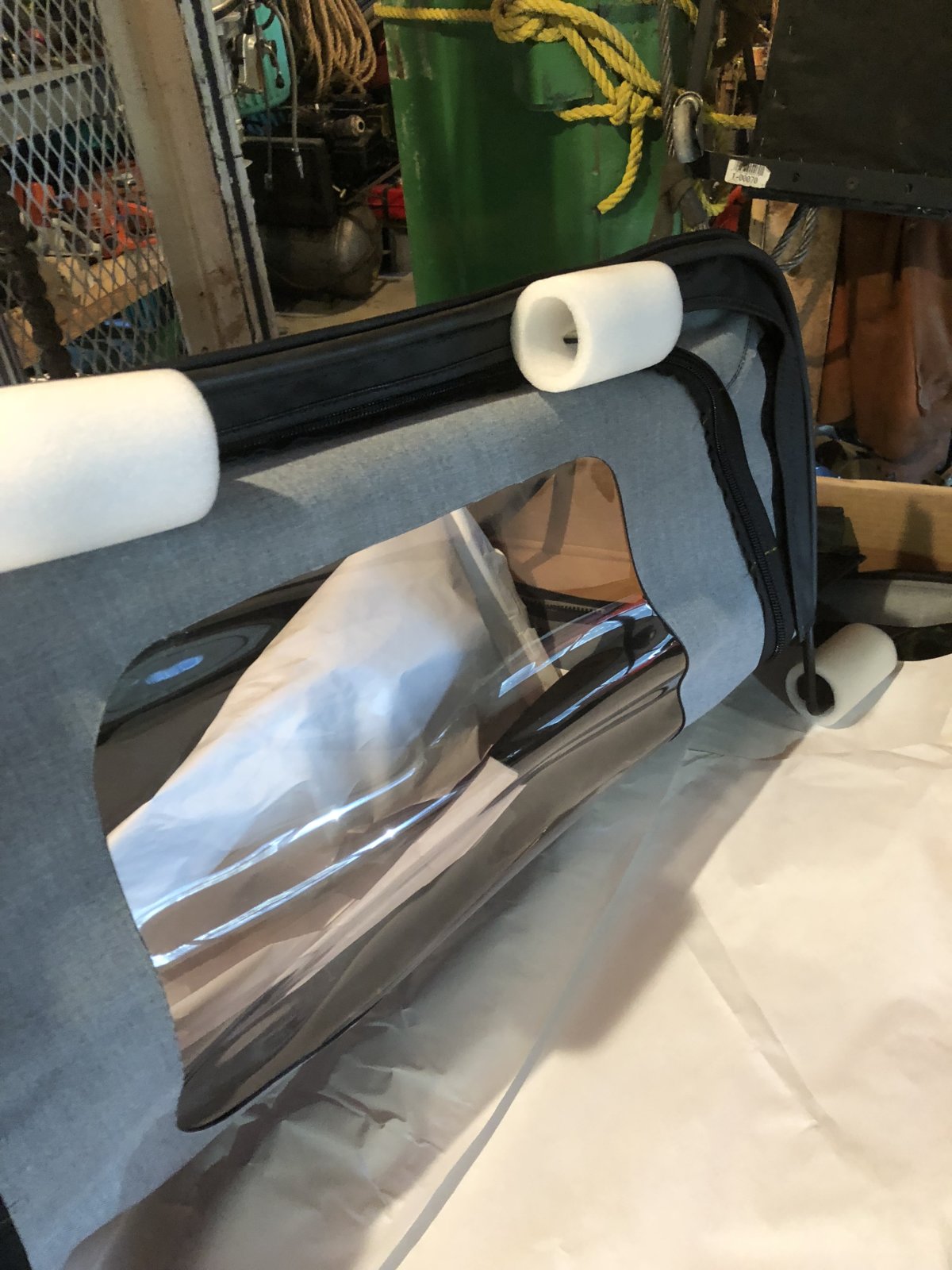

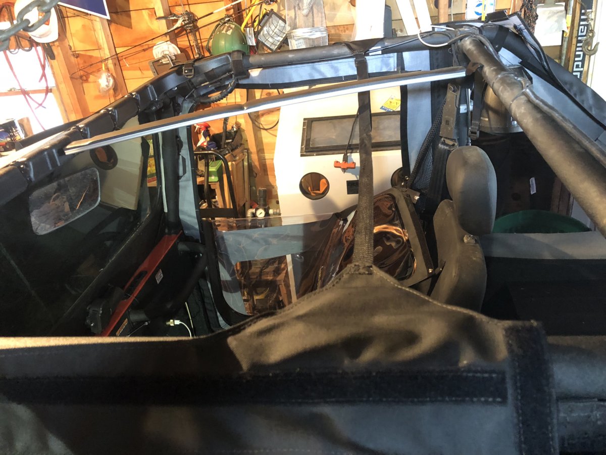

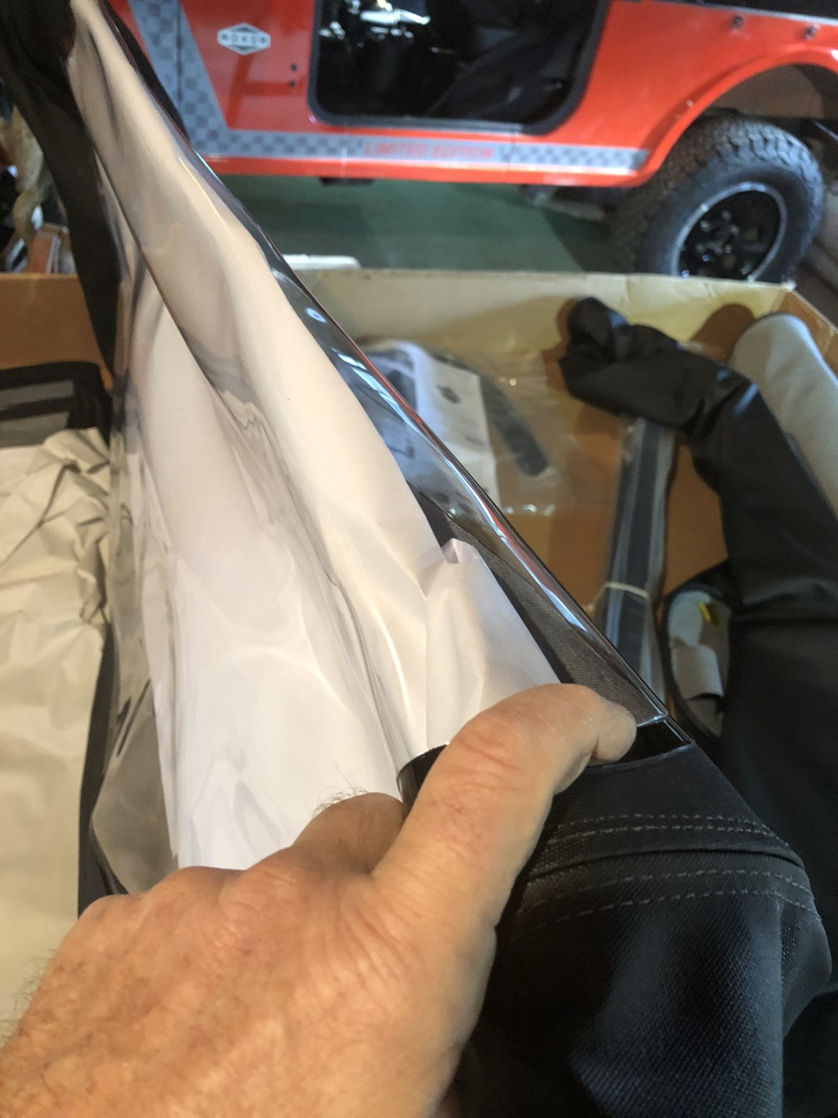

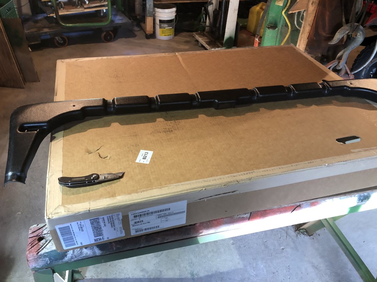

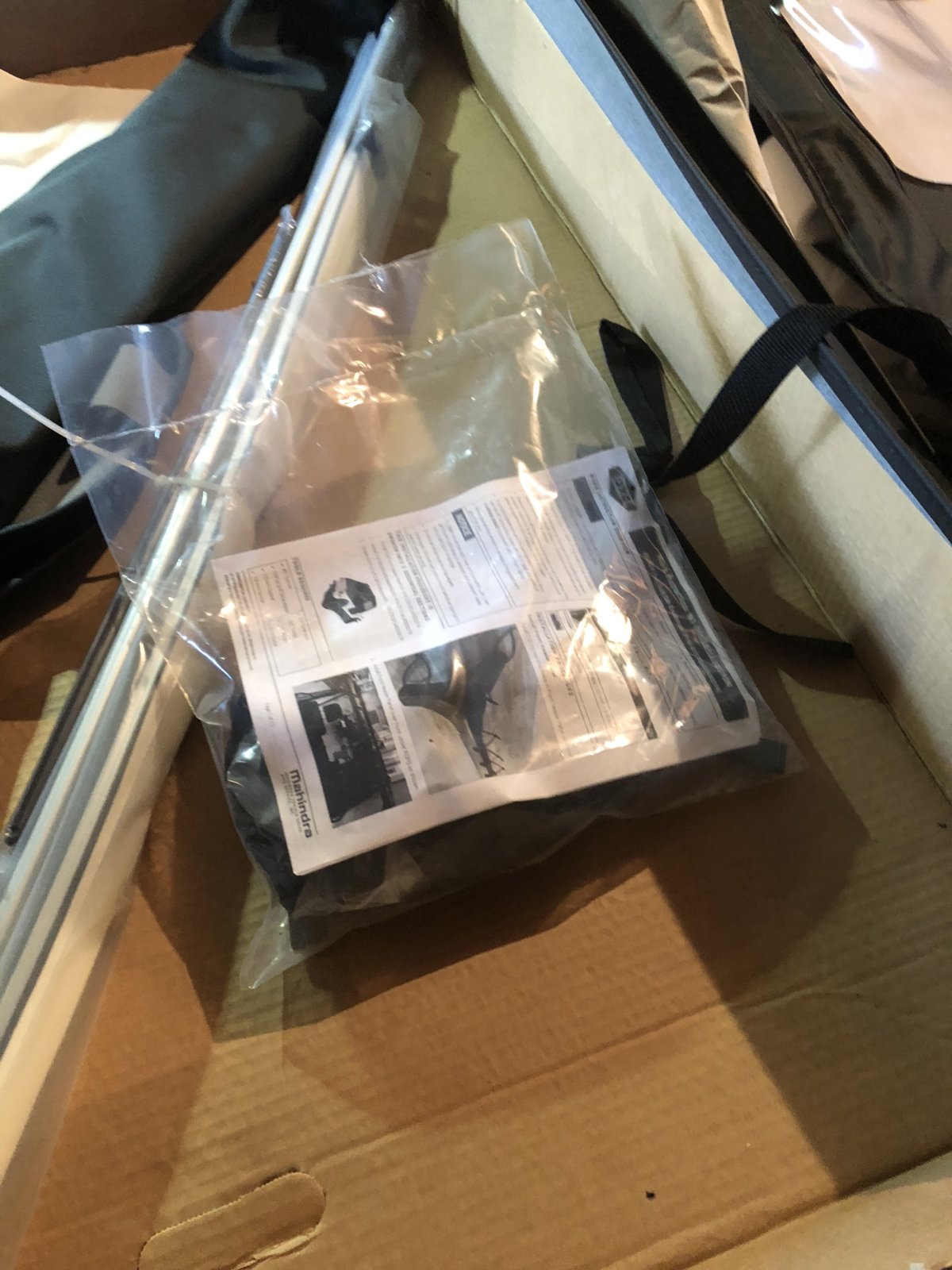

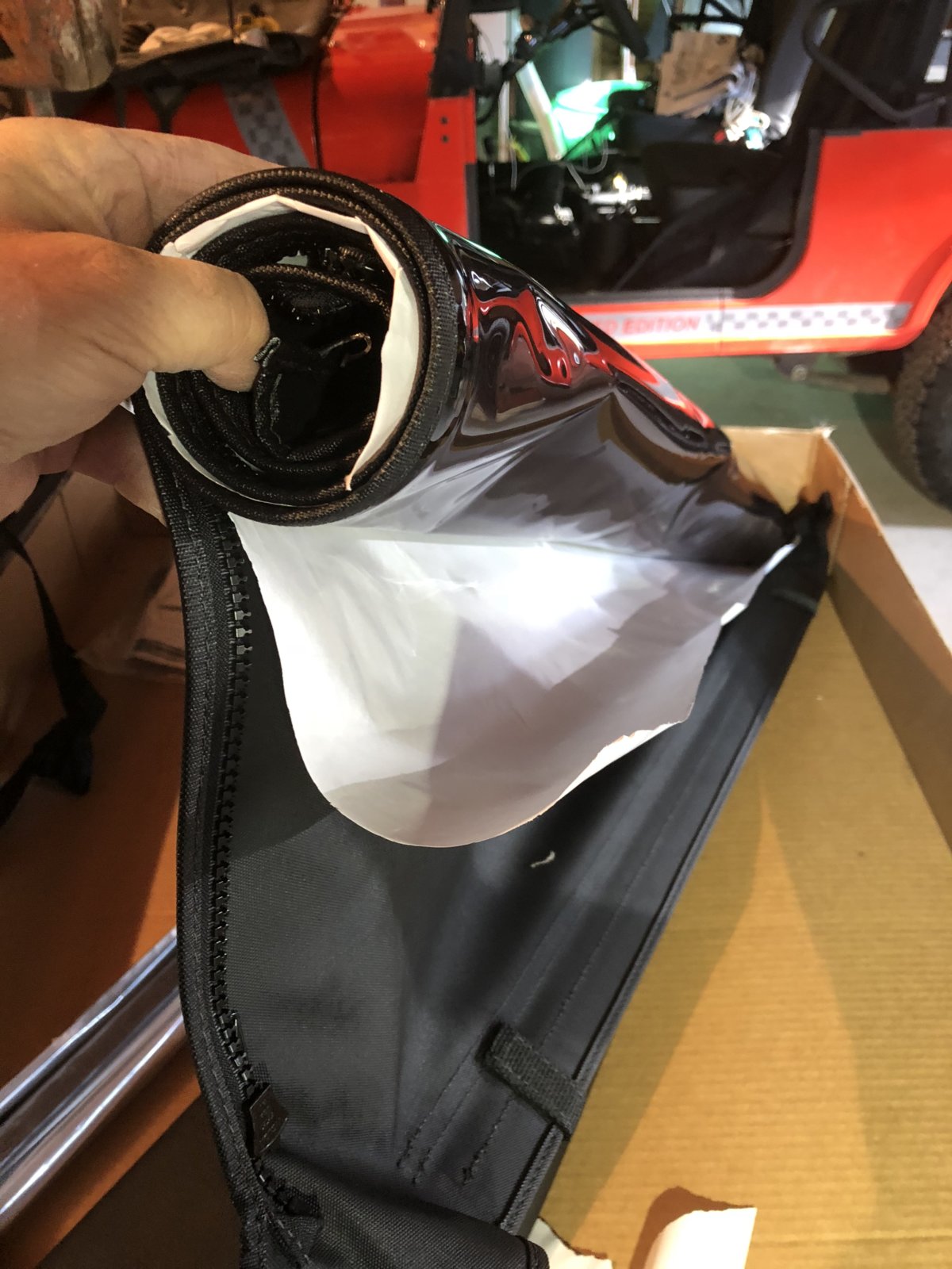

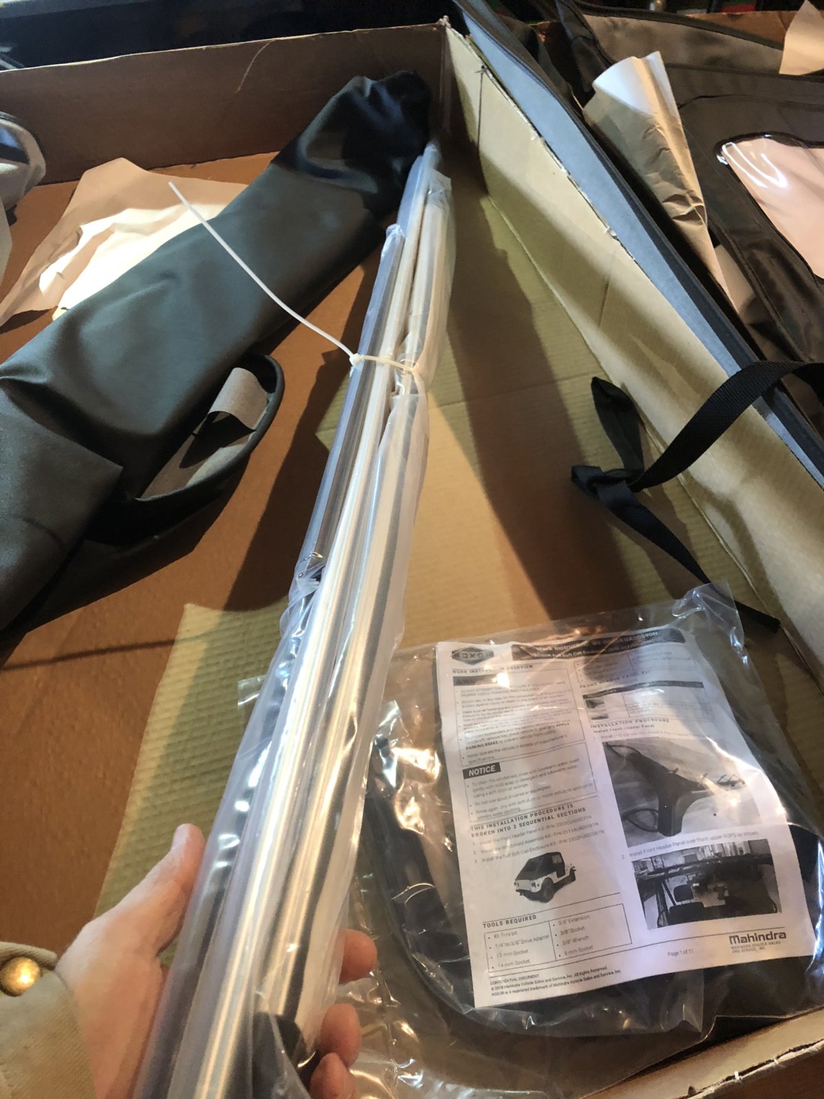

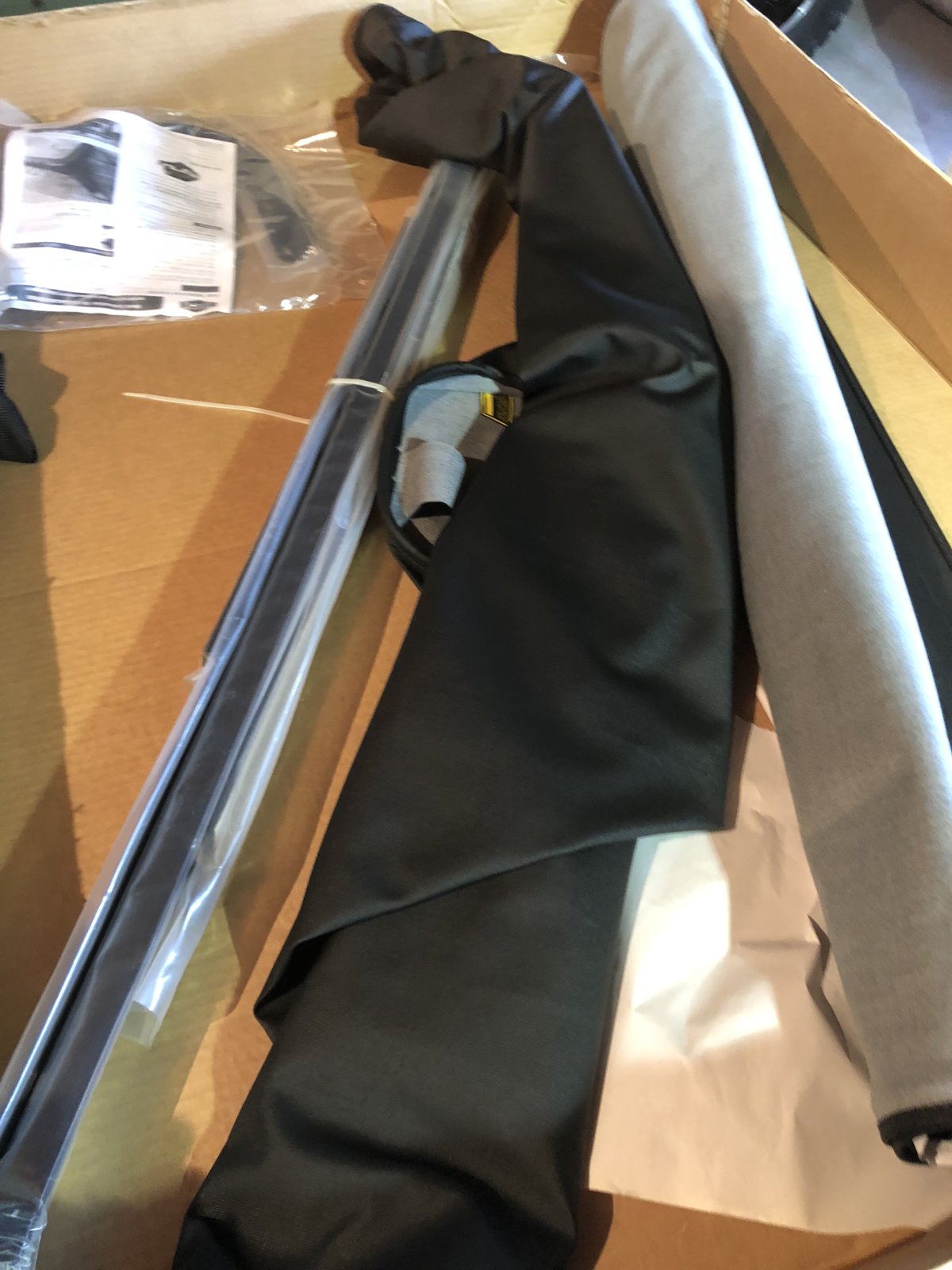

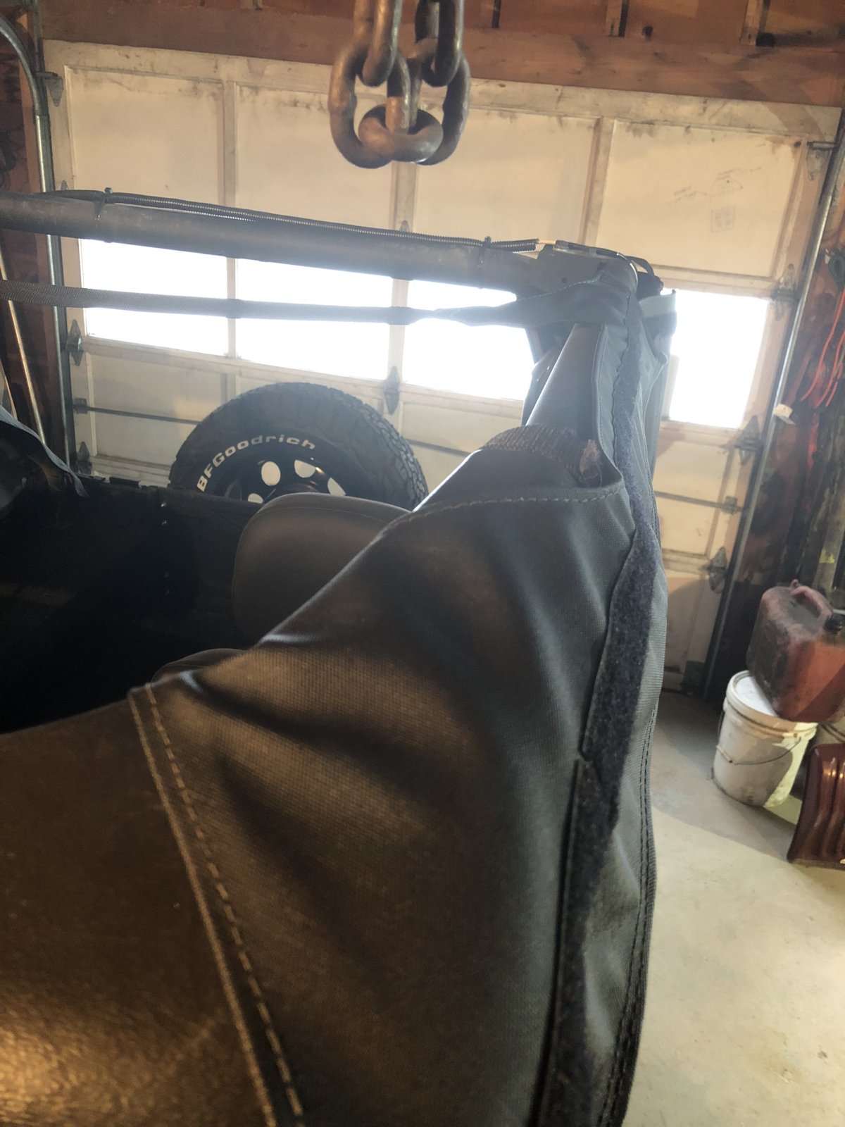

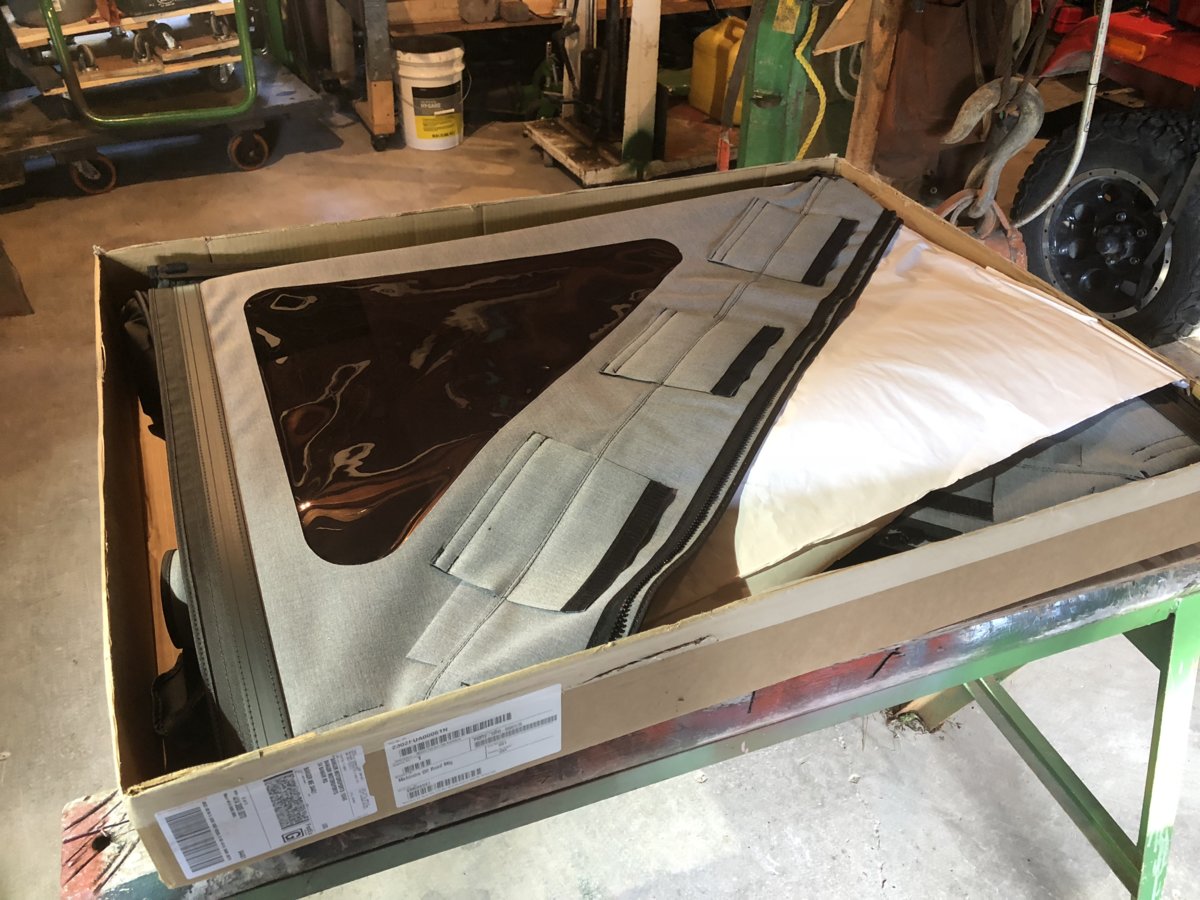

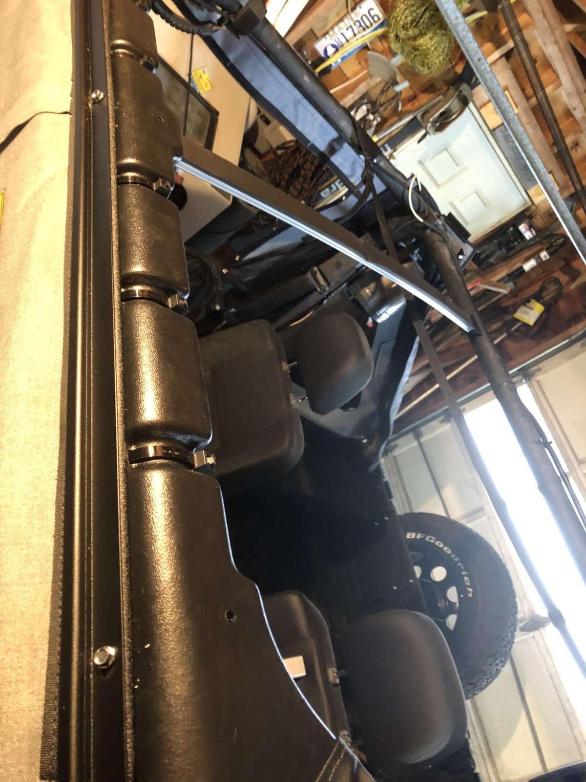

Picked up my Bestop top 11/14 worked on installation this afternoon. I have the ontherox windshield. The Bestop top is going to be fine with this windshield but don’t expect the top holes to be the same. I just drilled new holes.
Also added a center bolt SDST into the roll bar since I was 1 mount short. (File down the top threads to prevent early lockup.)
Bestop could do a little better when preparing directions. I added self tapping, self drilling screws to mount windshield channel brackets. Leave screws loose until you slide the top deck assembly in place then tighten before you fold the top up in place. I also wet the slide areas with WD40 to make things slide a little easier when working alone. Expect to finish up in the AM.
First attempt of any top. I should be much faster with understanding of systems. No rush! Lol
I’ll post comments when I finish. FYI

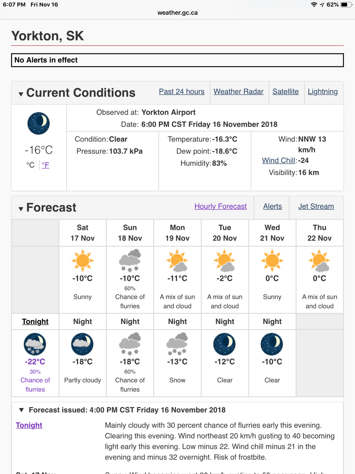

If it was just a filter I needed i would gladly order from Shane. But I’ll attach a picture of our forecast for the next week. Without the other accessories I ordered a month ago, (cab, windshield, hitch), the filter is kind of useless. And right now we have a rotating postal strike going on in Canada, so it’s not just the cold making things slow.
When the dollar exchange was good, we did lots of that border stuff to, but not so much now and I don’t have a passport and 1.5 hours to the border. And no Mahindra tractor dealers even close.
So in closing, probably just going to park it for the winter and use the old Rhino, it has a cab and heater. Maybe I should have waited till spring to buy when everything might have been in place and a faster top speed. I love it, but depressing just seeing it sit.
