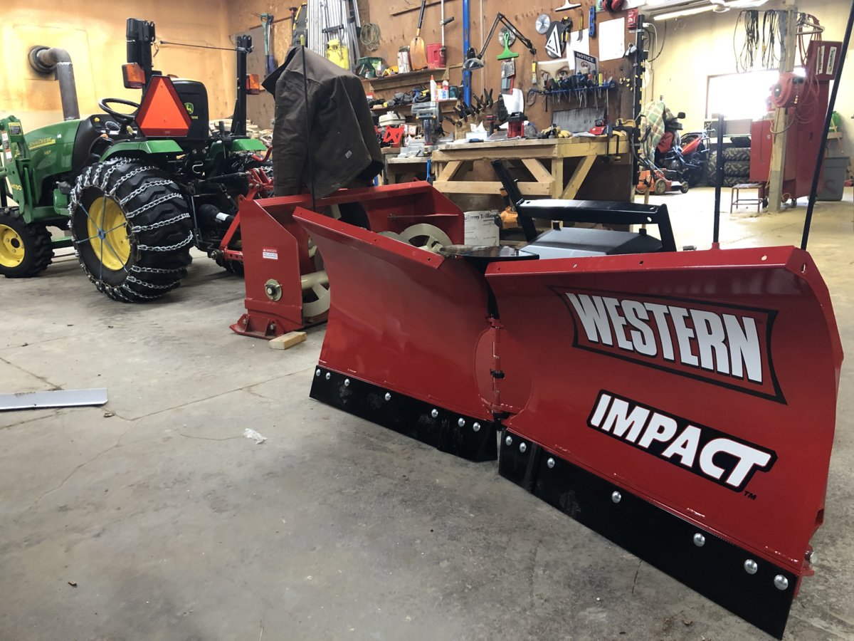

Yeah, I guess western, fisher, snowex and a bunch of other companies are all owned by a company called Douglas Dynamics. Funny enough their NYSE ticker ID is PLOW lol
My snow-ex said built by trynex international out of Madison Heights, Michigan but it was built in 2015.
You’re correct my warranty card is sent to Trynex International and the plow said registered trademark of Douglas Dynamics.

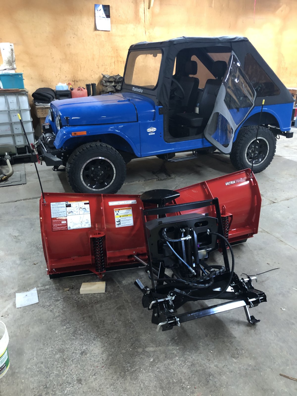

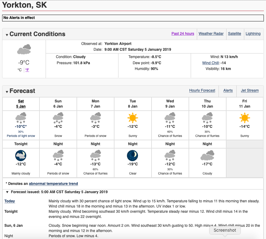

I'm picking mine up tomorrow, then I will be waiting for the mount to come in. Our weather is going to be sunny and around freezing for a few days to a week. So, I think the snow we have will be gone before I can plow it. lol

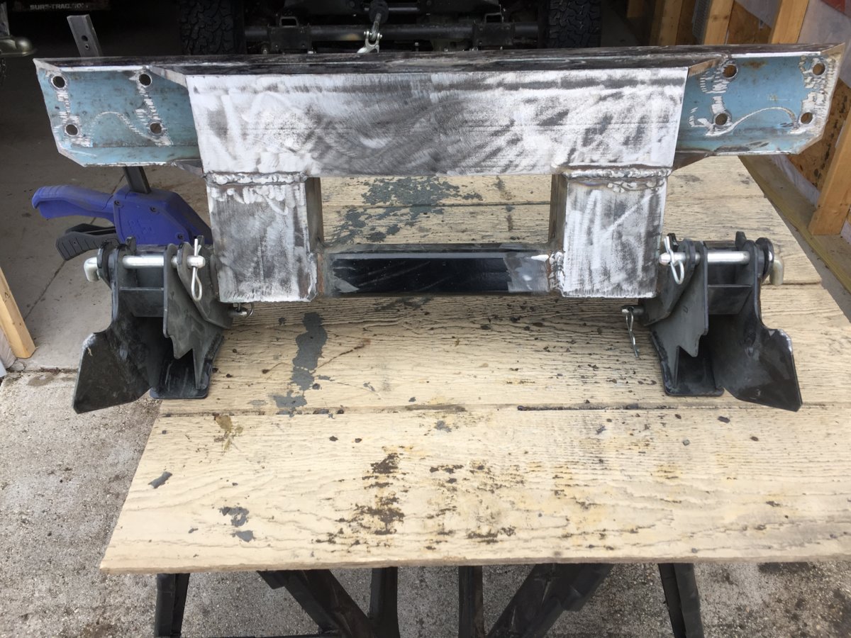

It’s been unseasonably warm here too. 37 degrees today. Almost all our snow is gone. My mount will need a little fine tuning before it’s perfect. I need to add a shim on the bottom so the face is level(or level the vehicle). I also need to raise the plow mounting up two inches.

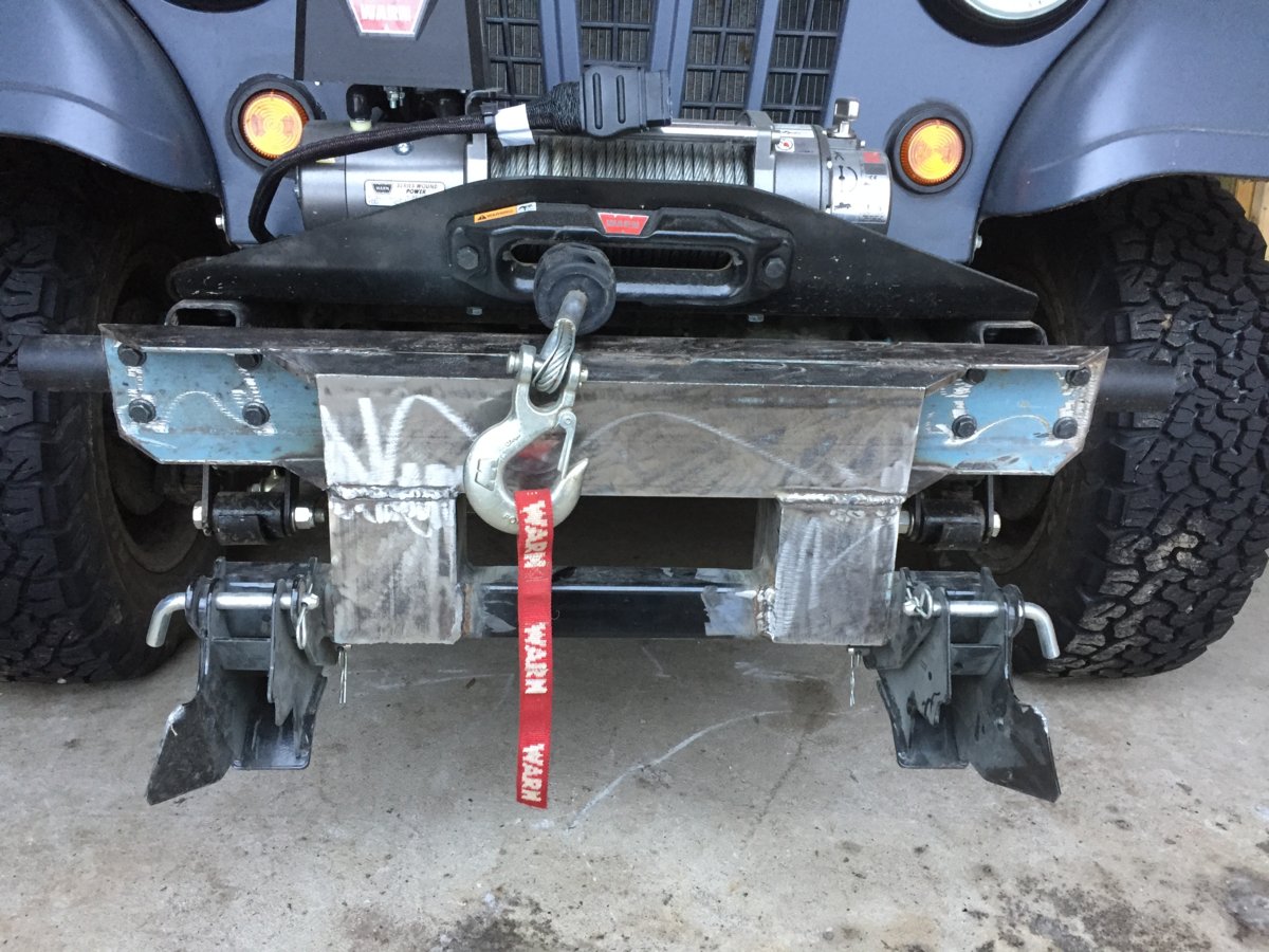

I ended up doing a little fine tuning on my mount today. I raised it up another 3” and cut the lower face at an angle so it was level because the vehicle is not. I think this will be the final height before I box it in,seal weld it and apply paint.

PS: A friend of mine saw my welding and said I'm getting a grinder for Christmas.

My measurement ended up being 11 1/4” from concrete to the bottom of the frame.

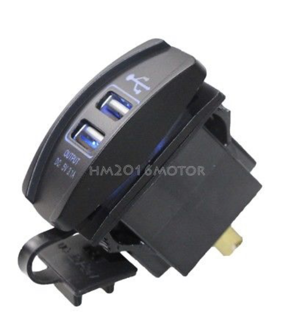

The plow mount is in the building. My plow mount came in this week. I cleaned up the shop a bit yesterday and hope to do the install today and do up a little video. A few weeks ago I installed a low power extra fuse block under the dash that comes on with the key via a relay tied to the 12 volt power point, so that is the place I will tie in the wire needed for the remote. That will speed things up. I use that block for my interior light, a triple power point block, and my under dash sex lights. I'm adding a dash mounted USB power point also, but I think I'm going to wire that live so I can charge phone etc without the key on. I'll also add a live single 12 volt power point.
I might even get to try the plow if the forecast pans out.
