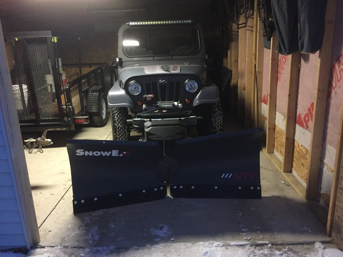

Lookin good! I definitely like the setup (and the windshield - they look sharp paint matched).
I had the 75 out yesterday farting around. It gets the job done, but will definitely feel better with the Roxor all setup. I like plowing with Jeeps so much better than trucks..
I agree on plowing with Jeeps.......I thought they might be too small or light., these new light wt plows make a huge difference........everything seems to revolve around weight these days. I had an easy time plowing Sat. , theRox is better than I thought it would be.

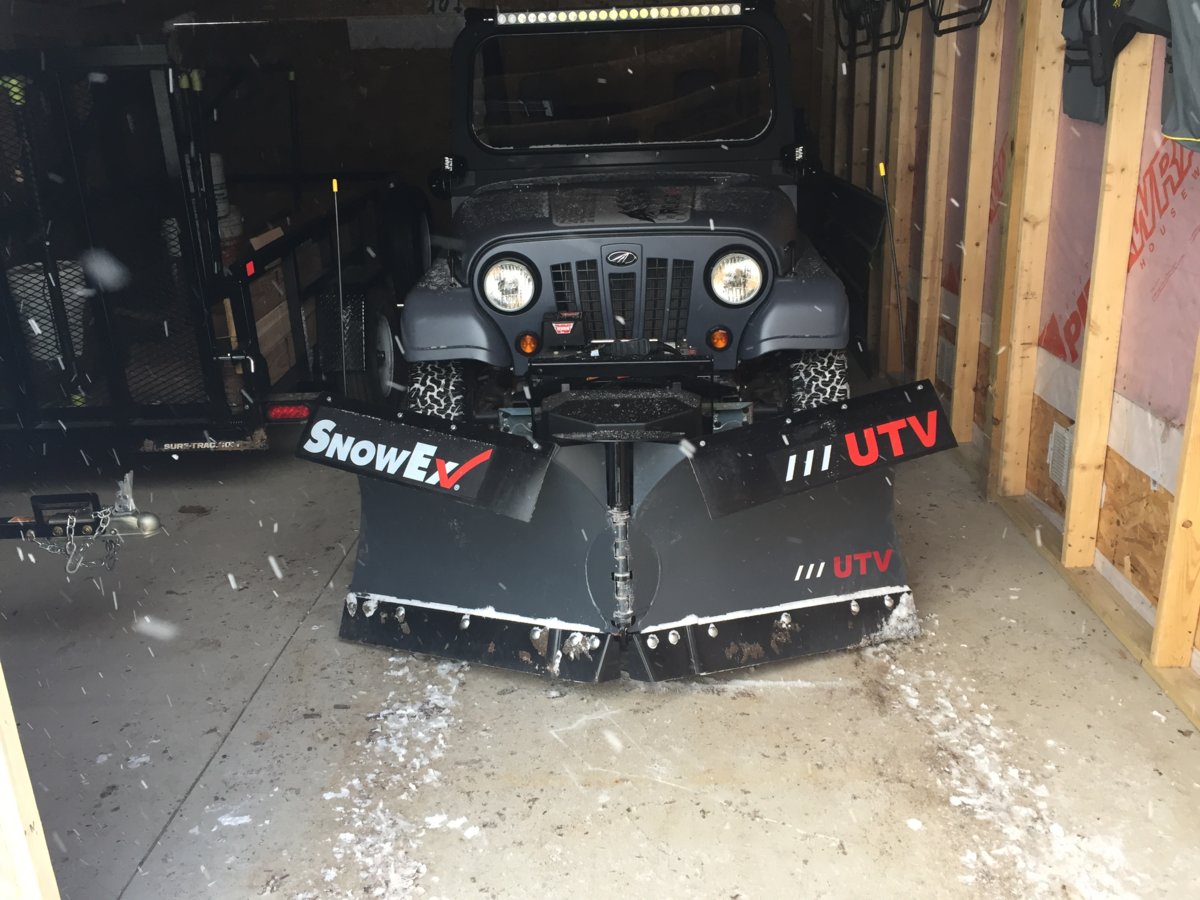

One of the problems in fitting plows is height from the ground. Should not be more or less than 9 to10 in. Removing the bumper was the only easy way to mount the plow , I just bought a 2” trailer hitch receiver ( Reese ) then welded 2 steel plates to the receiver ends. Easy and good, besides Rox looks better with bumper gone.

Made my own mount using the Polaris Ranger one supplied with my plow and some 4” channel. I’ll make it look factory in the summertime. Tomorrow I’ll wire it up and install the rubber deflector and plow shoes.

You get her all wired in and set up?
I wired it up today, my mount is a little low in V mode there’s only an inch of clearance on the ends. I was planning on leveling the front anyway and getting bigger tires so I’ll leave it alone.

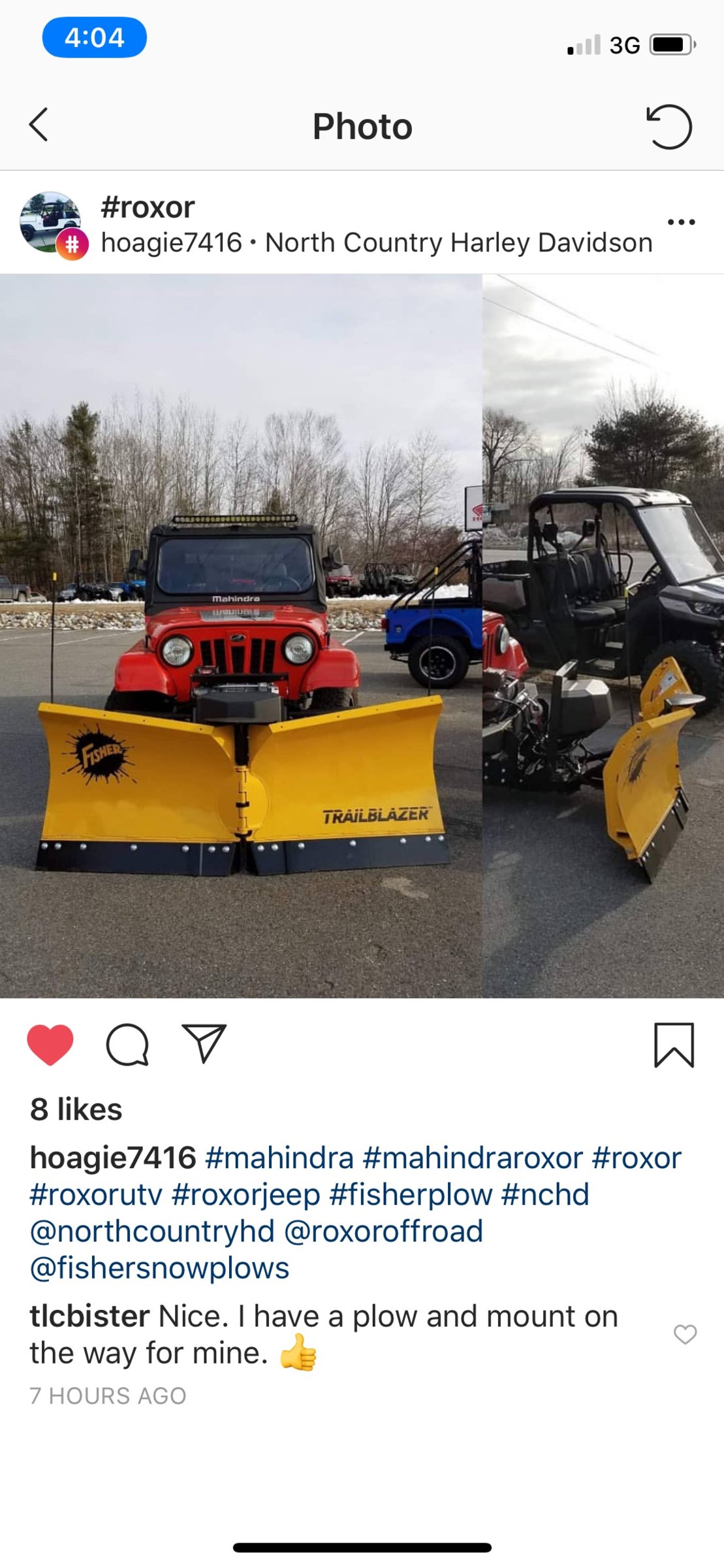

Found this on Instagram today. Mounts must be getting out there.
Looks good and you can even use the factory bumper.
Yep, I asked about that when I saw the picture without it and was told it can go back on. I might just leave mine off when I put the mount on and put the bumper back on when I take the mount off in spring. I have D-rings ordered also, not sure how it will all bolt up. I'm fine with just the mount on for winter. It's main purpose is to keep the road open to the shack and just to get there with the dogs.
