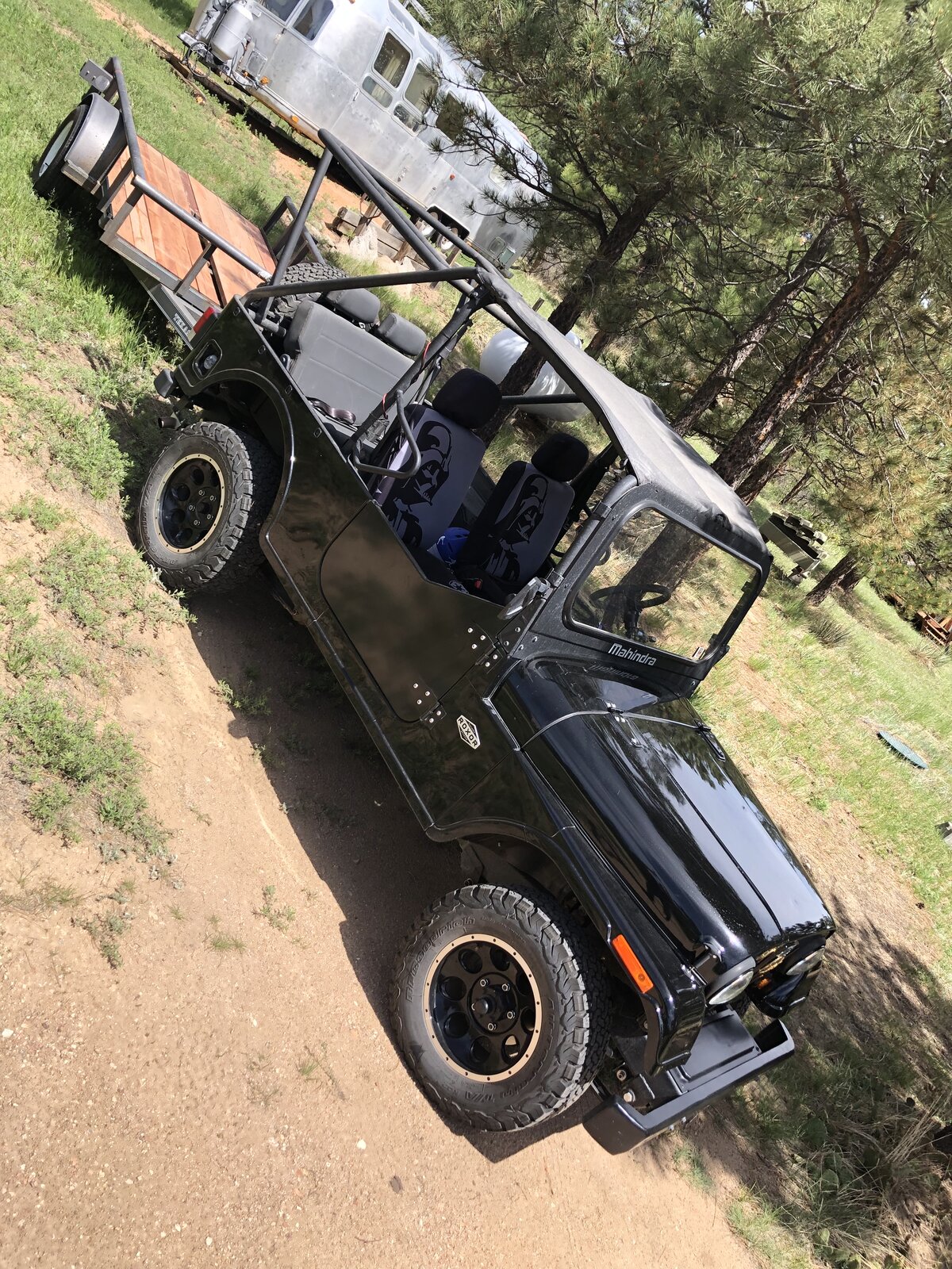

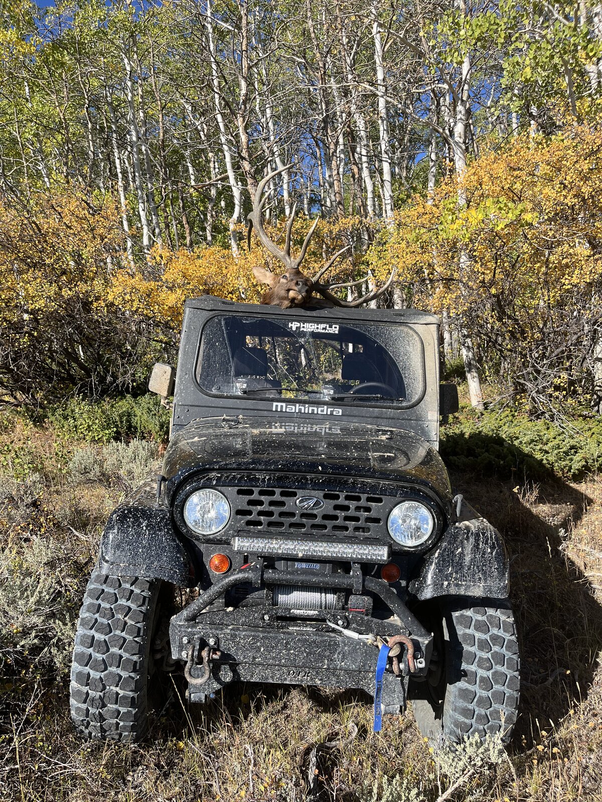

A few mods, and my road ready Roxor rig does it all. Best $16K I ever spent on a vehicle...

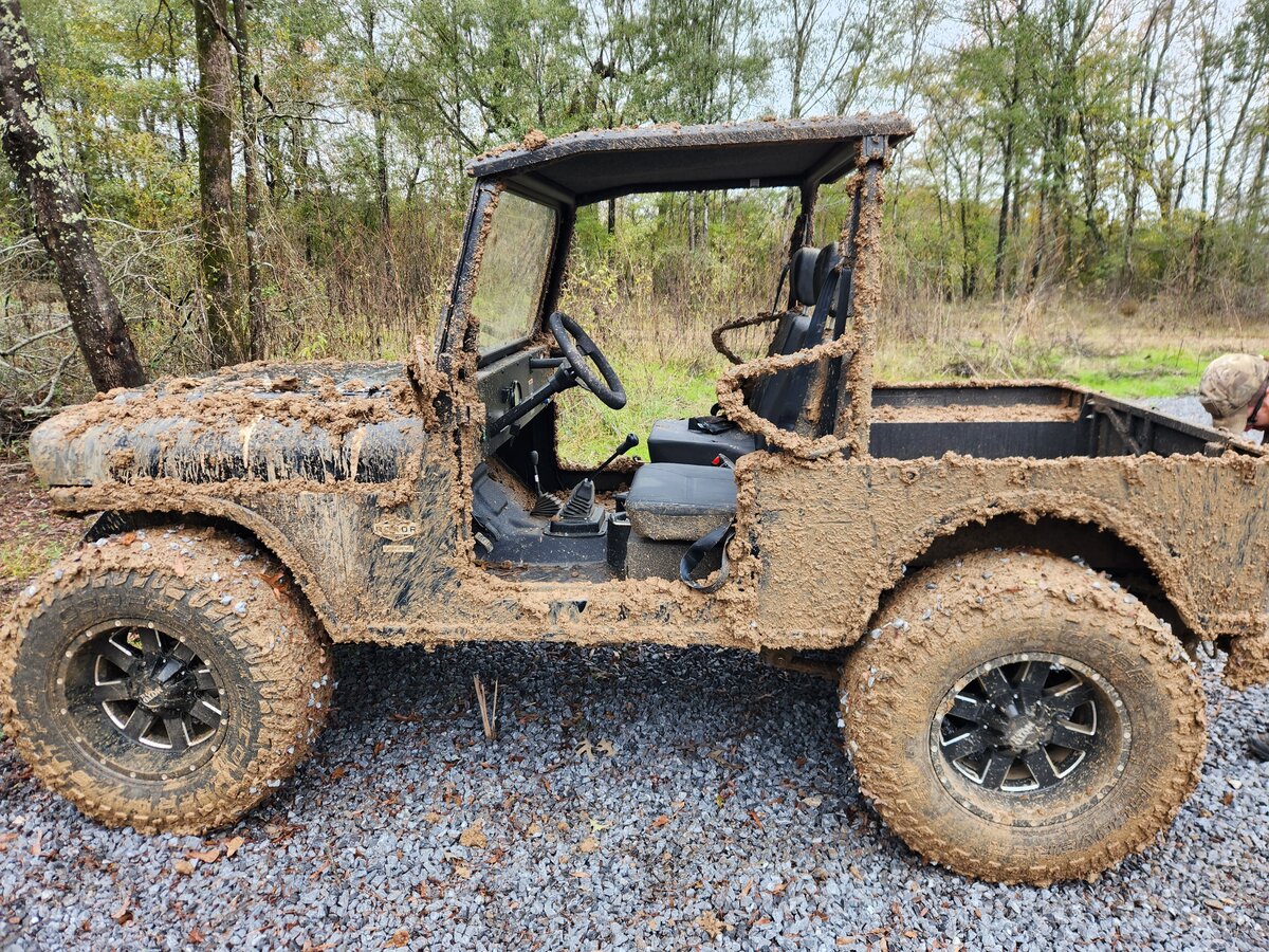

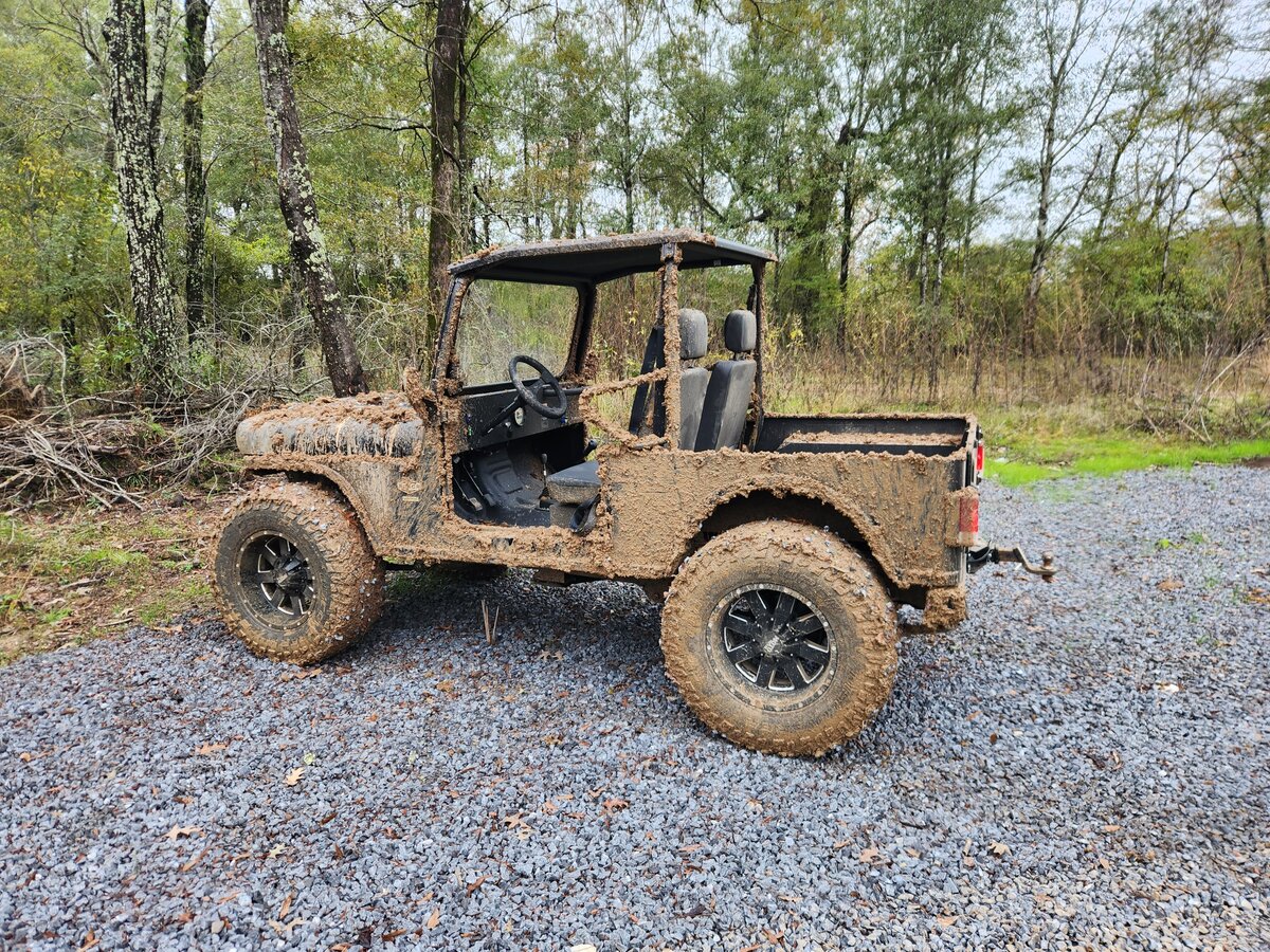

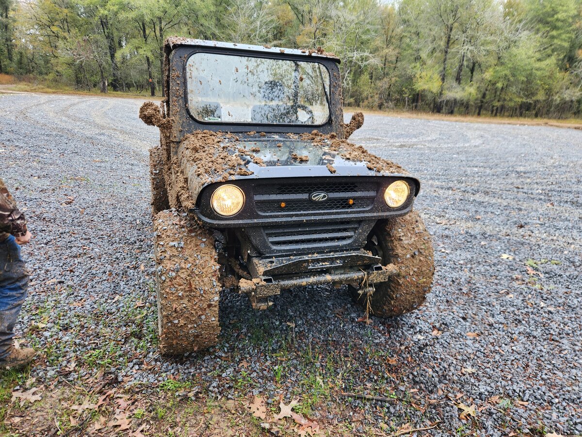

Big tires how's your flex with your body
Flex as in the body and tires rubbing without a lift? Not bad as long as I'm not loaded down with the duck boat and other supplies go down a 4wheeler trail. I ordered the inch and a half lift in hopes of stopping that because I really don't want to lift it much more than that. After the lift if it still rubs I might go with an air bag kit on the rear Axle.

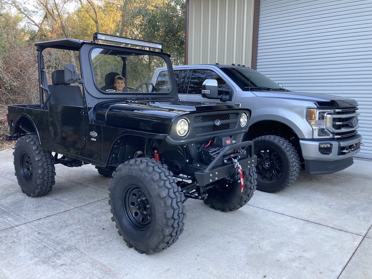

822

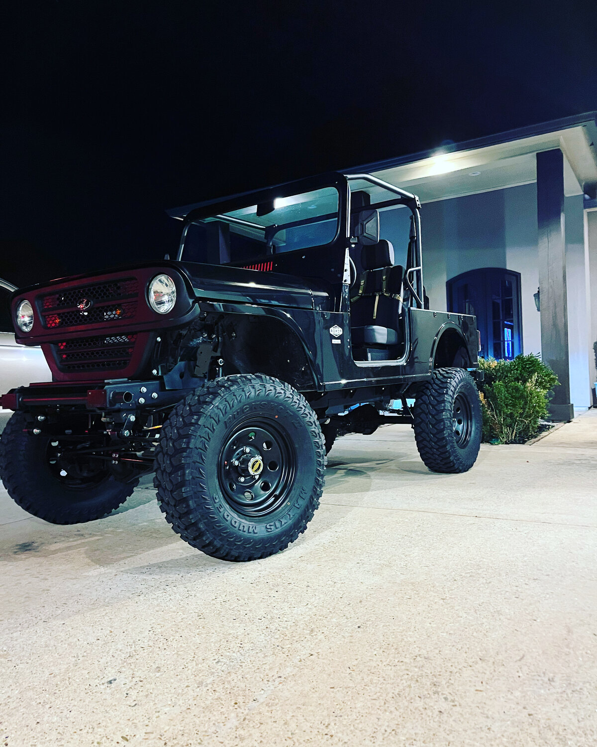

I didn't go as big but when going over bumps the rear bottoms out. Added 1inch longer shackles to fix it. I run 235 8516 with the aftermarket bumper and level kit it hits. Had to cut a bit of bumper off.
With the inch longer shackles did the rear tires move closer to the front of the wheel well or did it move straight down?
822
So the front the did the level kit from RC. With the longer shackles, rear was just longer shackles. No adjustments needed to the axles.
1,288

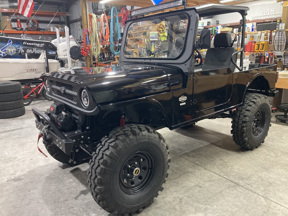

Only way your gonna move that axle forward is with a different spring set up. Climax off-roads kit that uses YJ springs moves the axle forward. There’s extensive write ups here on the kit if you do a search.
I hate to say it but if you intend to do any real wheeling with 35s your gonna need more than a shackle lift to do it correctly. A shackle lift and 31-32s is doable IMO. Disconnect sway bar and your probably gonna rub with that set up. I’m running a shackle lift (climax off-road rear shackles at both ends) an OTR 2.5” front spring level kit and 3” rear lift springs off eBay, and I also ditched my sway bar. I had to extend my bump stops at both ends to prevent rubbing at full flex. I’m on 33s and if my math is right I’m bump stopped enough to run 35s with out rubbing anywhere.
