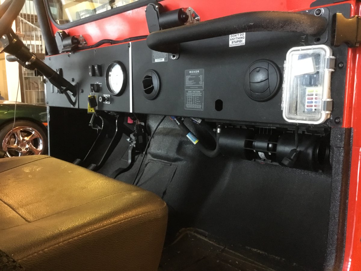

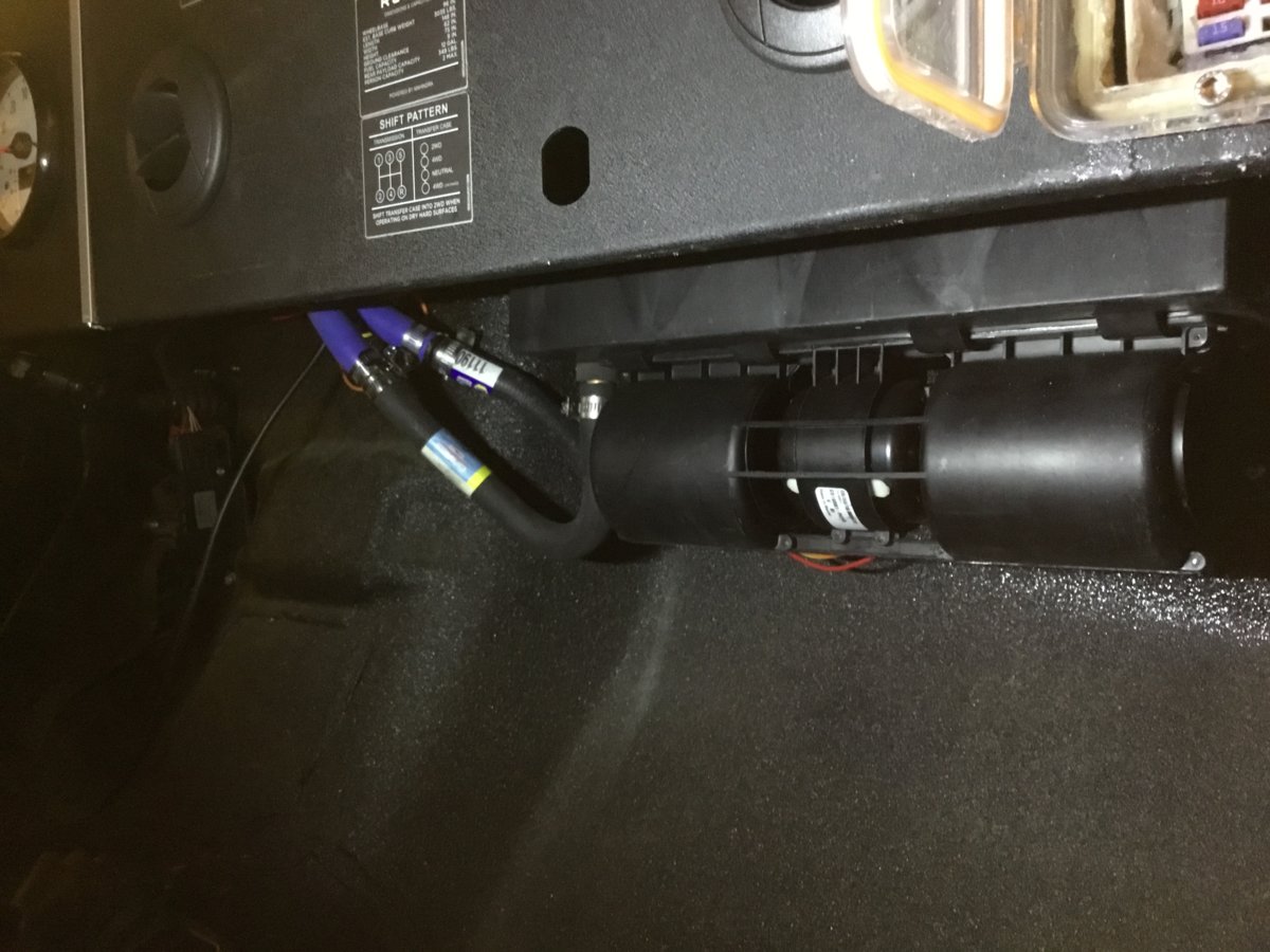

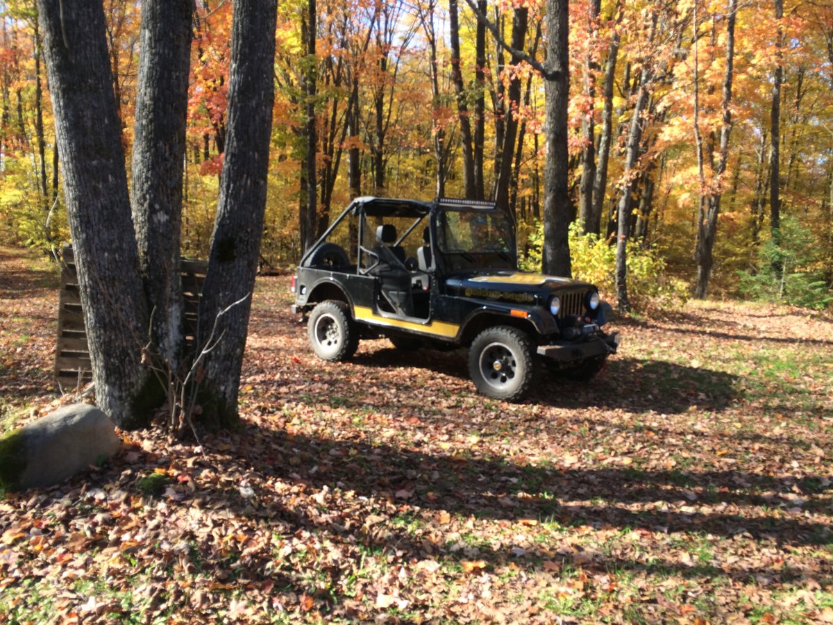

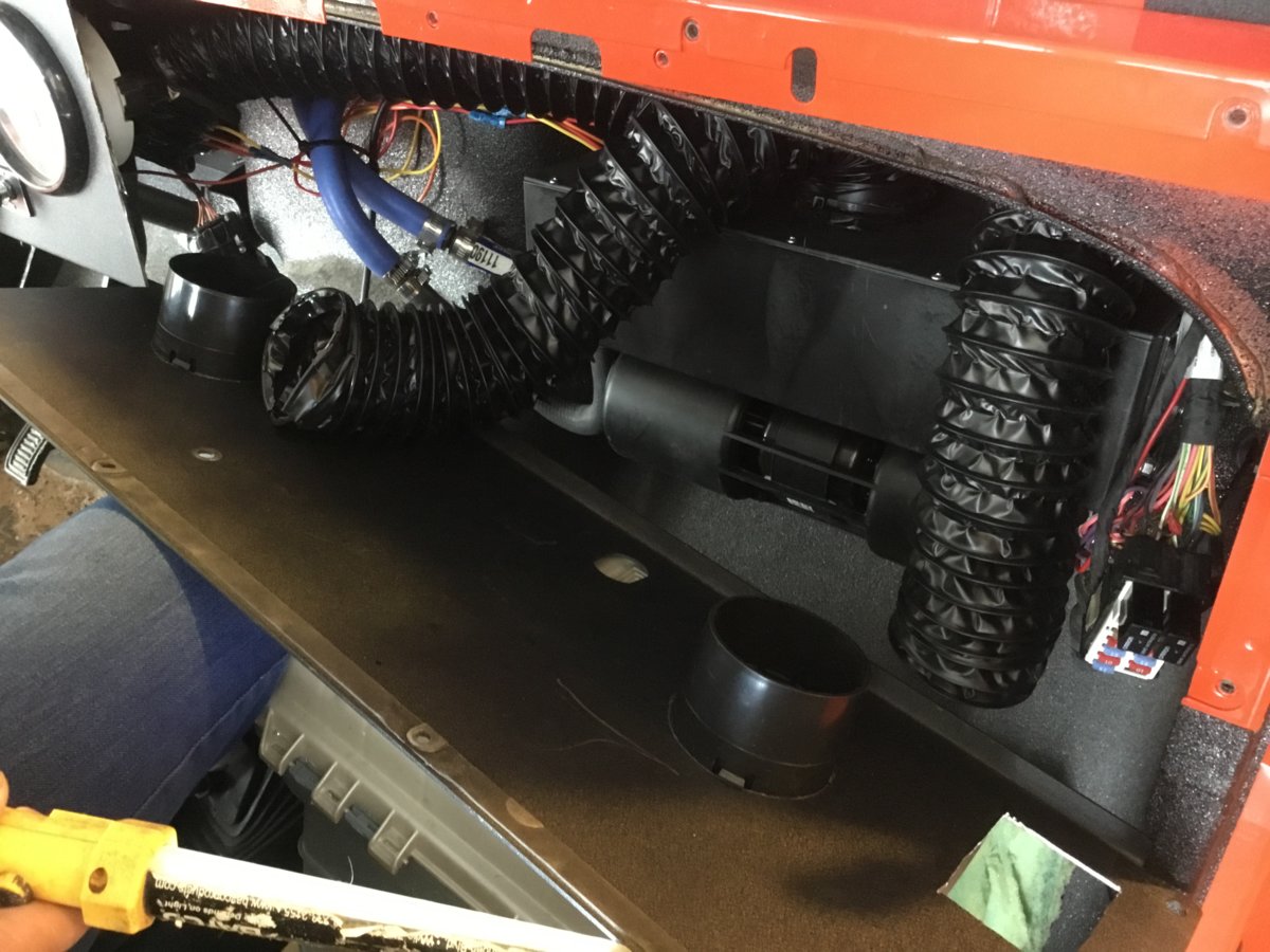

Any pics or link to your install
1E2FAE0D-08AB-4854-ADEB-215AA8D32275.jpeg DCC2E963-0B67-4DFD-9B82-840695F5229D.jpeg 4658DB73-4085-4E81-9695-1774728B49E7.jpeg
Darstar
Jul 2, 2018
493
Marquette, MI, USA
The pics hopefully shows what I did. For me I chose to cut dash in half for ease of install and other future installs. ( I am not young anymore,standing on my head is no longer an option ,! I had to relocate fuse block to front of dash. I used a waterproof cell phone case from Meijers . It’s now painted black. I also used 2 molded heater hose connectors, and factory holes in firewall. By cutting dash in half I was able to chuck up in dril press with hole saw, made for easy,safe drilling.

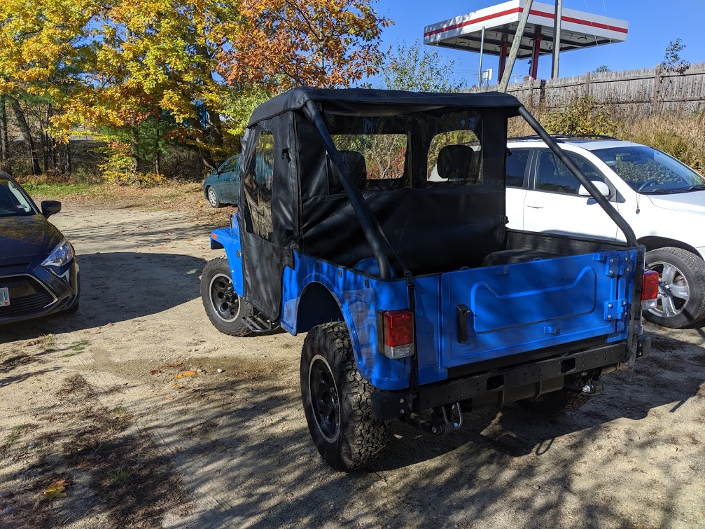

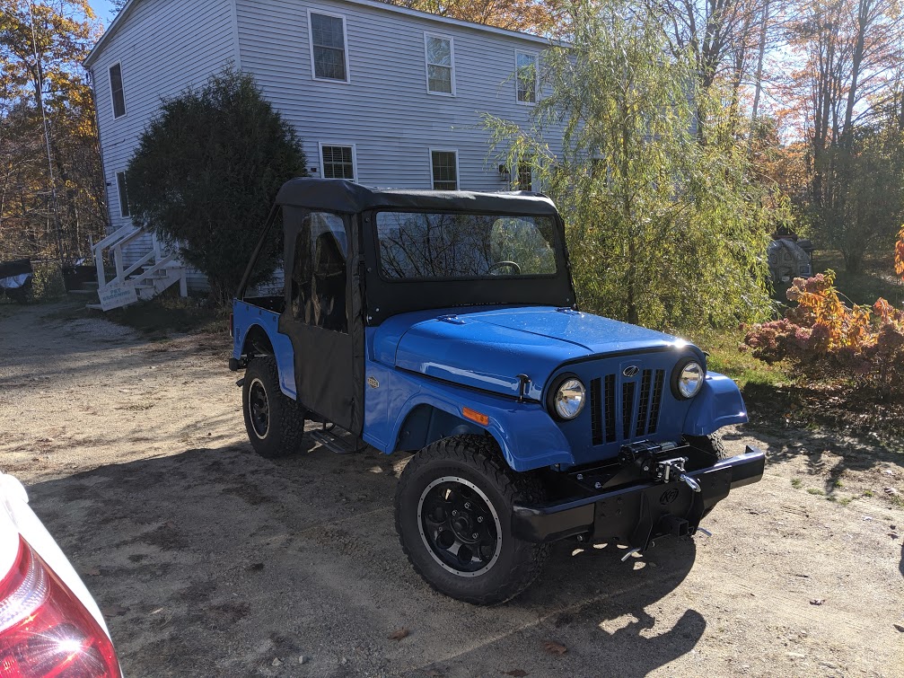

The Roxor is almost ready for plowing snow. A KFI plow , a glass laminate windshield and a half soft top install completed . Next updates will be windshield wipers and heat.
Darstar
Jul 2, 2018
493
Marquette, MI, USA
View attachment 5068View attachment 5069
You will find the stock tires that come with alloy rims ok for plowing snow , but NOT for mud. They are not “ self cleaning “ .
