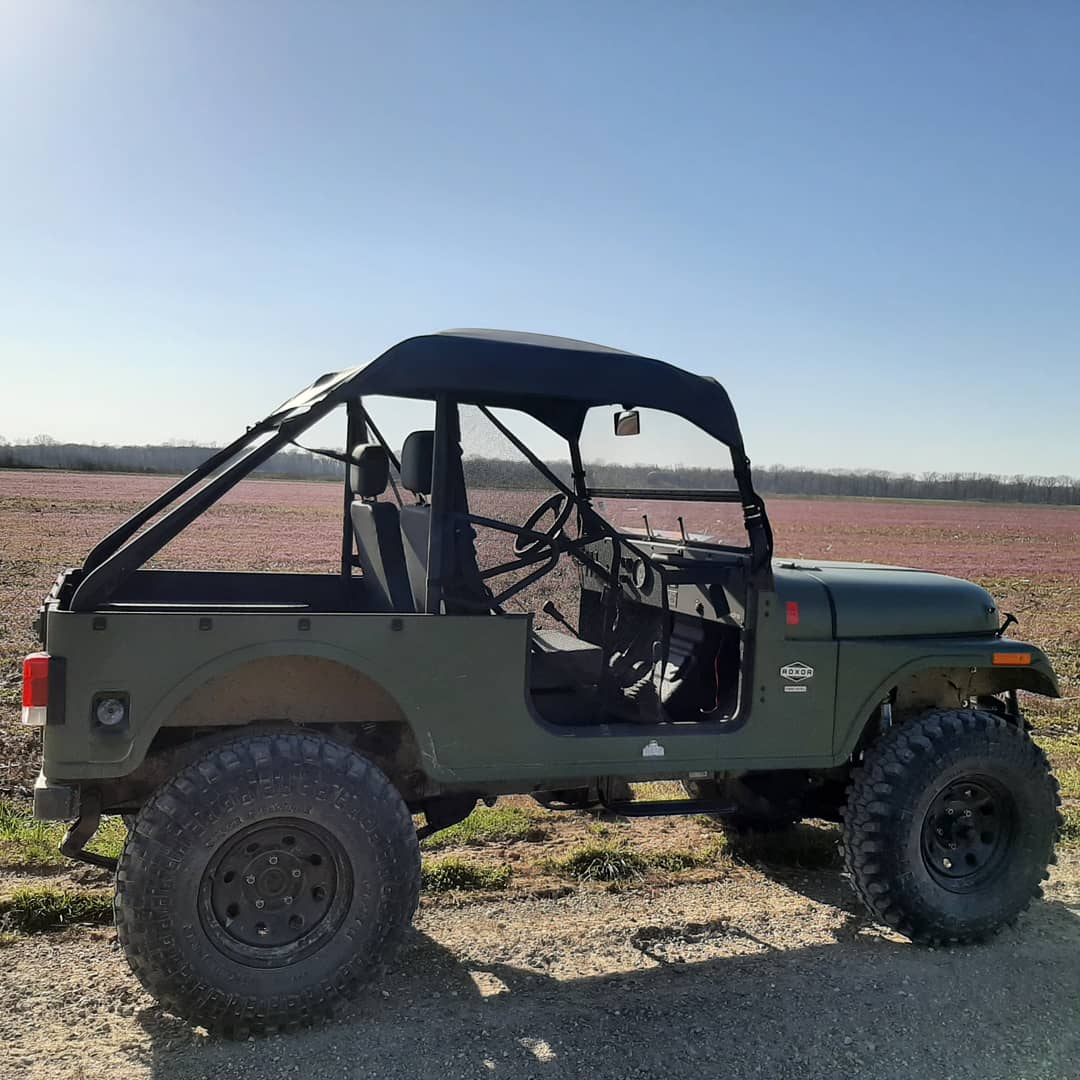

Here's 35s on a 4" suspension lift. The rear axle moved backwards about an inch with this setup and is pretty well centered. If you just lifted it, without relocating the axle back a bit, I don't think 35s would fit well
@Colderweather86 is right.
She looks great! I'll no doubt want a lift anyway so that's not a huge deal. I'm hoping if/when they resume production they give they option for picking a gear ratio. If not I'll definitely have to this route
Did you mount the rear spring shackle to the original hole, or have you drilled and welded in the sleeve?
Max speed with 34.25" diameter tires appears to be 76mph. I would not cruise this speed, and I could not push it faster. 55-60mph was plenty comfortable.
