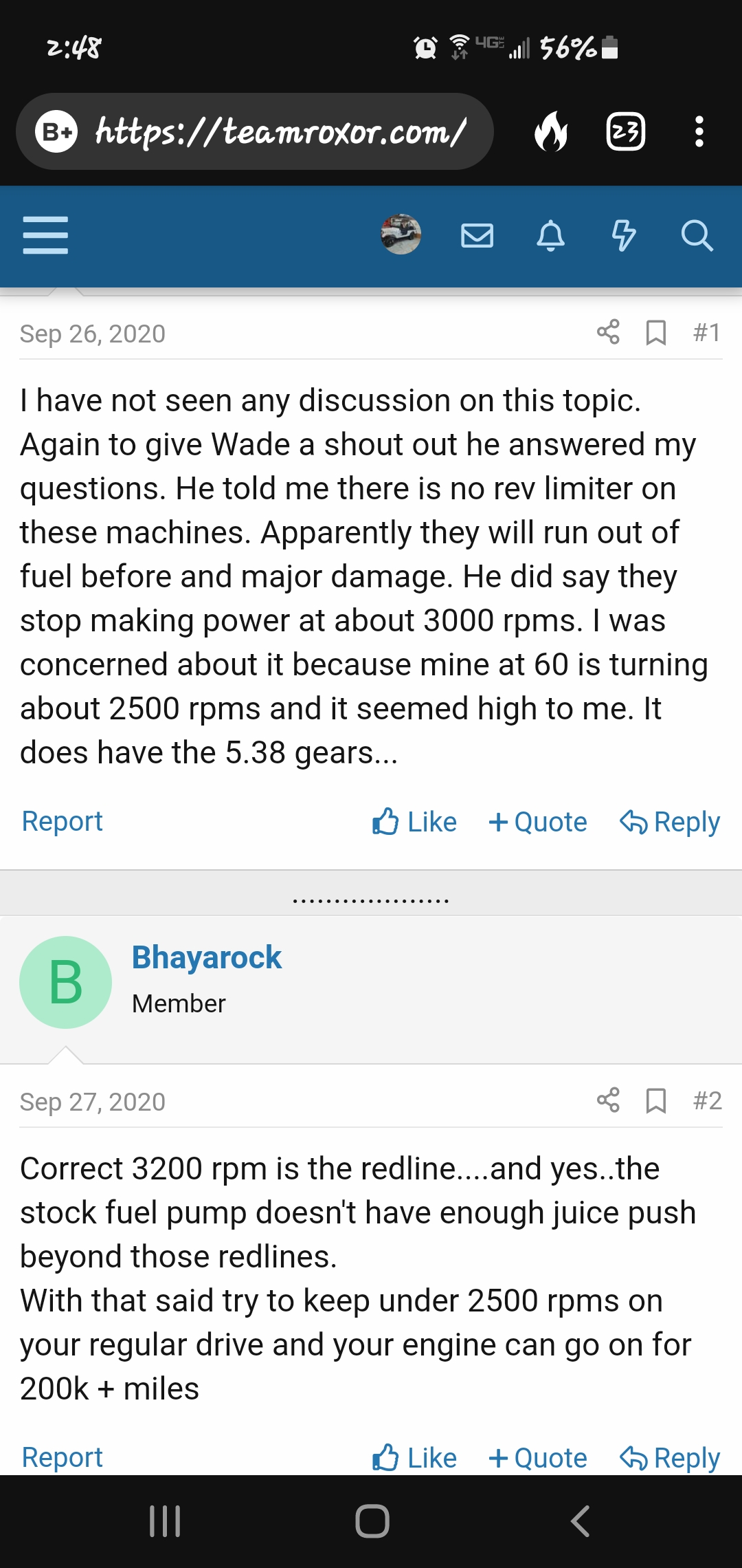

Based on your use I would highly recommend the 3.73. I have 5.38 and at 55 she is turning very close to 3000 rpm. I have been told that redline is 3200.

I just had my 2020 tuned and I would say over 60 and I'm not comfortable. The Rox engine can handle it but around bigger vehicle etc is interesting

Just remember where the red line is at. I heard just over 3000

I have an update for you, I was mistaken and did not realize it until recently.
My max speed with a stock roxor with 5.38:1 diffs and stock 29" tires, engine screaming, was 68mph. And I mean the thing was SCREAMING. I would never cruise with such high engine speeds. Apparently my speedo was already adjusted for 35s and I didn't know it, neither did the guy that tuned it so maybe mine was originally setup for 3.73 ratio and nobody changed that ratio in the computer, don't know, don't care. 68 max gps verified. The engine is working uncomfortably hard at 45mph with little tires on it.
Now with tires measuring 34.25" diameter I've not topped it out, but it's about 2550 rpm at 55mph. I've had it to 65mph and I was comfortable with the engine sounds and rpm. I'll let it loose later and see what she'll do
