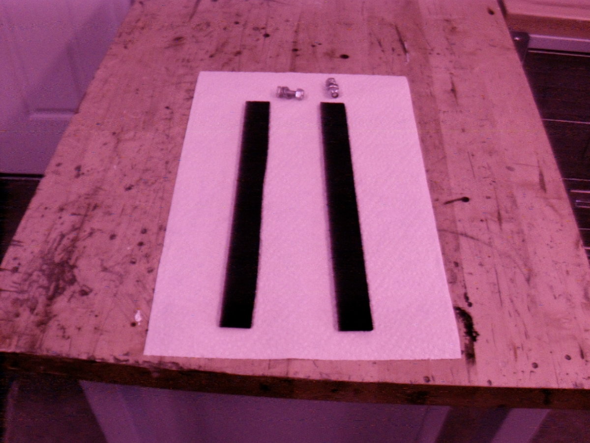

Went to the local farm and tractor supply and purchased a piece of heavy duty black rubber stall matting to put in the cargo area to help keep things from sliding around and to have something softer for the pets to sit/ride on. It is very durable heavy dense rubber.

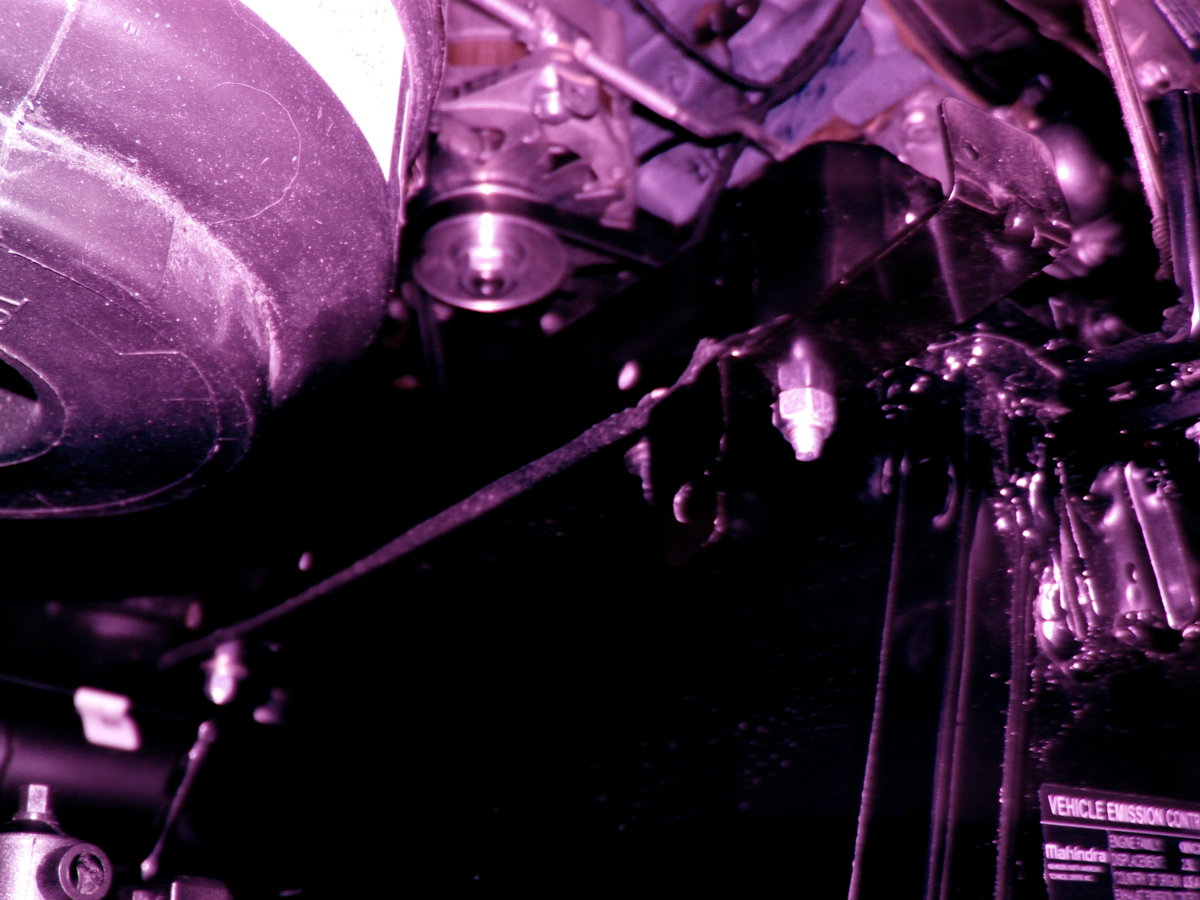

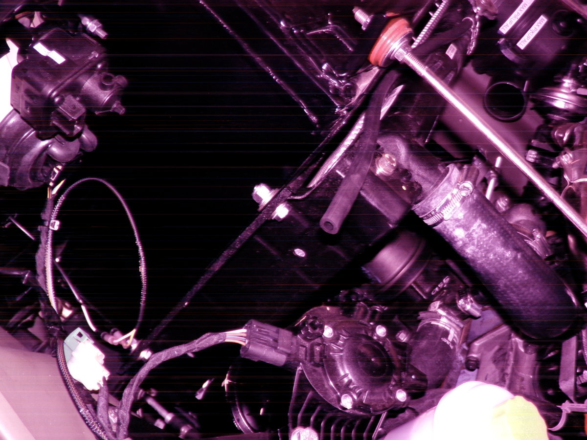

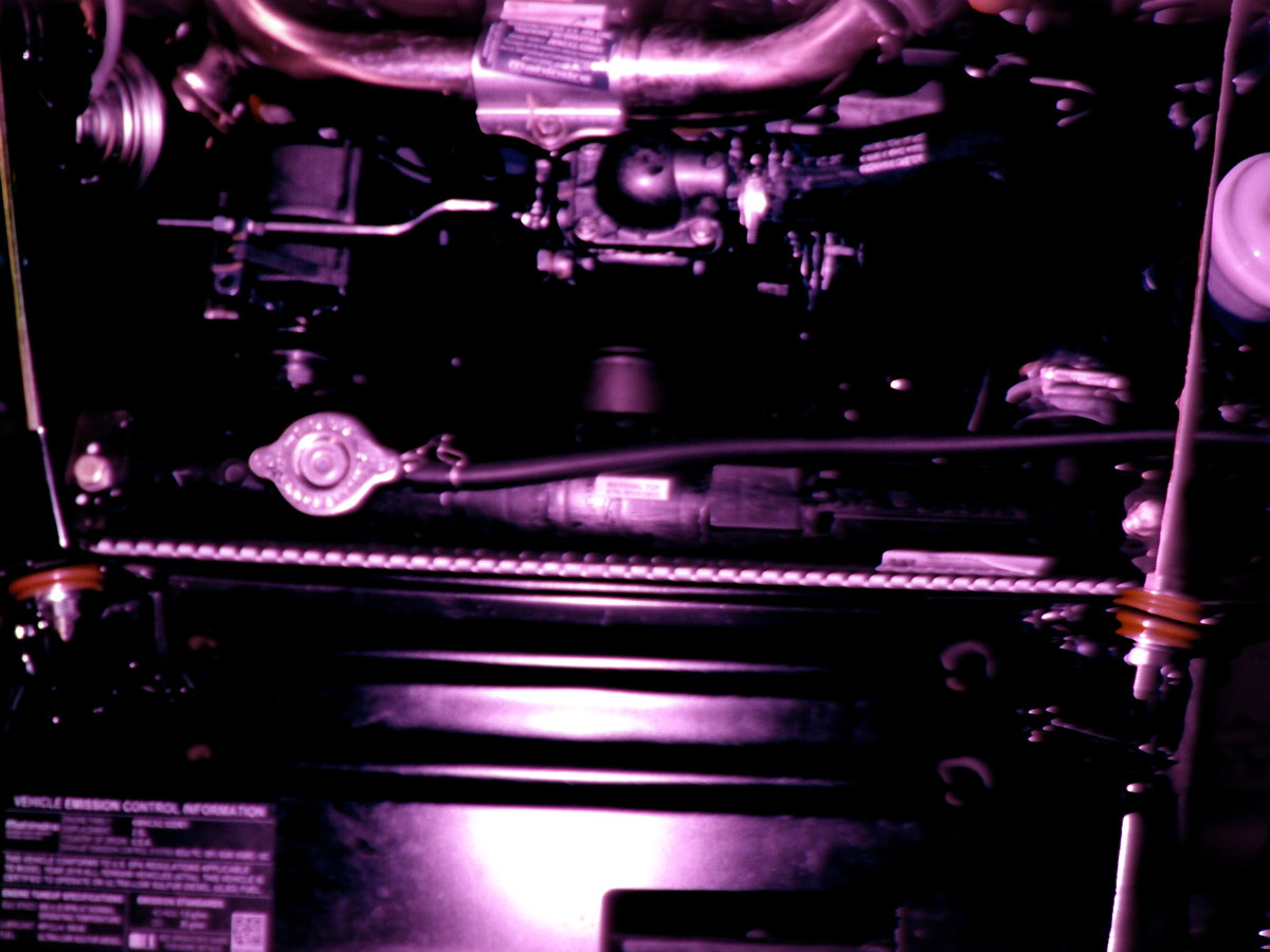

Purchased extra and used it to (rubber mount) the radiator. This will help with the vibration and stress caused by off-roading. New vehicles all use some kind of rubber mounting method as well. It works.
Also used larger washers to secure it all in place. The factory just had small washers that could perceivably cause cracking around the mounts over time.
