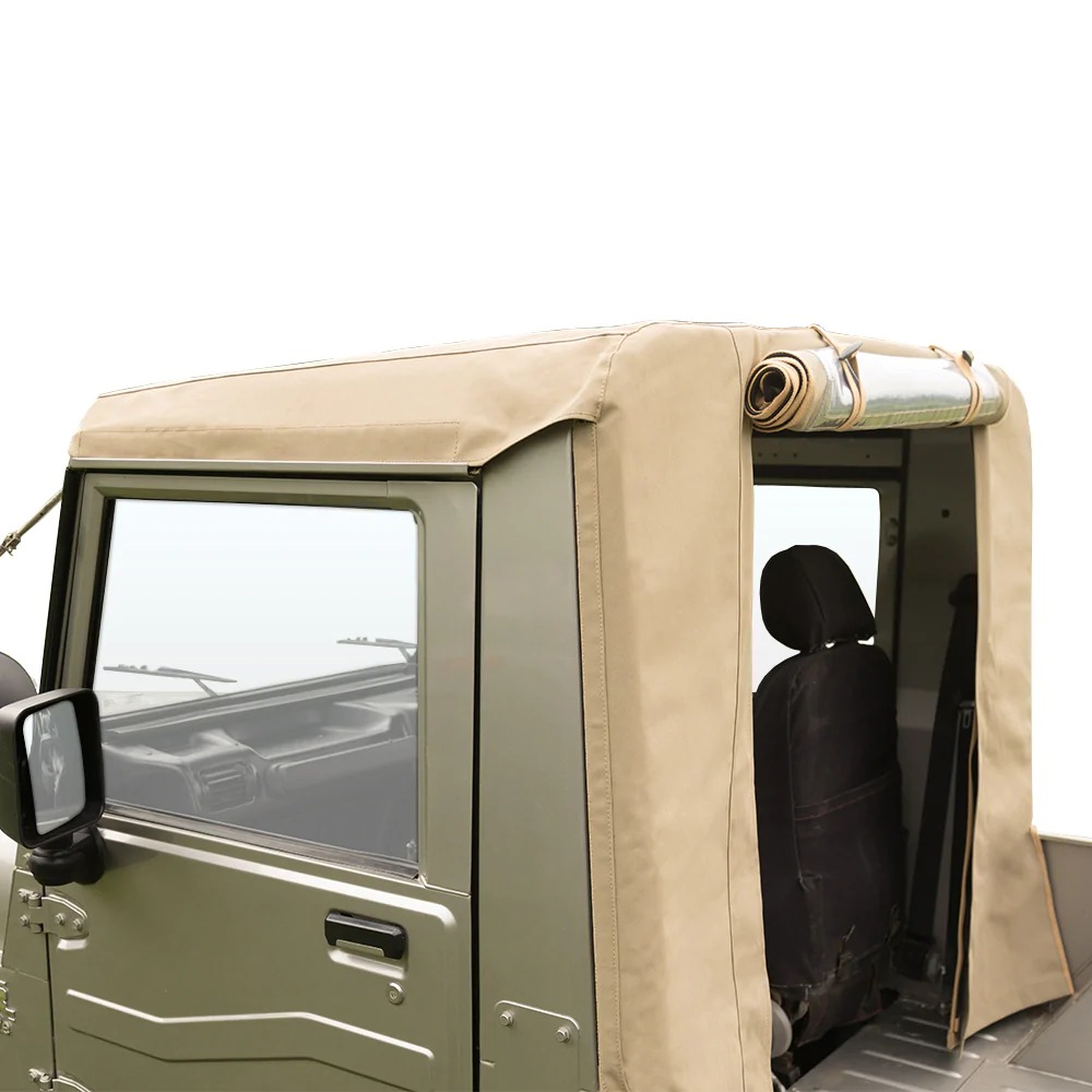

Hello Roxor lovers,
We have Mahindra OEM Complete Full Hard Door, Soft Top (4Seater) , Windshield Frame, Wipers Kit , A PILLAR, B PILLAR COMPLETE SET, TOP BRIDGE PART A PILLAR TO B PILLAR, CONNECTING PART FROM WINDSHIELD TO B PILLAR , OEM and Stylish Mirror, Bumper, Bonnet, Mudguard, Fender Kit, Engine Parts, Chassis Parts, Tailgate, Headlight,LOCK ITEMS, FIBER PARTS, Grill , side indicators etc..
