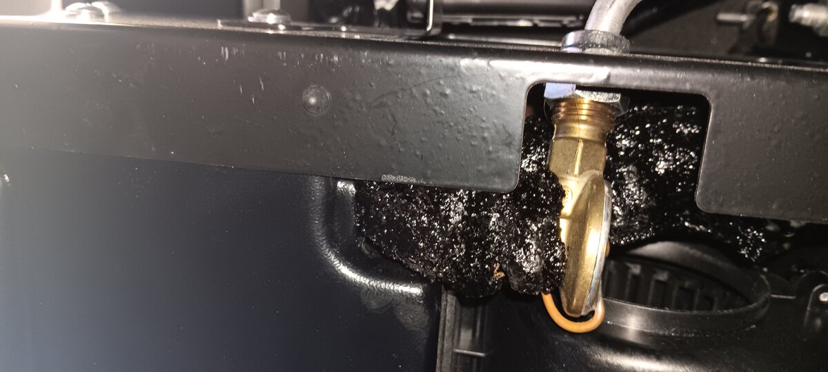

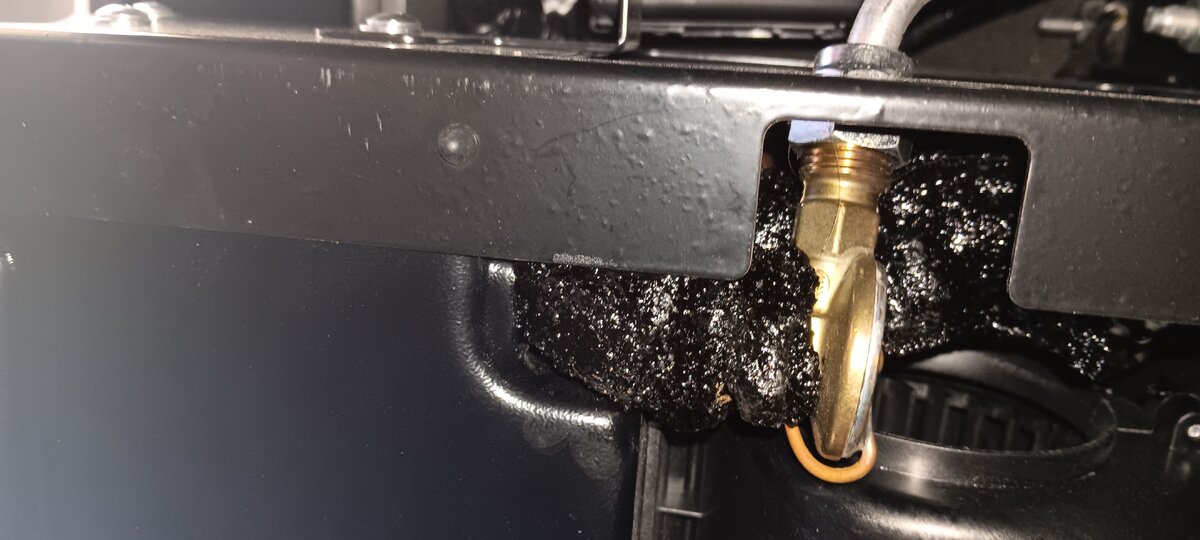

The first item I would check, is to ensure the factory did not leave the plugs on the Evaporator lines. This was a common issue on the factory installed AC units. It was the first item I had my dealer check when I ordered my Roxor.
I would also check the thermal expansion valve. If you have the factory kit, the valve is on the right end of the unit. It may be hidden by the sealant.

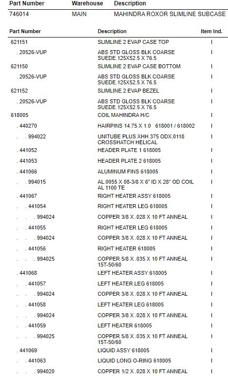

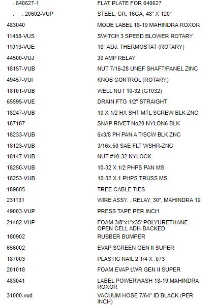

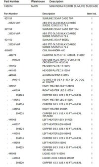

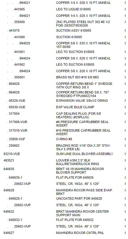

I have the parts listing for the Vintage Air system. I will dig it up and post it.
This is the Parts List for the Vintage Air Slimline AC. I thought I had a drawing Breakdown also; I will look for that.
Slimline Subcase IPB 3.JPG Slimline Subcase IPB 2.jpg Slimline Subcase IPB 1.jpg
