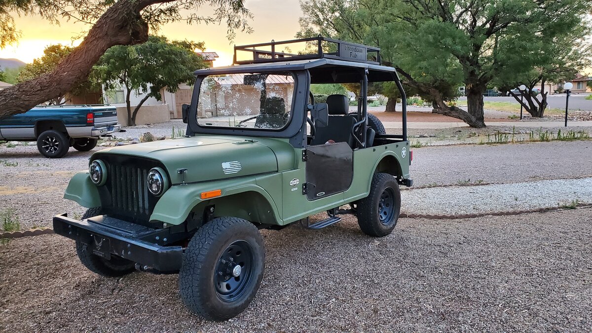

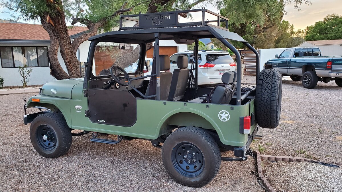

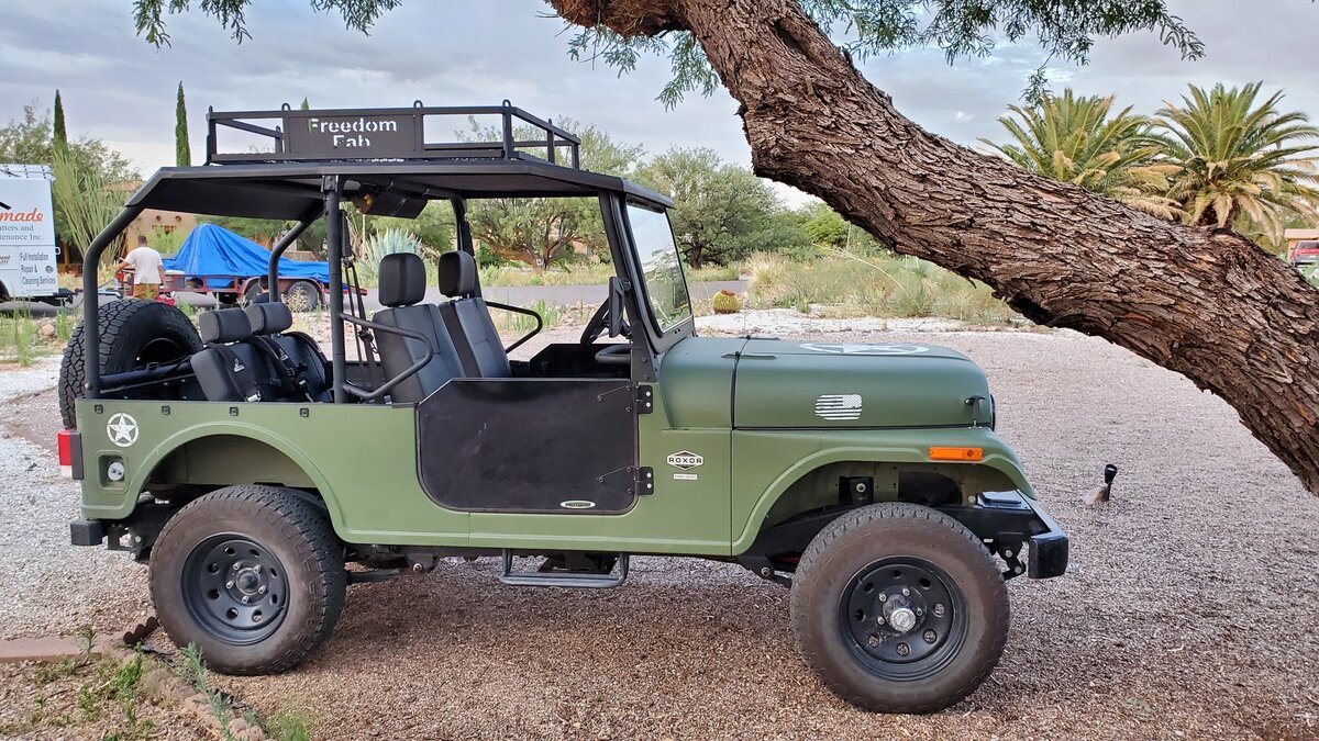

Everything is finished up, roof was extended and the roof rack installed.

I’ll second that, like the package. Are those Fortress doors? Been considering them, how do you like them? Also, even though it looks like the top is modeled after Fortress I don’t think it is, am I right? Lastly, was the addition of the rear ROP a local add? Looks like slightly larger diameter tubing than factory.

Fortress top that I extended to accommodate the rollbar change. We actually bent the rear to match the factory roll bar angle so I could use the rear lip on Fortresses factory roof. The doors are Fortress also I bought them from Wade at Diesel Freak and I like them but they rattle more than I would like, I want to find something that can go over the pin to quiet them down a bit. The rear roll bars are custom add and they are ever so slightly larger than factory but you really can't tell, the powder coating came out great. Local guys called Freedom Fab made the roof rack and some mods to the cage to bolt it down and the powder coating!

I think the roof is 14 gauge and its bent on a machine by a shop, tig welded like body work.

They did a nice job. I had to really look to see where the seam runs. The bevels along the edges match perfectly. Looks great.

use heat shrink on the pins. Cheap and effective.
