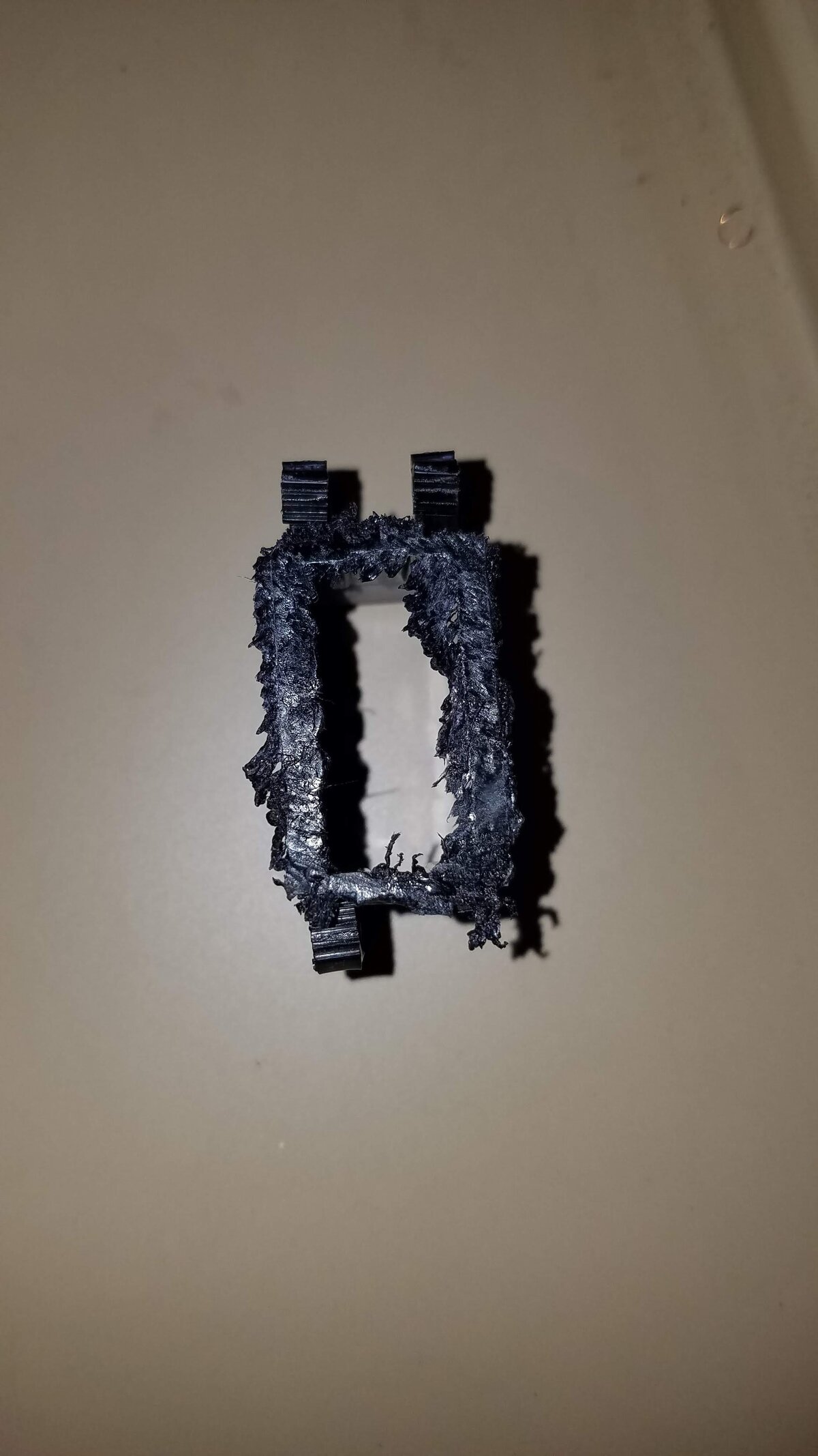

After looking at Bister's video I see a big difference in my blank. LOOK AT THE TABS ON THAT THING! They wouldn't let go! Yeah, I had to saw the front off and push it back through. Glad I didn't make a video. Definitely would have been censored.

Just cut the clips on the bottom of the covers with a pair of dikes. If you don't have dikes, use needle nose pliers to break them out. Once the bottom ones are out, the insert is easy to get out, and you don't have to tear up the paint.

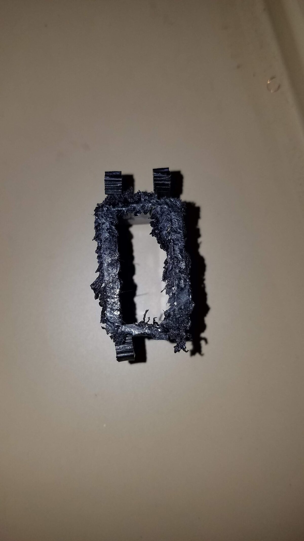

Looks like my Dobermann got a hold of it!;)
You know the first one came out like Bister's video, so I didn't think the next one would be any different. Sure, I could have looked up under the dash to see it had clips to cut, but being angry and lazy I took the short cut. DESTROY IT! ?
Thanks Coldweather86. Next time I'll know. And Roxasuras, my hand also looks like your Doberman got a hold of it.?
