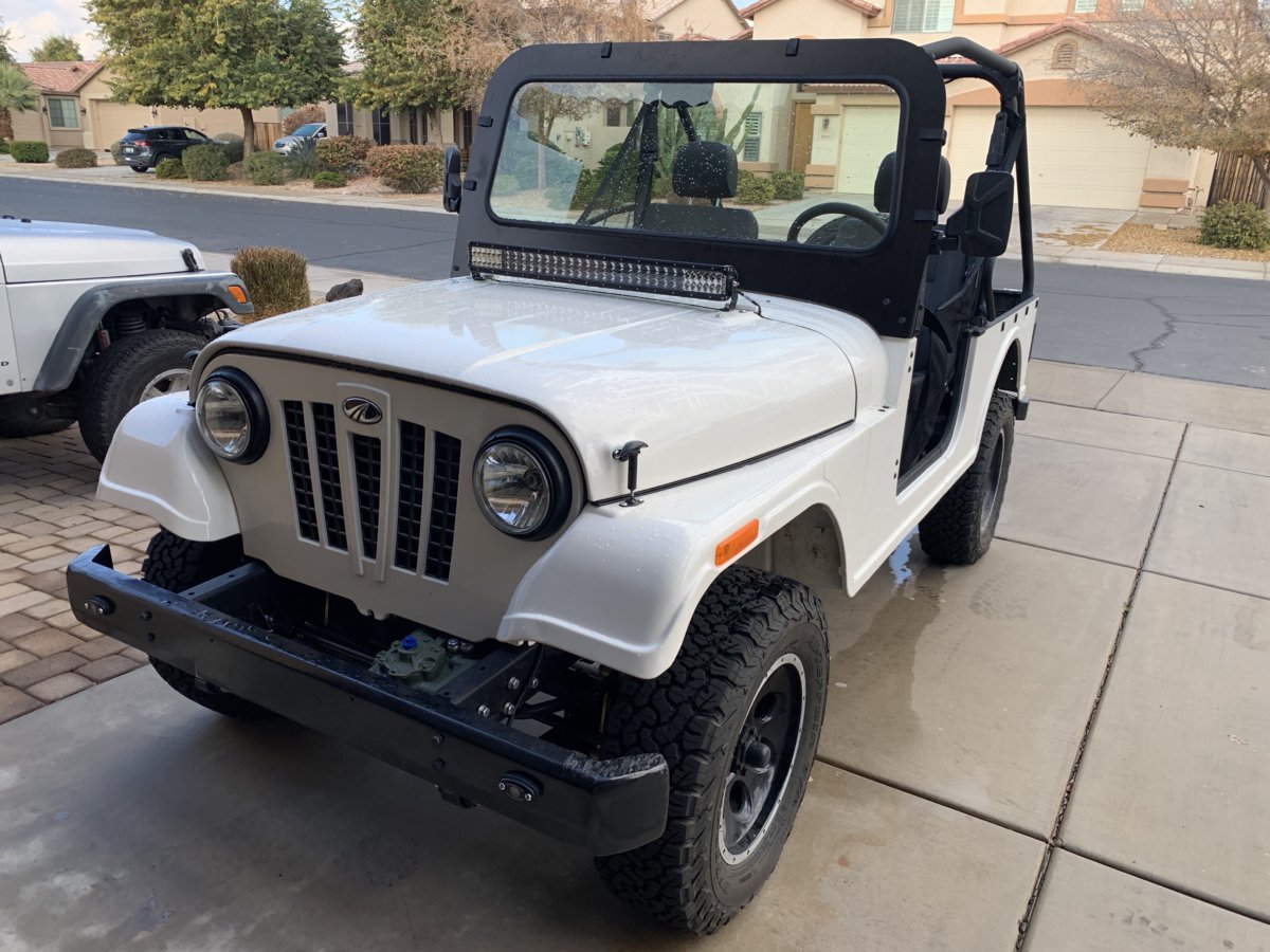

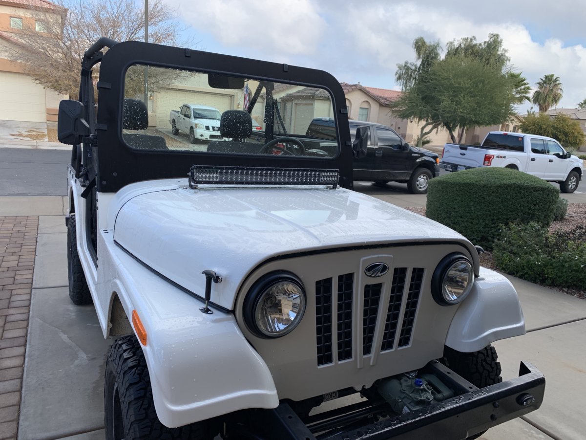

I had a early CJ model windshield. In order to mount it I had to remove the front and side ROPS. The CJ windshield was too low. The Roxor seats are up higher than a Cj's because of those storage boxes.
I had to take my Rox to Nash Powersports where I saw a display Roxor with a local supplied windshield. I went home with one. DOT glass included.

You pulled off the CJ frame and replaced it with the Nash supplied one?
876
The early CJ5 seats are actually around the same base height, only a little difference (there was a fuel tank under the driver's seat and flip up toolbox under the passenger). The Roxor seats are def thicker. All this adds to the height.
IMO top choice dictates ROPS plan. If someone makes a non cheesy top that works with early or late CJ windshields, awesome. I'd prefer OtR or Fotress make an enclosure that works with their windshields, as massive visibility increase over the CJs is awesome - as is the stock ROPS.
View attachment 2642 View attachment 2644
Do you get a lot of windshield flex when driving with the local supplied windshield?
