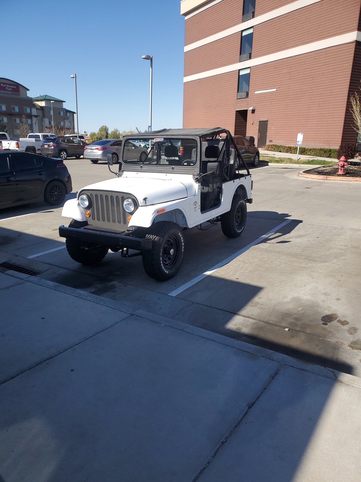

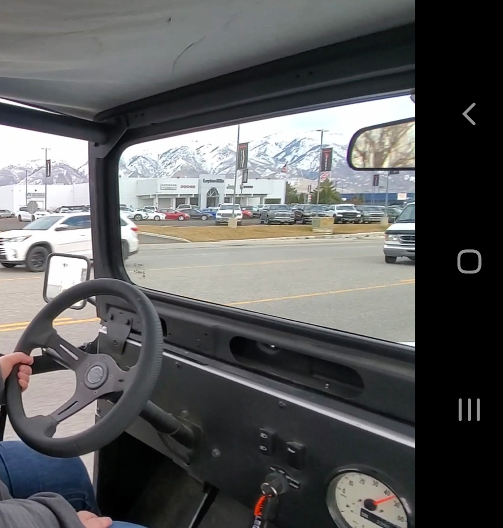

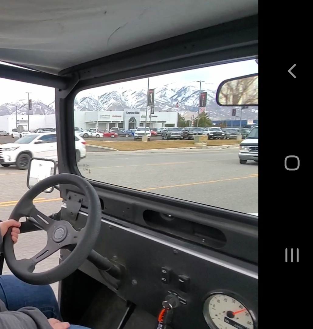

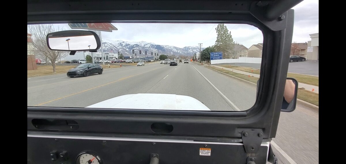

I went CJ/YJ windshield frame that was $80, the hinges worked bolt on. The glass $40, wiper system CJ total with switches and motor $200. I reworked my rollcage to bolt to CJ windshield. Very happy and satisfied

My windshield came with two holes in both corners of windshield th

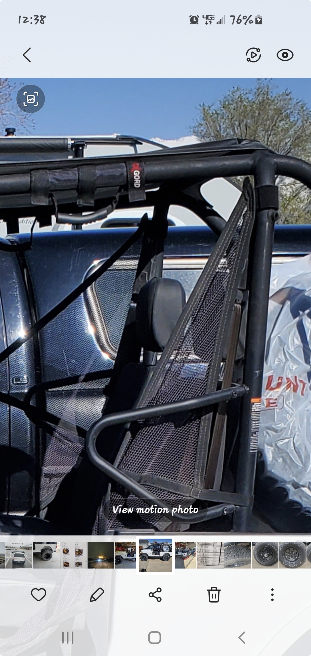

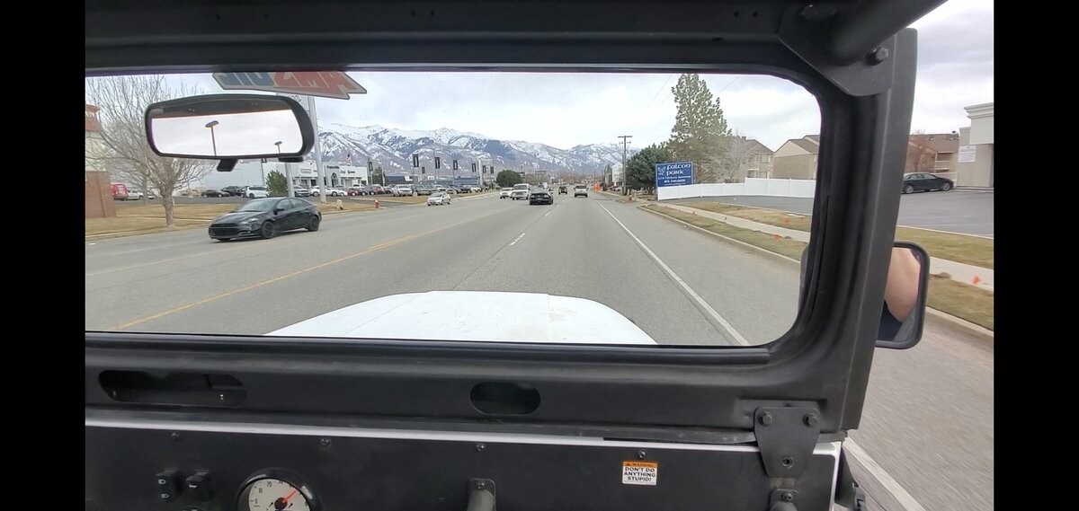

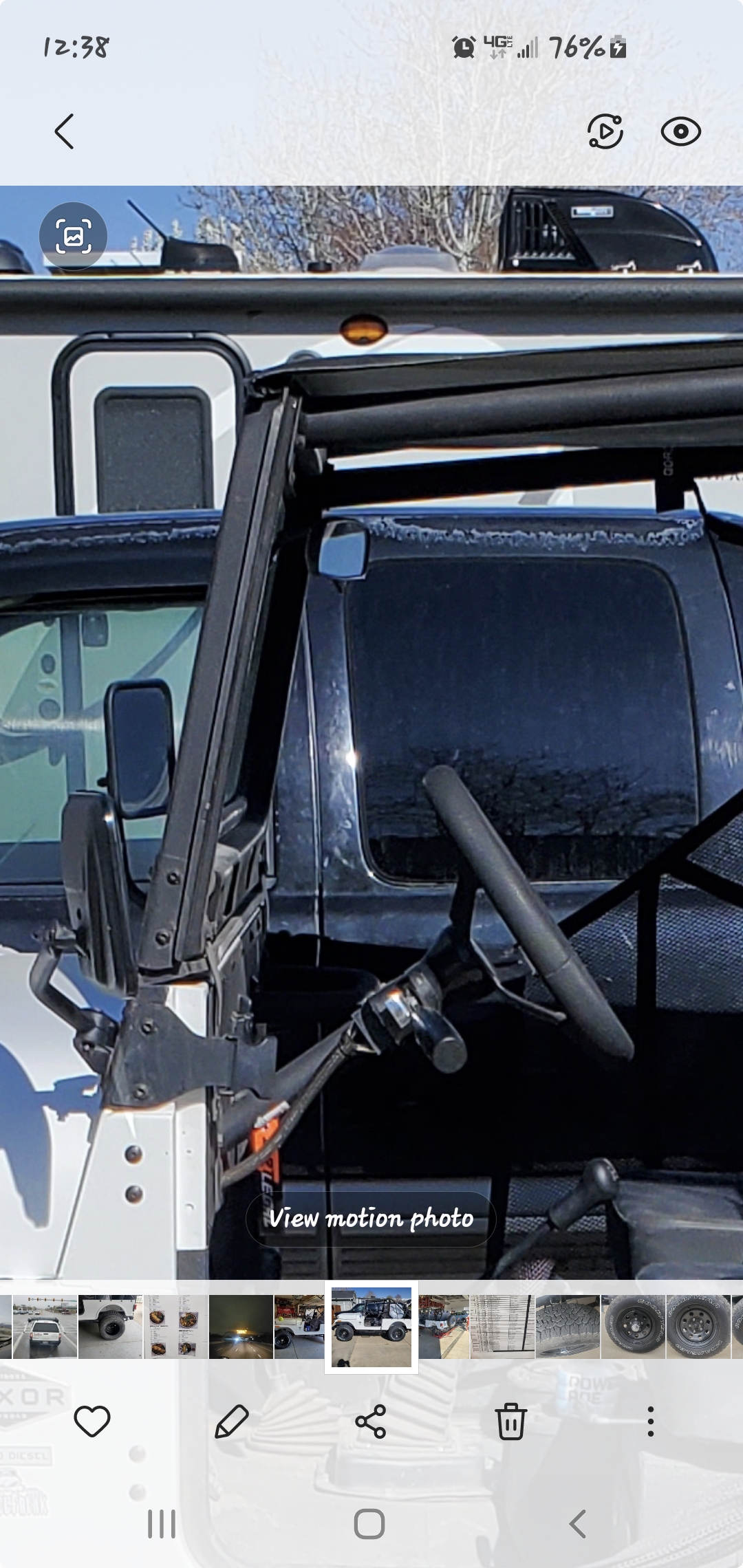

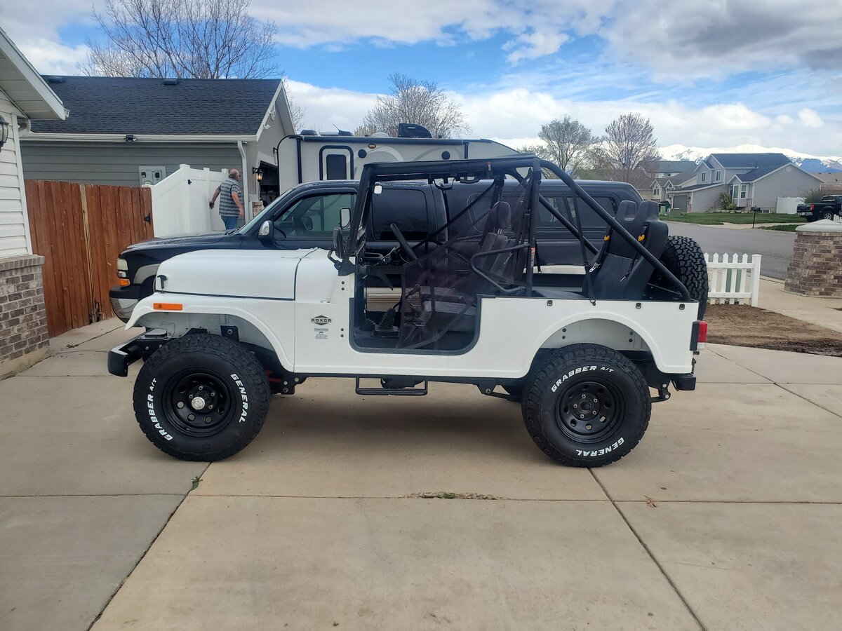

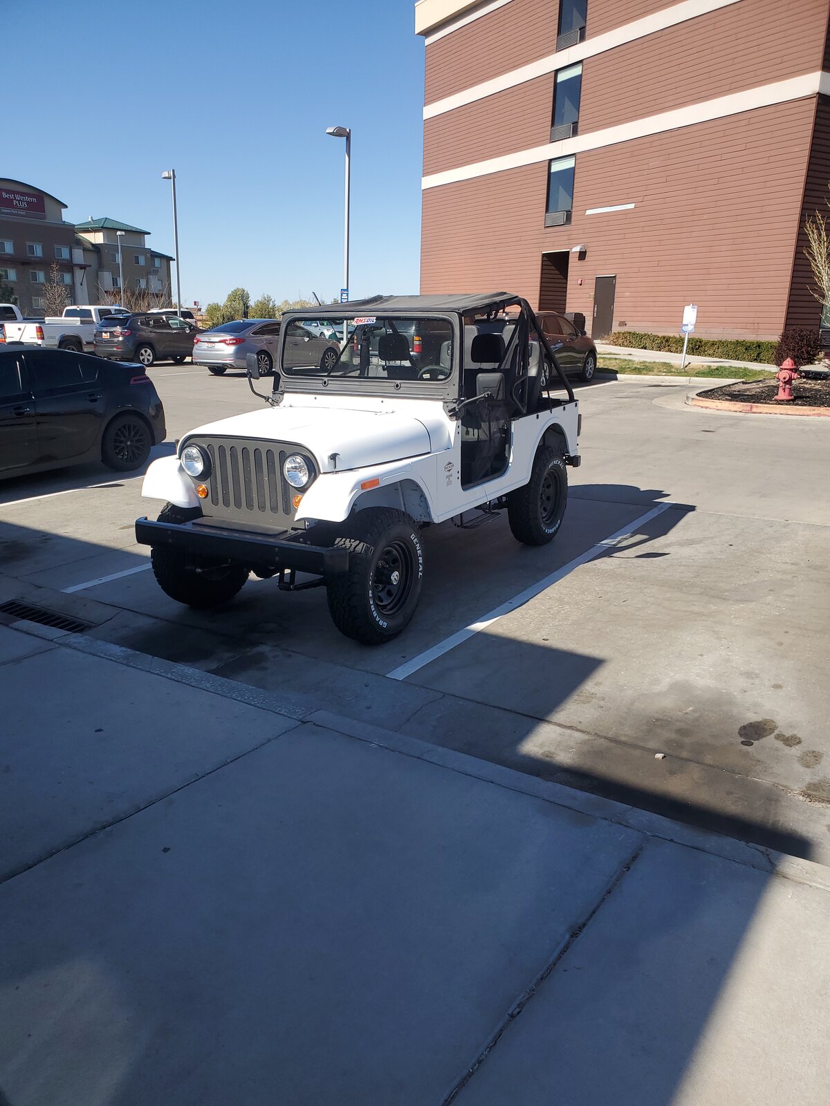

Other posts that i have read seem to indicate that the top of the CJ windshield is much lower than the top of the standard roxor windshield so the ROPS does not match up without lowering the ROPs or raising the CJ windshield. i dont mind modifying the ROPS, but if i have to take 4 inches out of it, it seems my head would hit the roof. Did you have to lower your ROPS?
822
It's perfect in my opinion. I mounted windshield directly to bolts holes in Rox. I didn't drop center loop. As u can see in pictures my bar from windshield to center loop slopes upward. I'm 6'3 no issues. My friend who is 6'9 got close but still didn't touch. I've seen some cut center loop down and it would be to close to my head. The windshield view from seat is perfect. I removed the bracket where rops were a continual piece from fender to windshield. Cut and welded it to the center loop then welded from center loop to the plates I made that mount to windshield. My rox is a one of a kind like yours will be.
