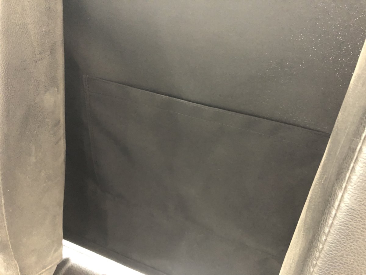

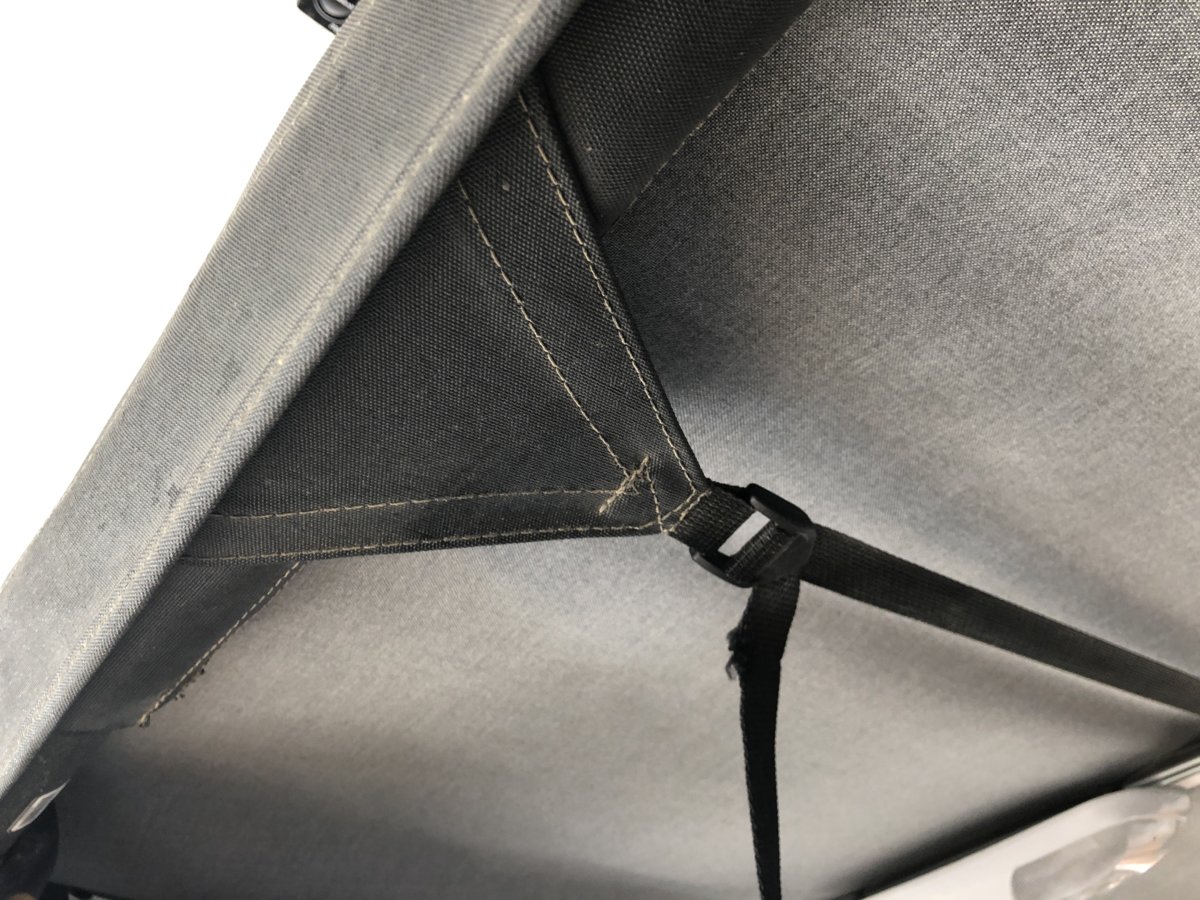

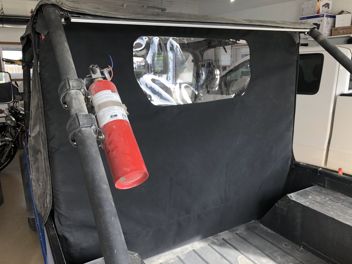

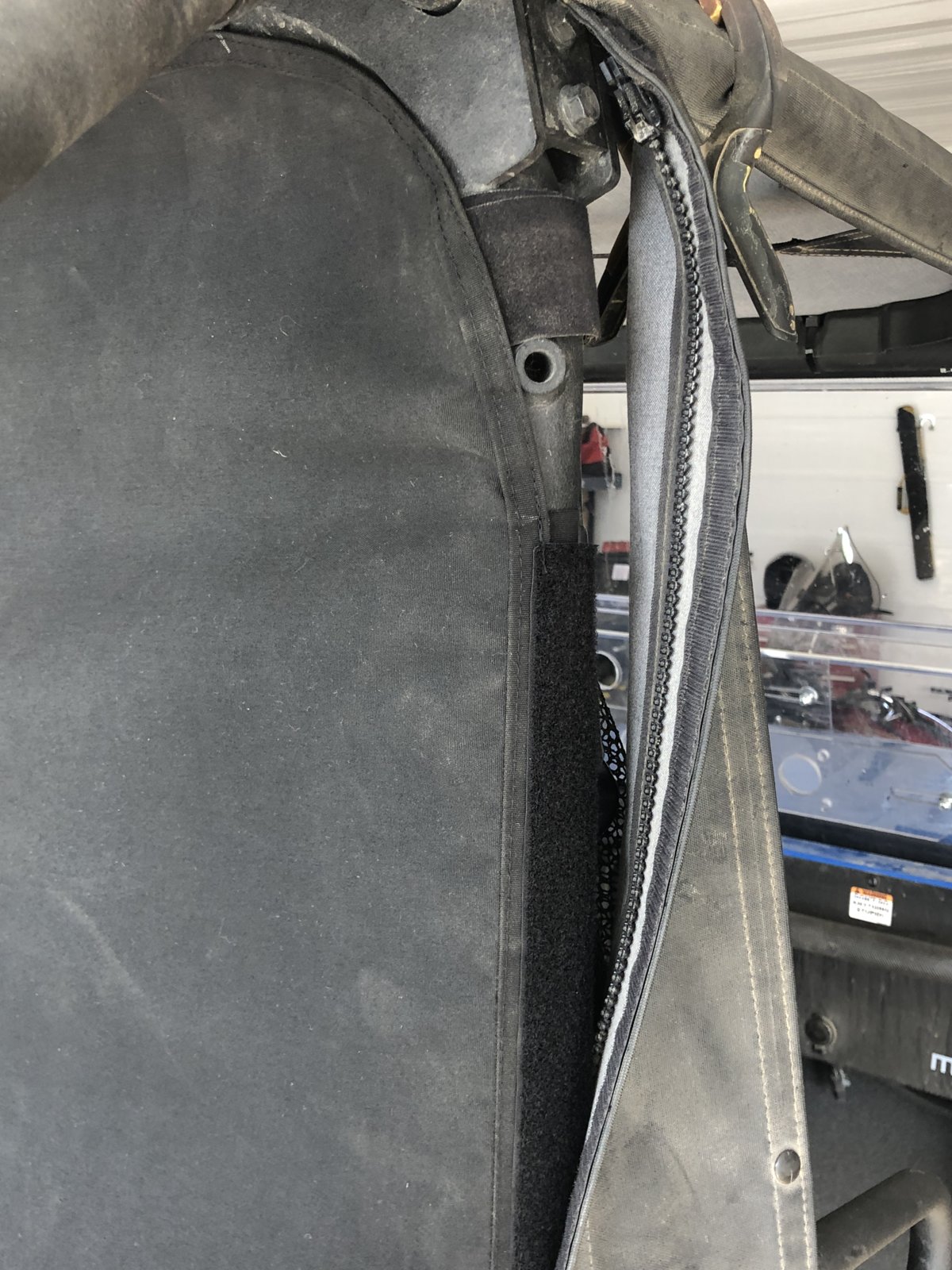

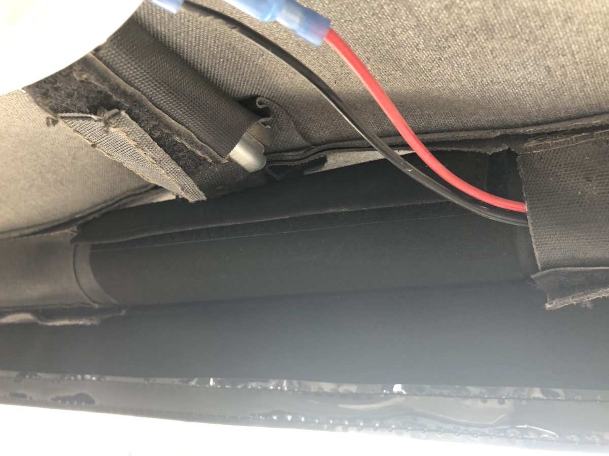

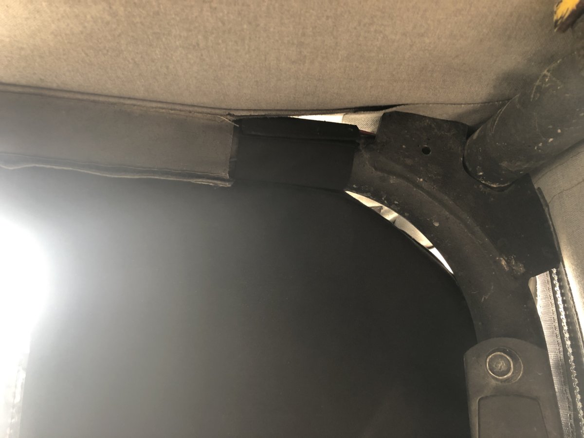

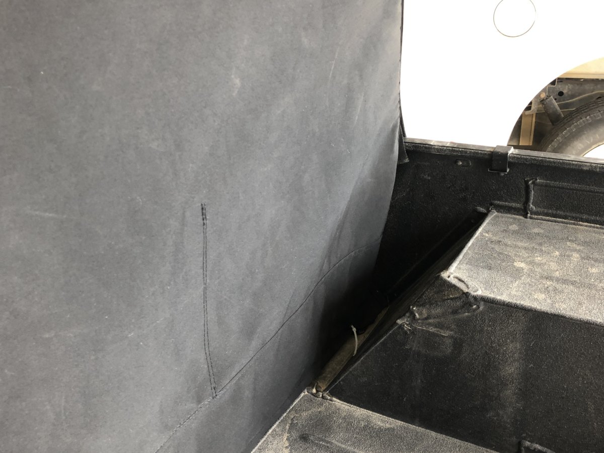

Got my dust shield made. First time the guy has made one. Pocket between seats, nice size window. He wrapped the attachment point around the ROP the same as the soft cab is. I can put my cab sides on if I want and use it as a half cab or just leave it in for winter. We might have to put a tightener strap across, right now it just balloons up like a parachute, the roof does the same, neither of them flap around. With the small side parts of the soft cab on as in the pictures, it keeps it snug. If we do, I’ll just take it off and he will match the roof design for a tightener, easy fix. Grommets in the bottom corners to tie the bottom down to the pieces on the bottom of the ROP's. There is about a half inch gap on the bottom. He sewed a stiff piece of plastic in it. I like it. With the vented (tacky) homemade windshield, should be perfect and I like I can now have a half cab for winter. I might get a local company to punch me out a prototype windshield that I can fit those Siemik Versa Vents in under the glass and I would have it so it works with the soft cab, basically match the OEM for holes and have the same bend so it goes over the clamps etc

This would be the type of tightener I would do.

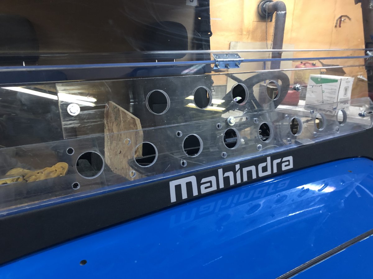

This is the vent I think would work good in a vented windshield to help with dust.

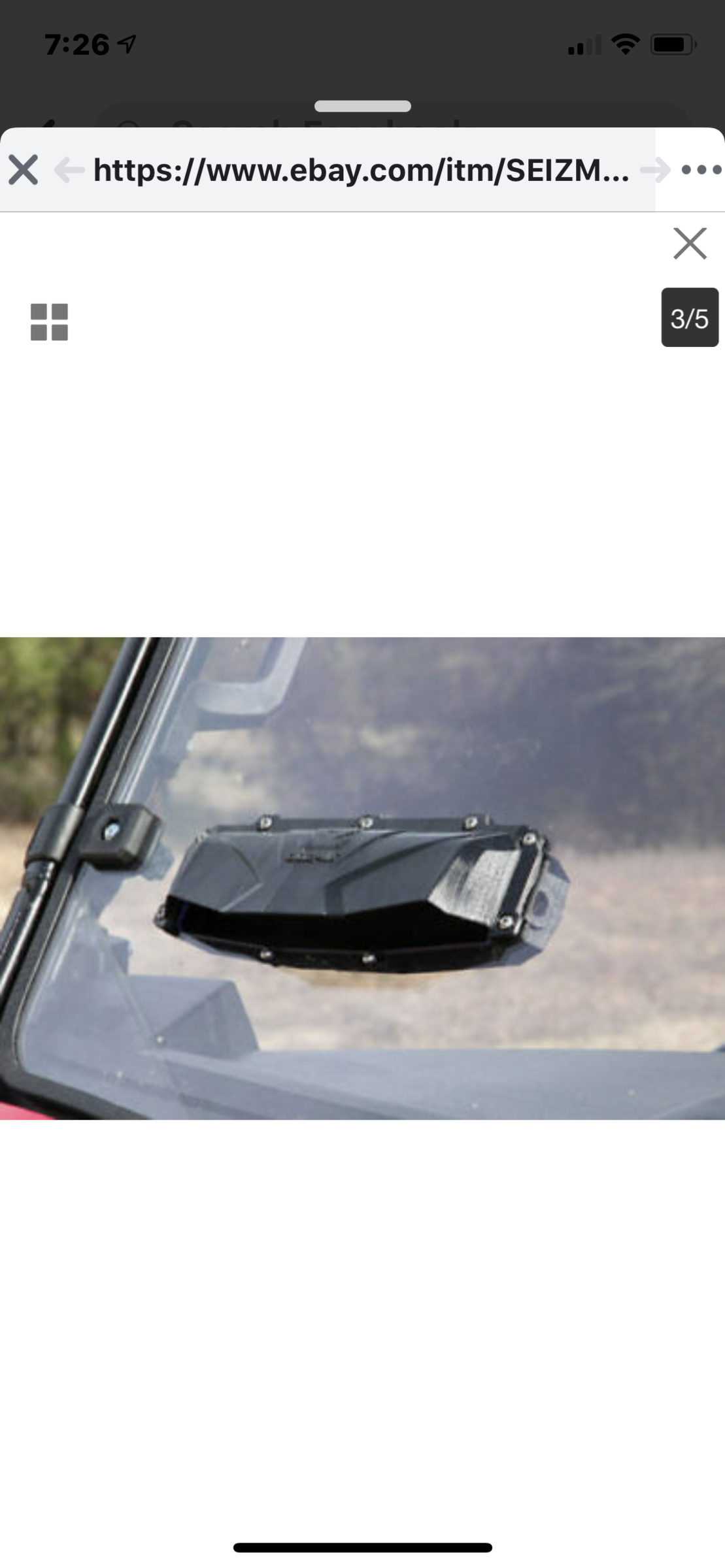

My 'tacky' windshield works for now, "Function over fashion" on this one.
