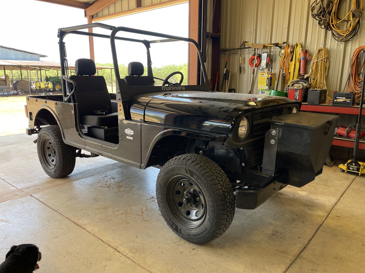

Picked up my new 2022 Roxor last week and am in the process of customizing it. First, I added a custom road feeder to the front which required some custom fabrication, but worked very nicely (see pic). The electrical wiring to the dummy rocker switches is still a mystery to me and am looking for further information on that, but I'm figuring it out. What I want to do now is add a rear platform, about 30" of extension, out from the back bumper to haul game animals and gear. In looking at the bumper very briefly before leaving the Ranch, it appears the provided bumper is bolted and welded to the frame. And I'm not understanding the utility of the bumper as provided. It has numerous bolt holes thru it, I guess, for hitch mounts and other accessories. I don't see an easy way to simply remove the existing bumper without cutting some weld plates, so I'm contemplating fabricating an extension platform which can be bolted to the existing bumper and then weld some supports underneath supporting the platform from the frame. My question to the forum is: Has anyone removed the stock bumper on the 2022 model or has anyone bolted on such extensions to the bumper? I'm concerned the stock bumper isn't that solid and won't handle any torsion very well as introduced by the leverage of a 30" extension. Thanks

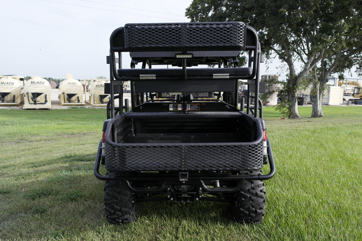

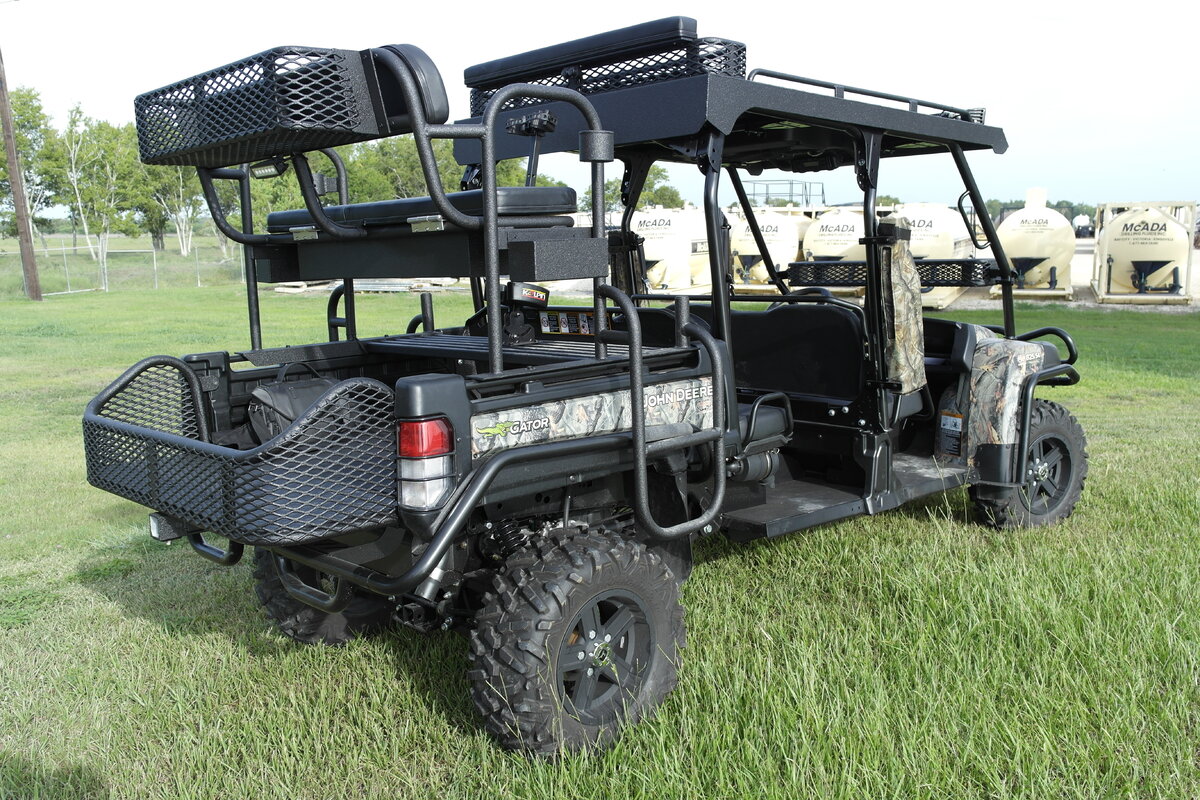

I'd be worried about the leverage that the additional 30" will create. That back frame end is not very strong and if bent its not going to be an easy fix. There is just nothing to bolt on to that's very strong back there. I think I would get the best rear bumper I could find and add a couple of extra receiver hitches out to the right and left of the middle and then build a platform of some type that attaches with the 3 receiver hitches.
Roxor HD Bolt-on 2" Receiver Hitch
SQ6942156
Roxor Performance Rear Bumper
SQ1707073
Plan B
Get with Sean at Big Country Outdoors to fabricate something like the rear extension he built for my JD Gator. I'm betting he can fix you up. He can also do a great job on a roxor. He has done both mine and everything was first class.
