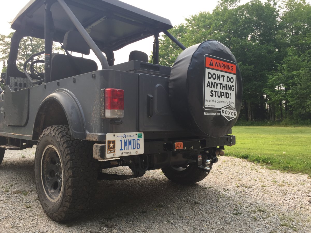

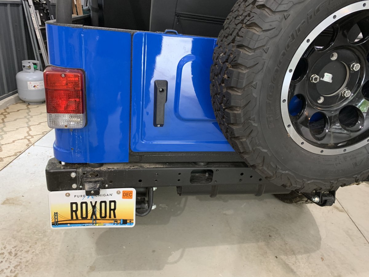

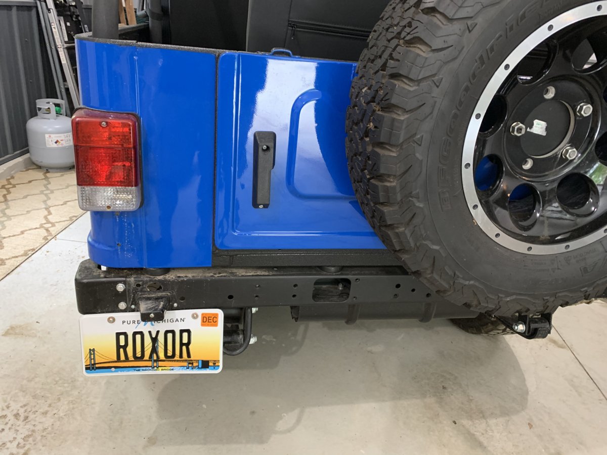

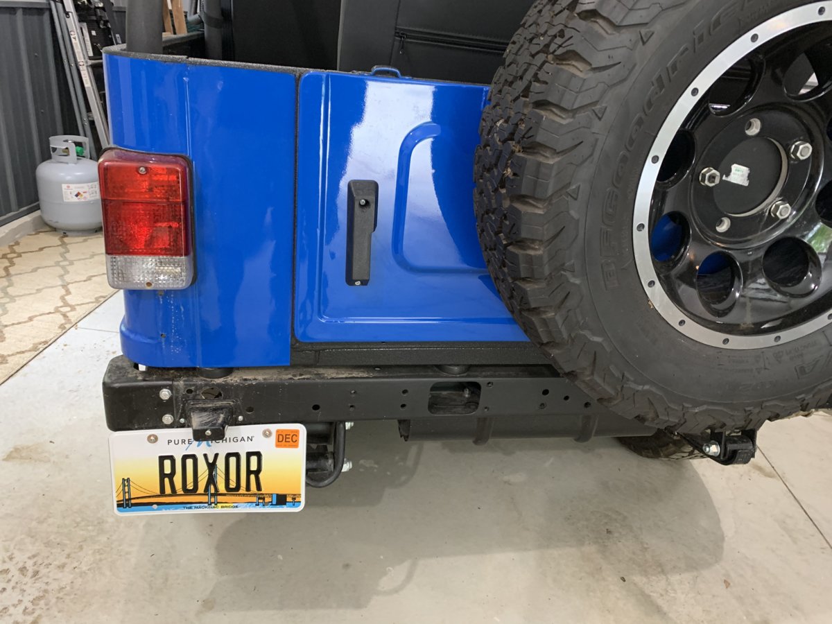

Done, ain't no small plate! I think I need to find a better place to mount the plate.
That's awesome man! I have the same plate holder and mounted it under my taillight. Just fits without sticking out past the side of the Roxor. I'll get a pic tomorrow. I am still awaiting an inspection to get the process started, but will find someone to get it done.
I may have to move mine over to there, I like it, fortunately I didn't drill any holes in the bumper to mount it.
We used one existing hole for attaching and fabricated the plate holder
Originally had it like yours but with off roading the plate got bent several times..... this fixed it.

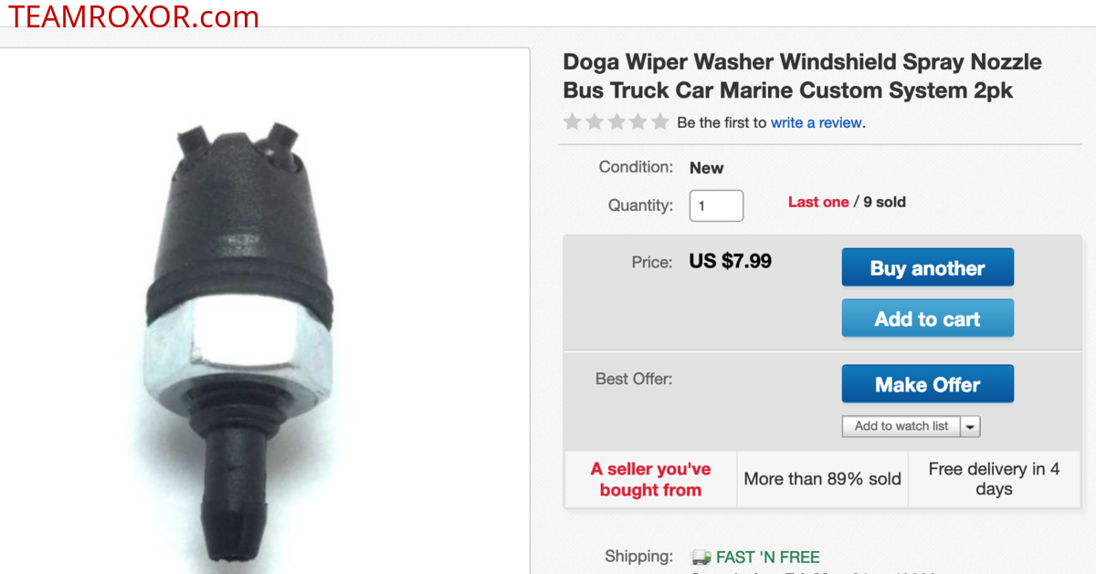

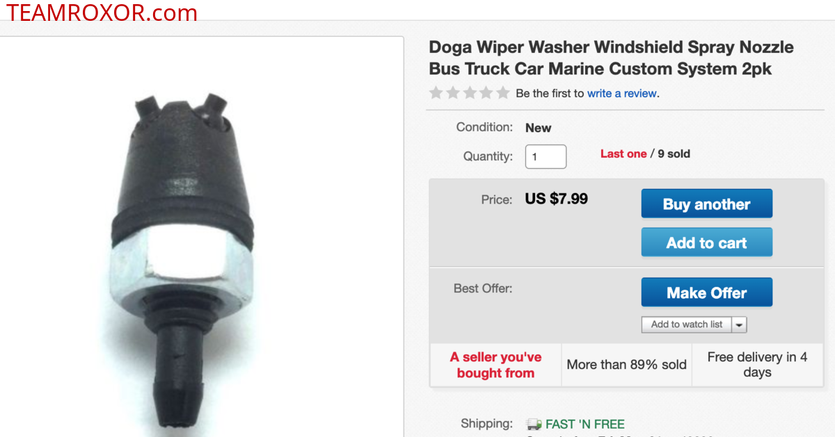

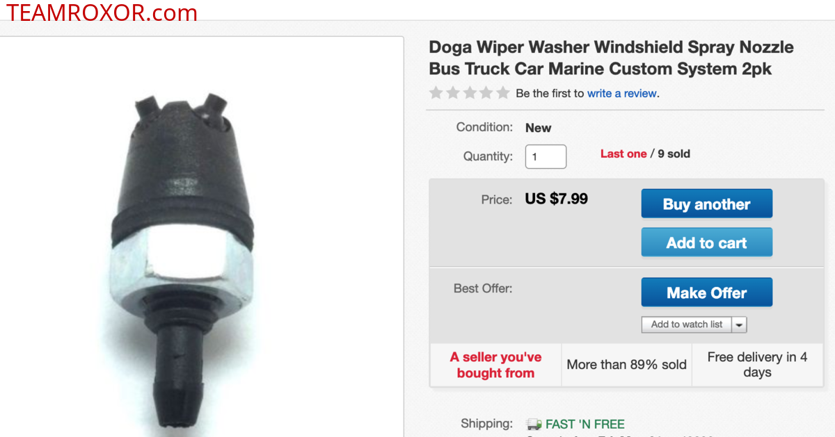

Windshield washer just bought a cheap kit off of Ebay and used these spray nozzles, work out pretty well.
