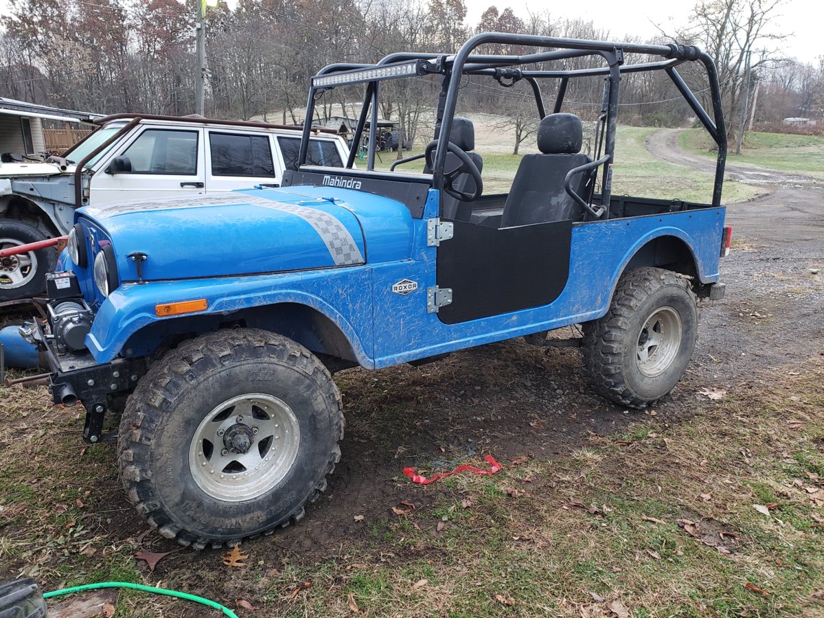

Bought my Roxor about 2 months ago. Leveled the front and put on 34s the day I bought it. Caged and locked the rear. I have a set of D60/D70 to go in with 39.5s. Going to enjoy it this way for the winter. Also working on adapting a D300 to the 5 speed.
