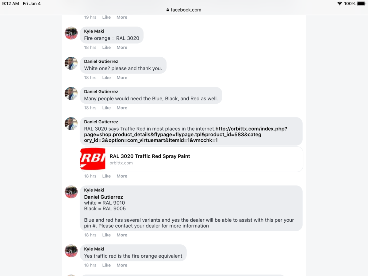

A gentleman in the facebook Roxor page states he is a Roxor dealer and gave a few codes for a few colors, but said that if you give your “PIN” number to your dealer he will give you the paint code to your rig.
so supposedly white is RAL 9010.

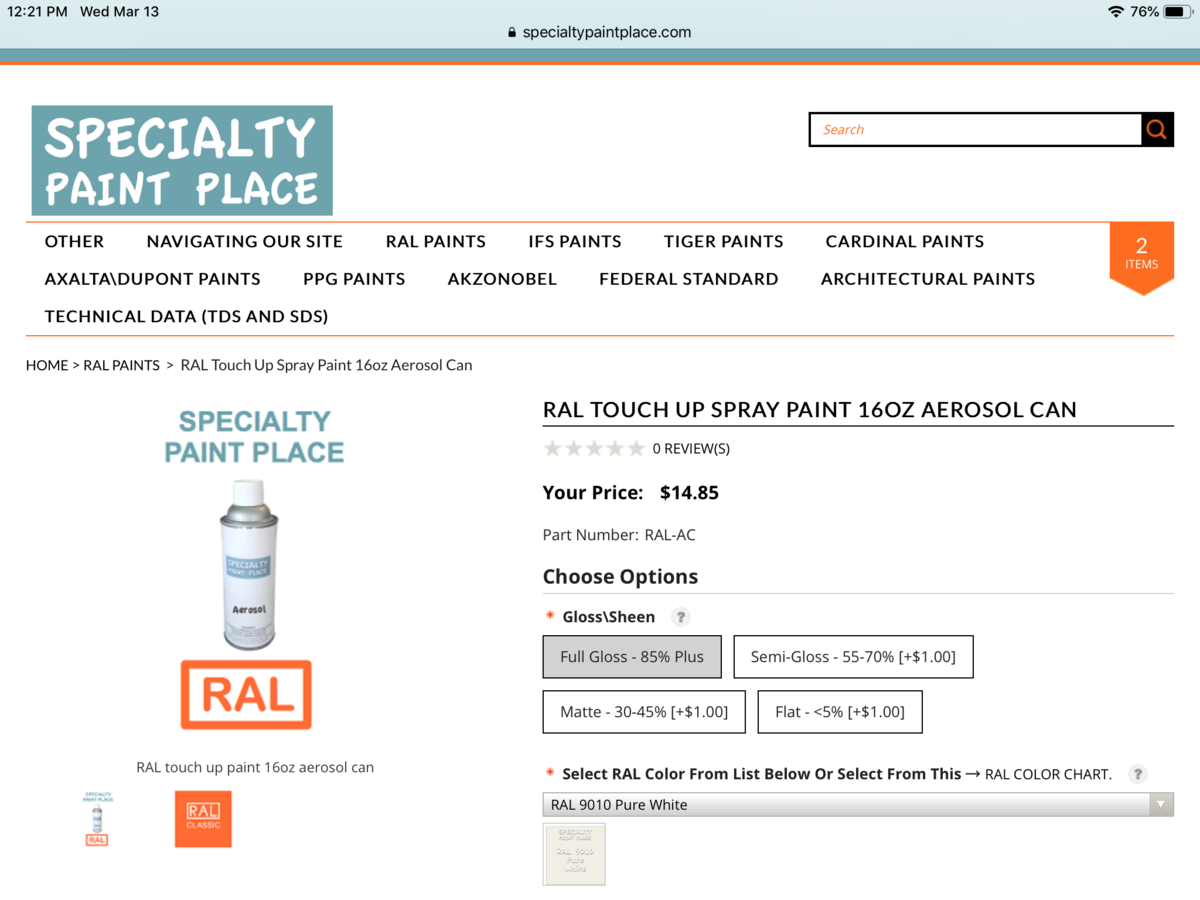

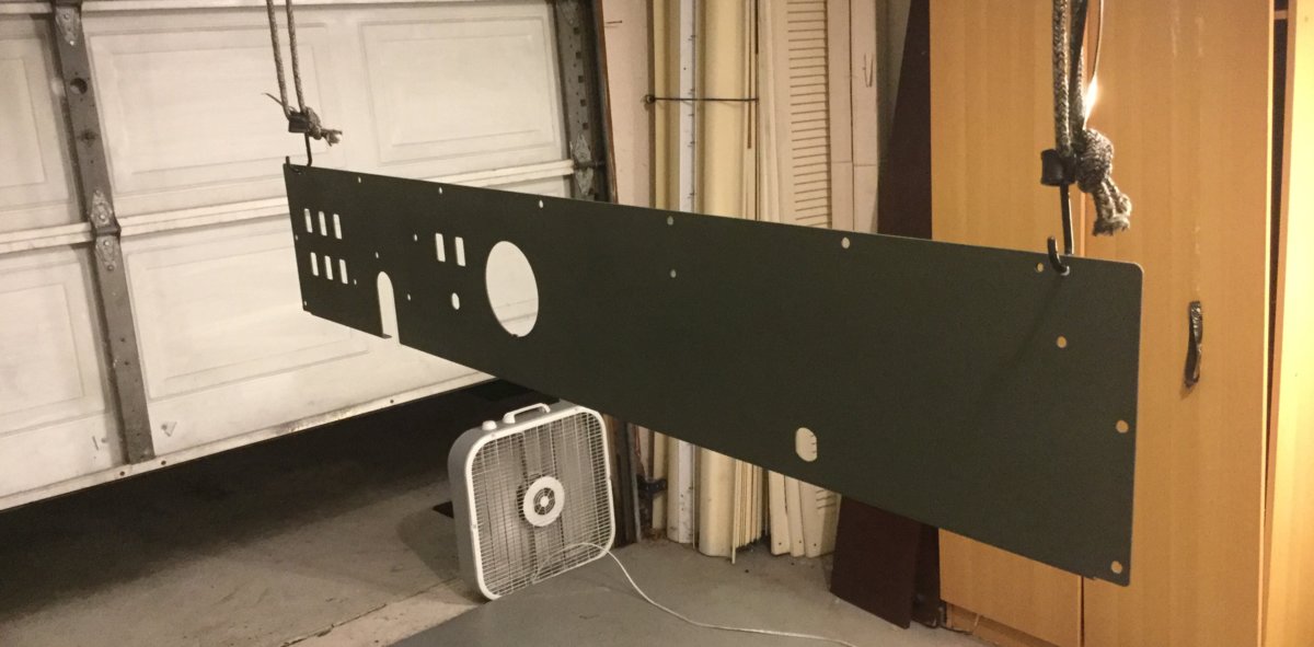

So im painting my dash white, since the paint code is RAL 9010 “Pure White” I wanna color match but that color code system is more common in britain and australia. The spray cans are expensive due to shipping from overseas. Ral 9010 is called “Pure White”, which exists as a Rustoleum color, but it is not quite it, its too white as I found out last night. As for the Duplicolor PW7, it is close, but still a bit brighter. Im going to pull the trigger on these state side Ral 9010 cans, about $15 each and $15 shipping unless someone found another white paint spray closer to the Roxor white.
PS: Since its the dash, it doesnt have to match 100% cause it could be a contrast piece, accent wall, type thing. But I would like to have touch up paint.

If you want a color match, take the tail gate off, and go to a PPG seller. They have a matching camera, called "PROFIT" it will give an understandable code. One of the threads mentions RAL 9010 p. aint. (white) I just ordered a can from Specialty Paint Place, Mckinney Tx. 972-972-4612.
total cost for 1 can 16 oz. spray is 13.85 + 19-96 shipping 33.81 total I will post if it works if not i'll do the ppg.

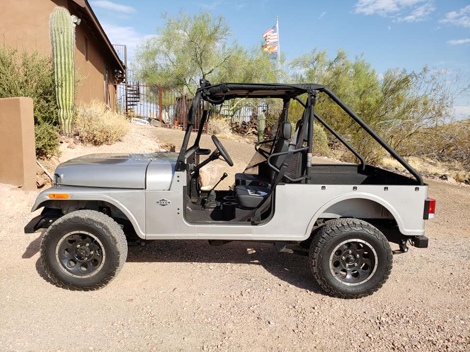

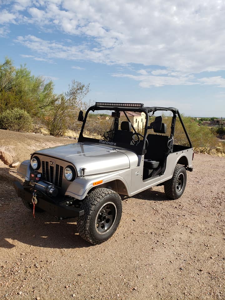

Who can tell me the color of my Roxor. The factory is telling my dealer based on my VIN that it is 938364 Mammoth Grey. I say it's more of Grey Aluminum Gloss. I am trying to get a windshield painted to match.
