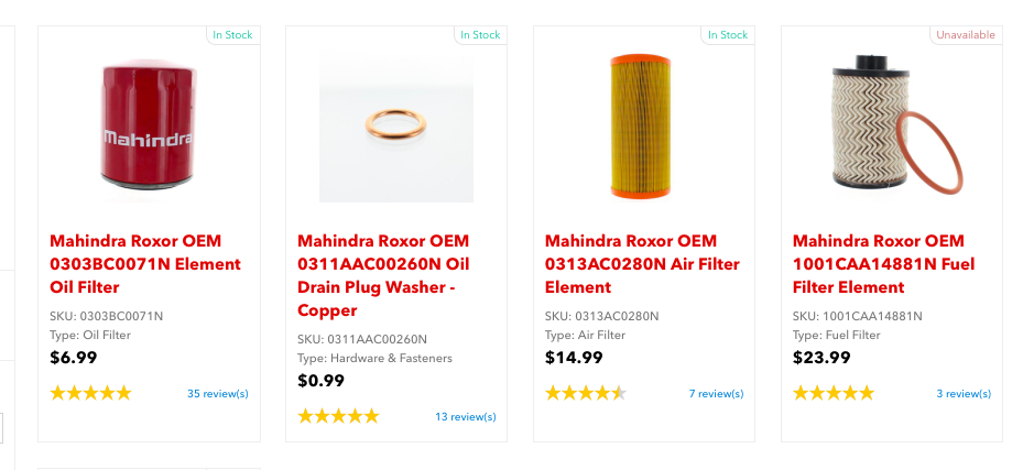

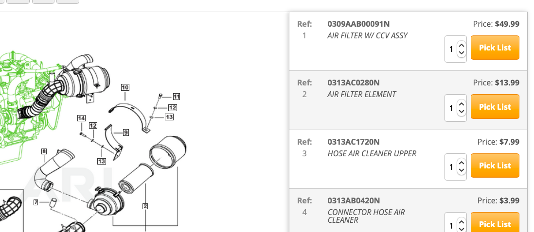

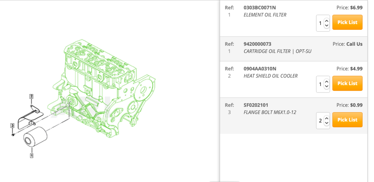

You can order the filter from our sponsor Sherwood Tractor at a great price. I ordered 3 of them online + fuel filter, air filter etc. a few months ago.
Sherwood makes a huge mark up. Plus stupid shipping rates. I will pay more. If I find it. With standard shipping.
Every 100 hours is what I go by, I don’t pay any attention to mileage as most of my cruising is below 15 mph on the trails. Of course that was after the first 10 hour change.
I found them reasonable at less than $8 per oem oil filter. If I remember right, I ordered 3 oil filters, a fuel filter , air filter ,gasket rings for oil pan plug, oh and almost forgot the notorious penion seal that I couldn't find anywhere else, and steering wheel badge .With shipping it was less than $84. Since I ordered multiple items the shipping was reasonable. This was last summer. It's a post on here about it somewhere.
However when I had just bought my machine, I ordered an oil filter from a dealer in Hattiesburg which is an hour from me and it was over $20 for a single oil filter with shipping.
Sherwood sells at MSRP on their site or within a buck or 2. They could mark up the MSRP another 50% like lots of dealer do and give "free" shipping. I'm glad my dealer sells at MSRP. Trick is to order a big enough care package that will last you a while.
Screen Shot 2020-05-17 at 8.02.36 AM.pngScreen Shot 2020-05-17 at 8.06.30 AM.pngScreen Shot 2020-05-17 at 8.08.24 AM.png
