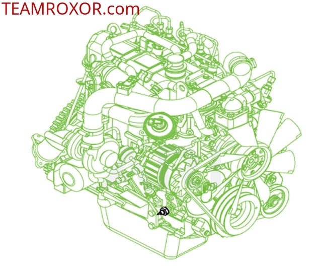

Ah gotcha. Heres the sensor, sounds like you're on the right track.
796
The oil light is just an oil switch, not a sensor. Switch could be bad. The switch closes to ground when the oil pressure is low.
