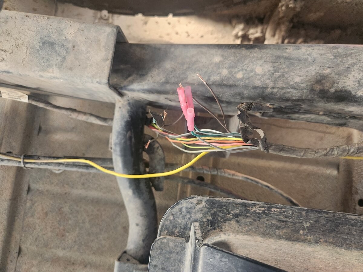

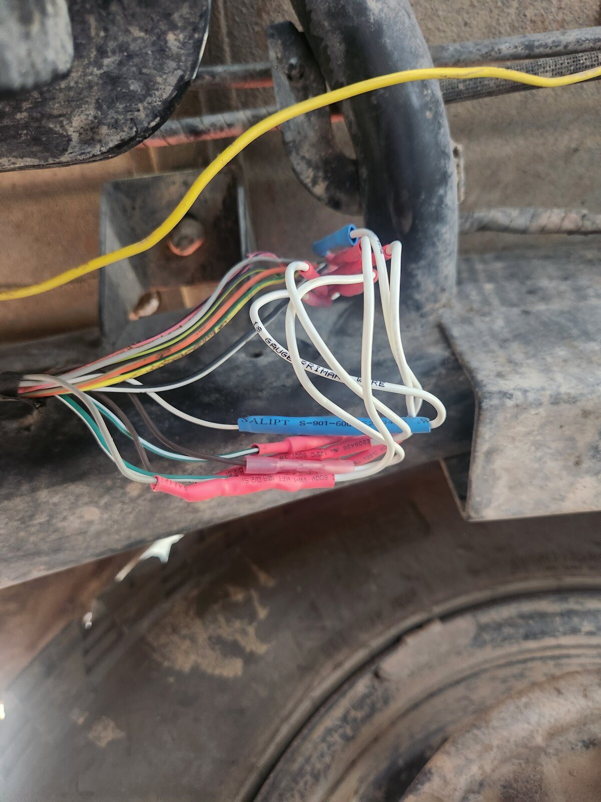

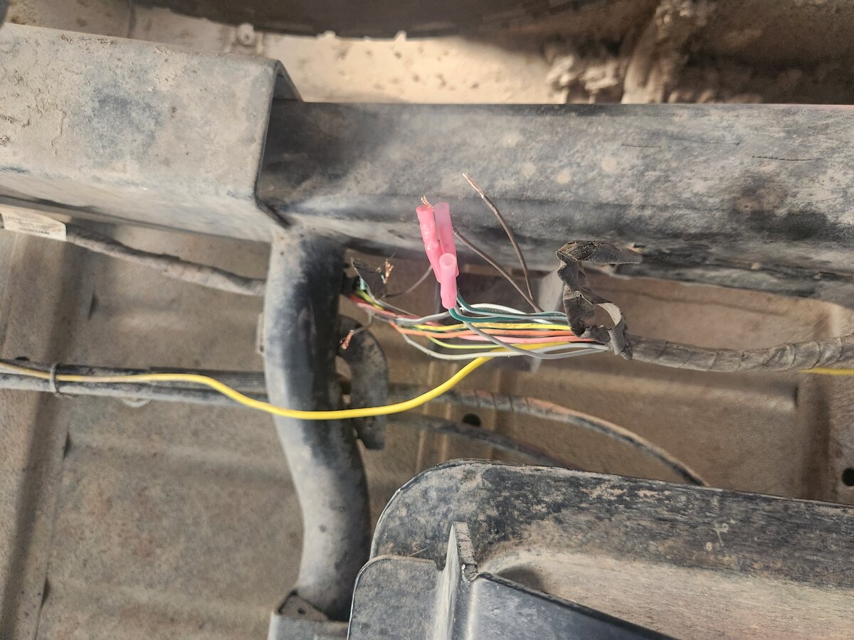

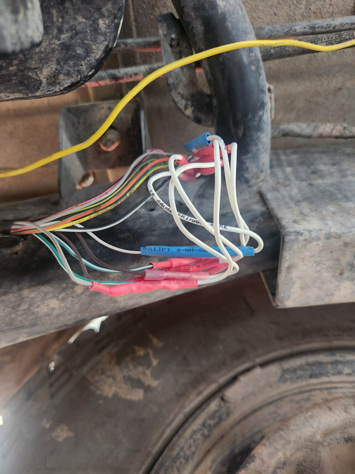

So after a night of thinking what I've done I've realized it must have been the huge log that lodged under there on last week's trail ride. Sure enough I had about 6 broken wires. Now I got everything working on the middle and backup lights. I've never gotten the top lights to work. Does anyone know what it's for. I got brake lights and blinker and running lights working. What color wires run that one. And what's it do on your Roxors?
View attachment 12574 View attachment 12575

The top lights are turn signals and aren’t wired in from factory . I spliced into them for my turn signals.

Correct, top lights are not used
I wired mine in for turn signals too
