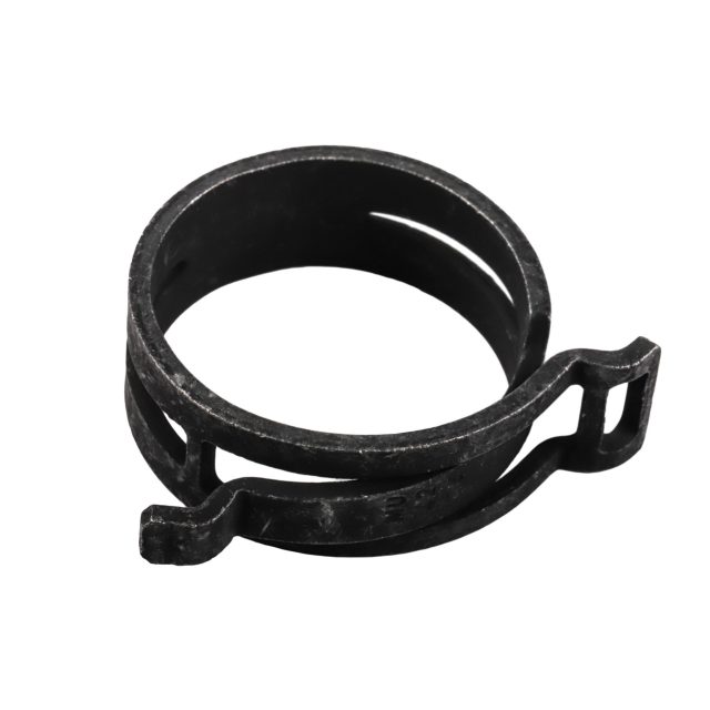

@Longslyde Thanks! I'm seeing a couple of different styles. Can you be kind enough to drop a picture of the style you feel does the best job?

@jbrenza Factory Style GM clamps work well if the hoses are the cause of your seeps.
This style:
