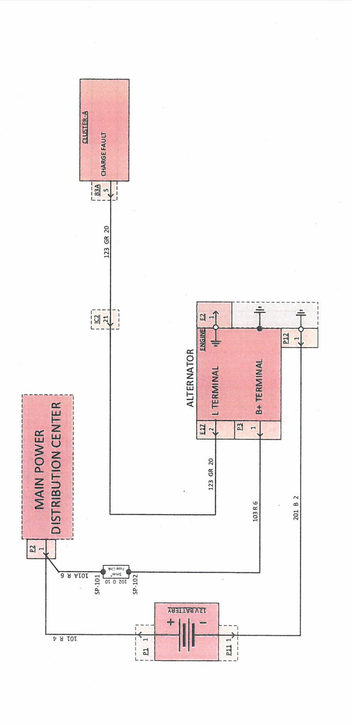

@Buckpasser: if you have a simple, hand held meter, you can measure if there is any leakage current on the jumper you put in.
Also, you can find the electrical schematics for the Roxor on this forum. See to what the alternator connects. That way you're sure the jumper does not feed any current or voltage where its not supposed to go.

I just looked at the wiring diagram. Usually the lamp terminal (the wire running to the gauge cluster) only comes on when there is a problem. I don't see how it could affect operation. My guess would be that you burned out the fusible link in the wire going to the B+ terminal. That wire is responsible for telling the alternator when to turn on. That's why it works when you introduce a jumper wire. I would test that wire for continuity and then replace the link if it needs it. I believe the R designation means the wire is red so that should help you identify it. Good luck, we're here for you if you get stuck.

My cluster replacement FINALLY arrived last week. I was able to go collect it and install it this week, and FWIW, the factory exciter wire is now working again. I believe it is in fact controlled by the cluster, as txroadkill said or at least disabled by the absence of it. It is so nice to have an idea of fuel level, speed, and RPMs at a glance!
