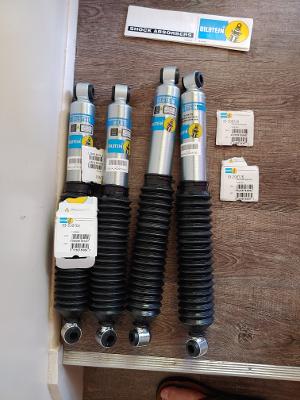

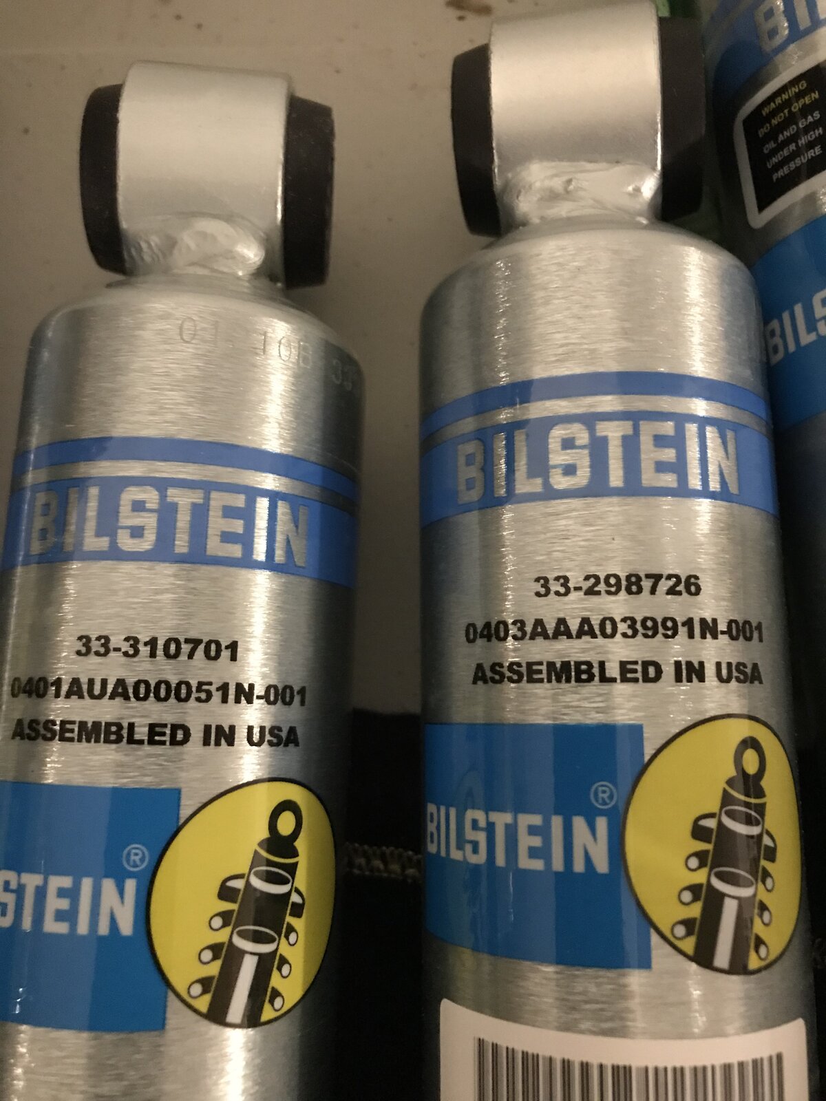

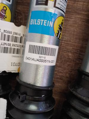

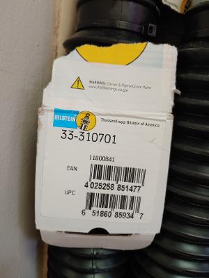

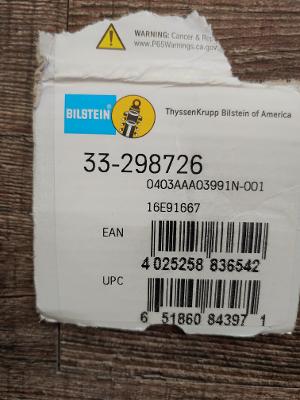

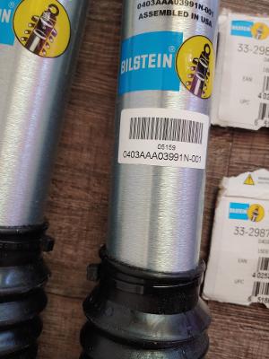

So the Shocks just came in, and they are different. Bister you were correct(again (y)) There is about a 1 3/4" difference. I will put the shorter ones in back. I will also update when I am done with a before and after picture. Hopefully later today.
View attachment 7329 View attachment 7330 View attachment 7331 View attachment 7332 View attachment 7333
Mine are all the longer front ones. Not sure if somewhere along the lines someone screwed up or they changed things. I'm good with them the way they are, not going to lose any sleep over it. I have bigger things to lose sleep over.

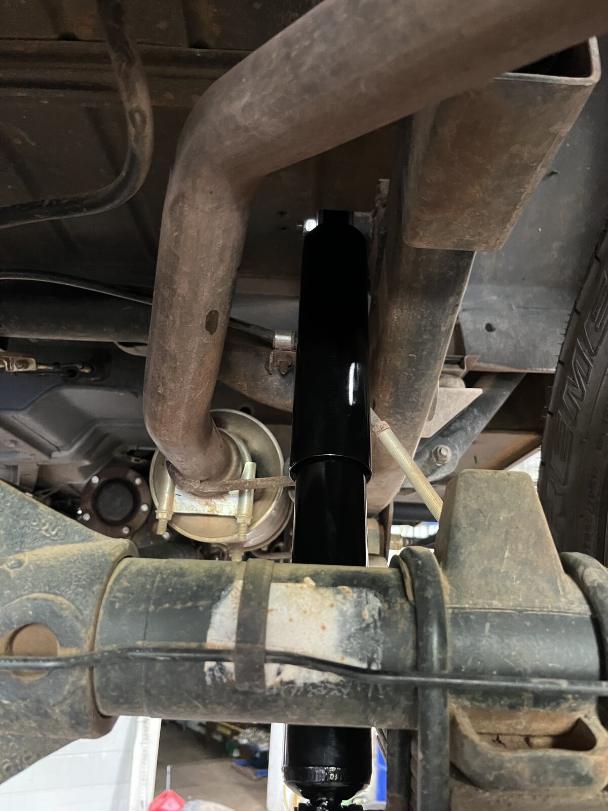

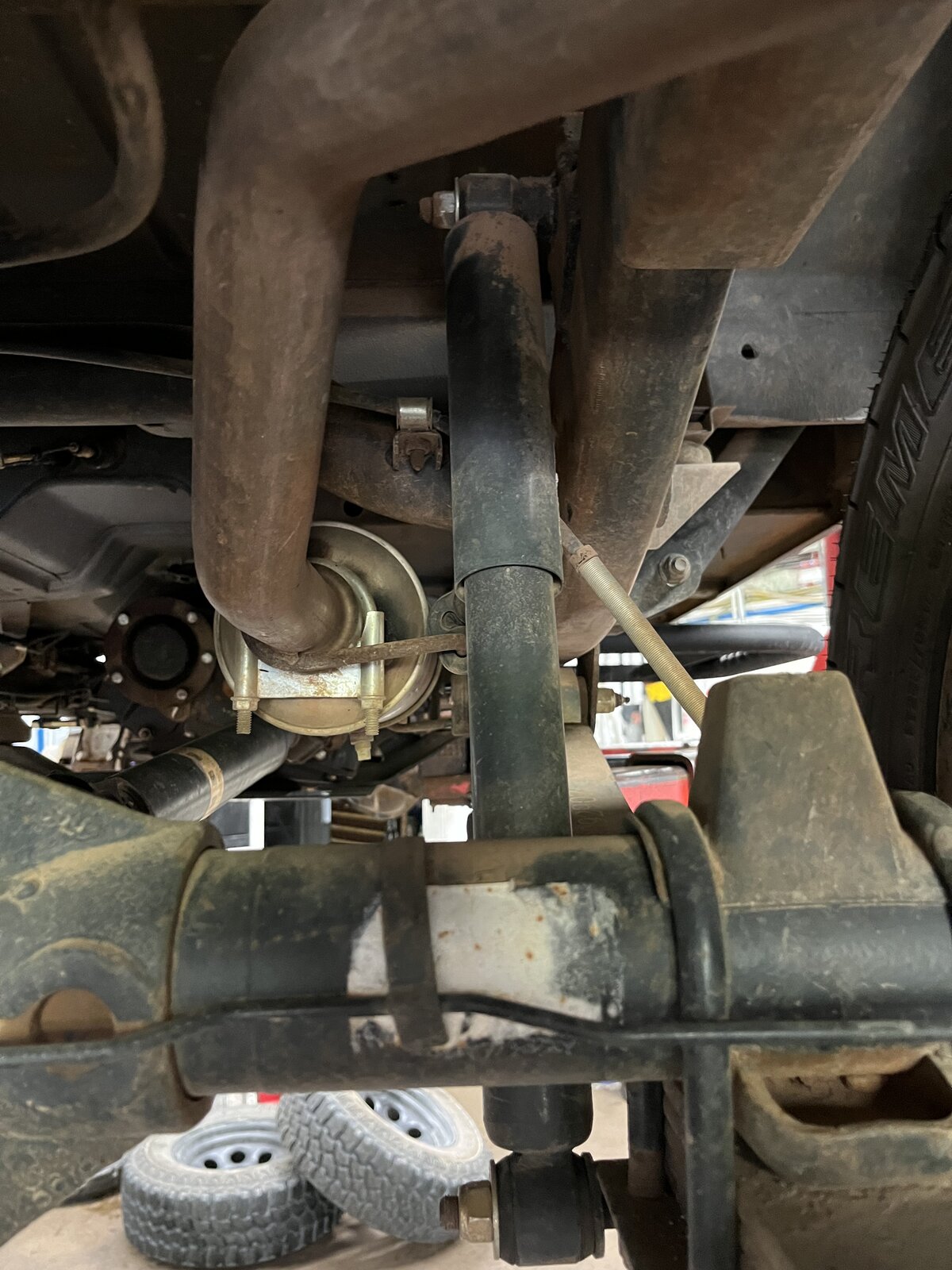

For what it's worth, I ended up going with Duralast P/N TS34-30953B shocks after I installed the Rough Country 2.5" lift. Ive been very happy with them. They are for the rear on a 2003 Nissan Frontier for reference.

I looked with the Duralast part number and didn't find anything on Amazon. However, I searched for 2003 Nissan Frontier rear shocks and found a lot of options. I can't remember exactly how the extended/compressed length specs matched up but I remember being satisfied that they were a good match. They have worked great for me.

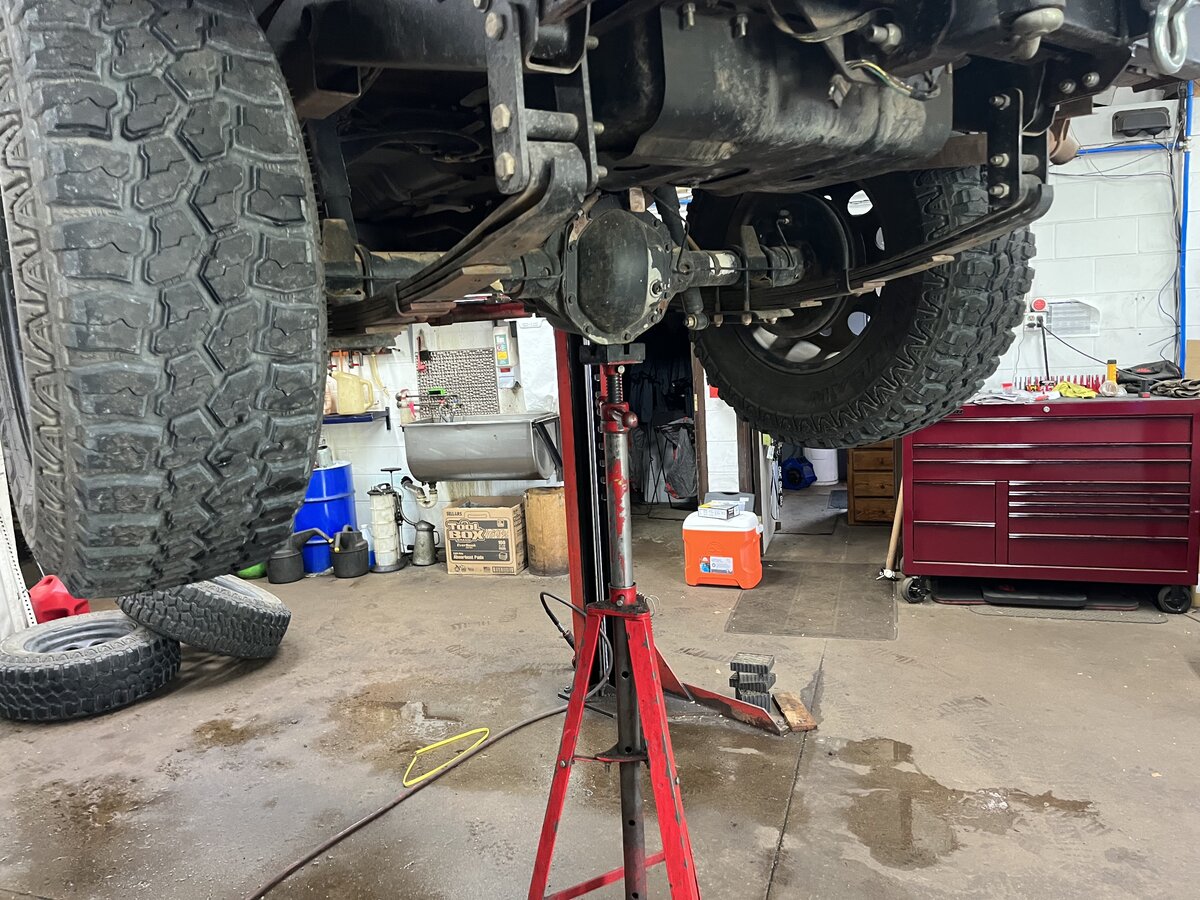

I used the duralast shocks and MAN what a difference. Rides sooo much better
