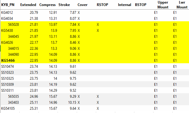

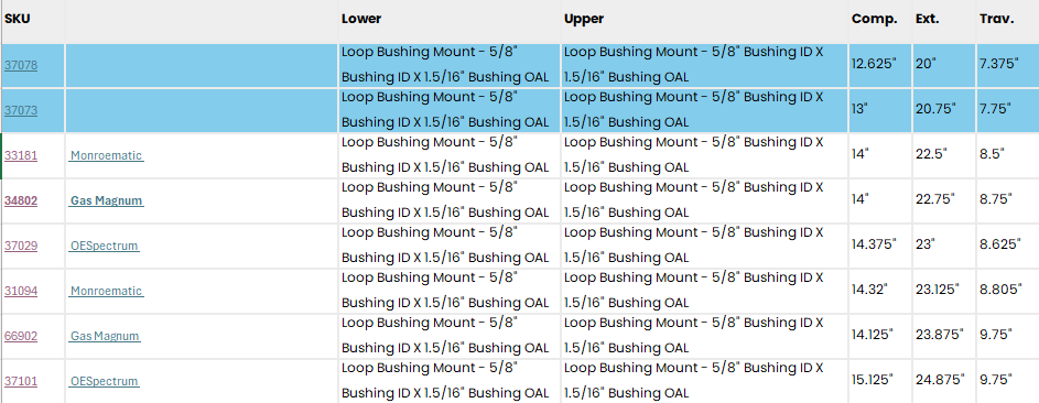

Here's some info I found recently while pondering what shocks to get. I ended up just going with Monroe 37029's to start. The ends will need to be Loop ends with rubber bushings with an I.D. of 5/8" and a length of 1 5/16" or thereabouts.
Monroe shocks that should work:
KYB Information:
I priced shocks at Amazon and Rockauto. Prices were almost the same at both sources for KYB, but Rockauto was significantly cheaper on Monroe. Hope this helps somebody.
