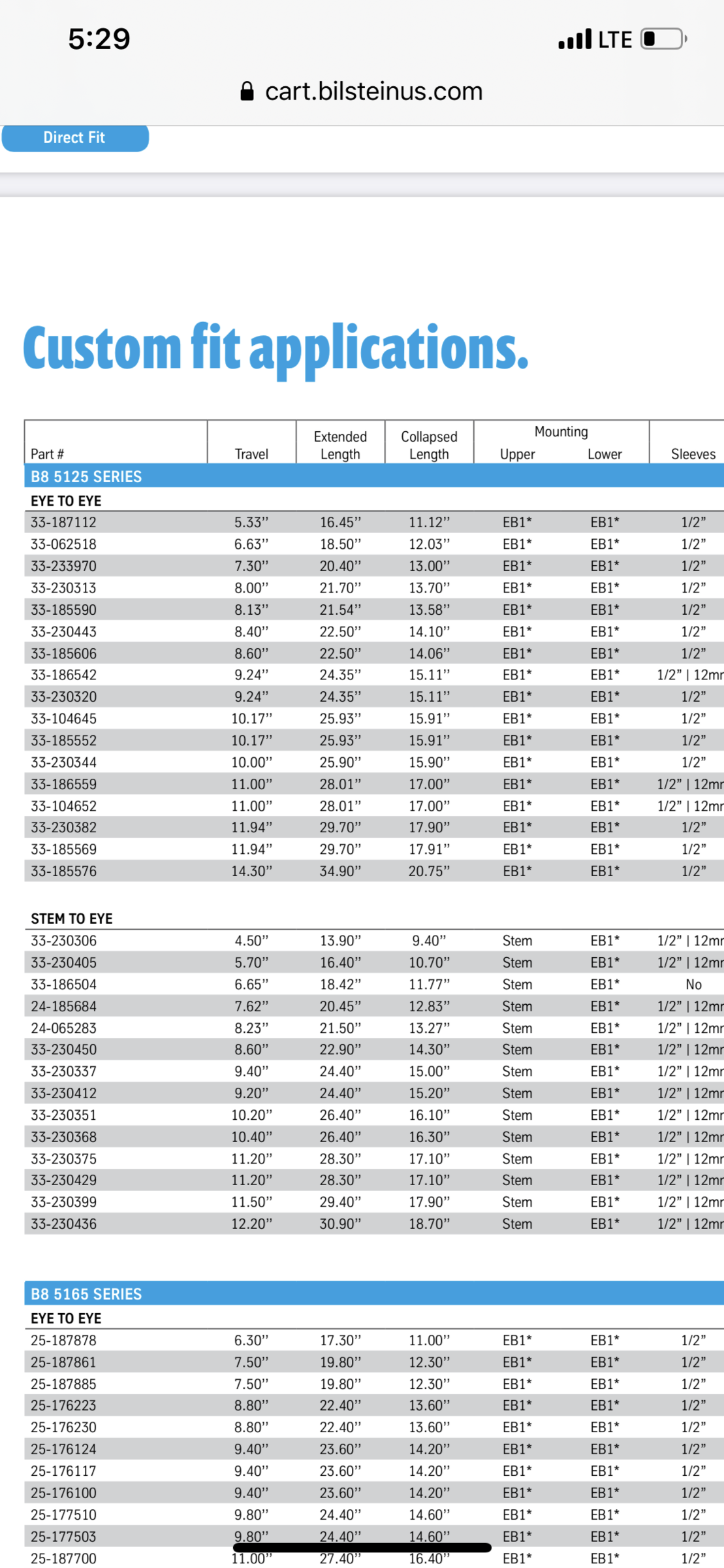

I’m using front# 33-186542. Rear 33-230443 ( slightly shorter). no need for a new brake line on the rear. Lift springs from McVeighs truck springs..

Yes you need to check the rear. If the shock is too long you’ll bottom to shock out when you hit a big bump. The shock I’m using gives me the same travel both up and down with the lifted vehicle

I’m not sure on yours. Check full extension, ride height then check specs of new parts against your old shocks. Bilstein has all the specs on line. You need to make sure you have enough compression travel as well as full extension for when the wheels come off the ground.

The Roxor shocks won't be in that list, I believe they are specific to Roxor so you won't be matching up any numbers there. The new kits apparently have 2 different sets of shocks and the short ones go in the back.

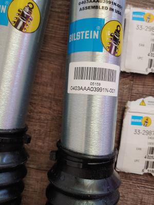

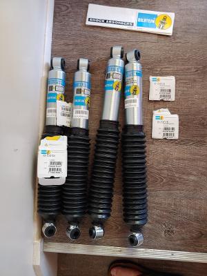

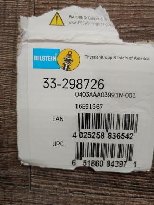

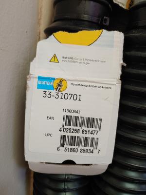

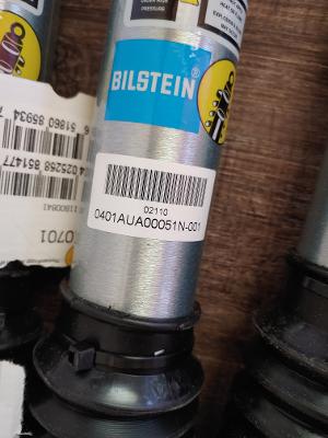

So the Shocks just came in, and they are different. Bister you were correct(again (y)) There is about a 1 3/4" difference. I will put the shorter ones in back. I will also update when I am done with a before and after picture. Hopefully later today.

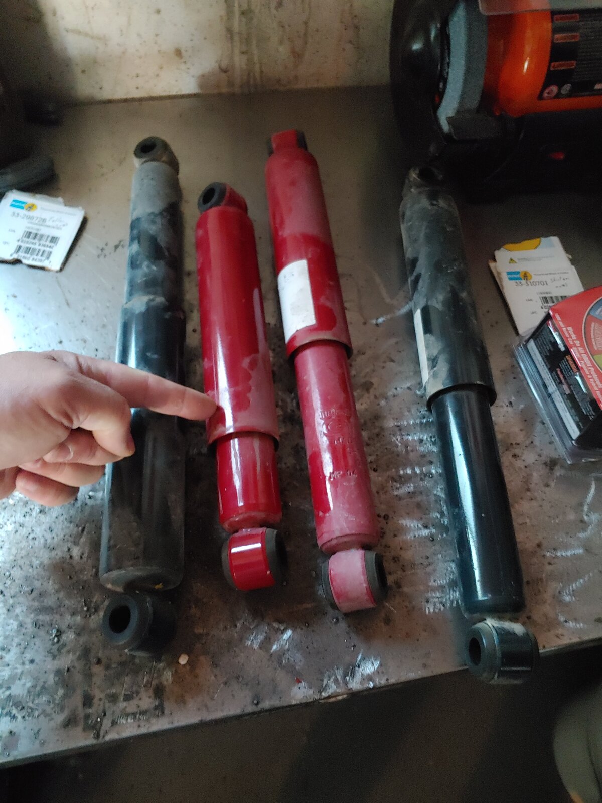

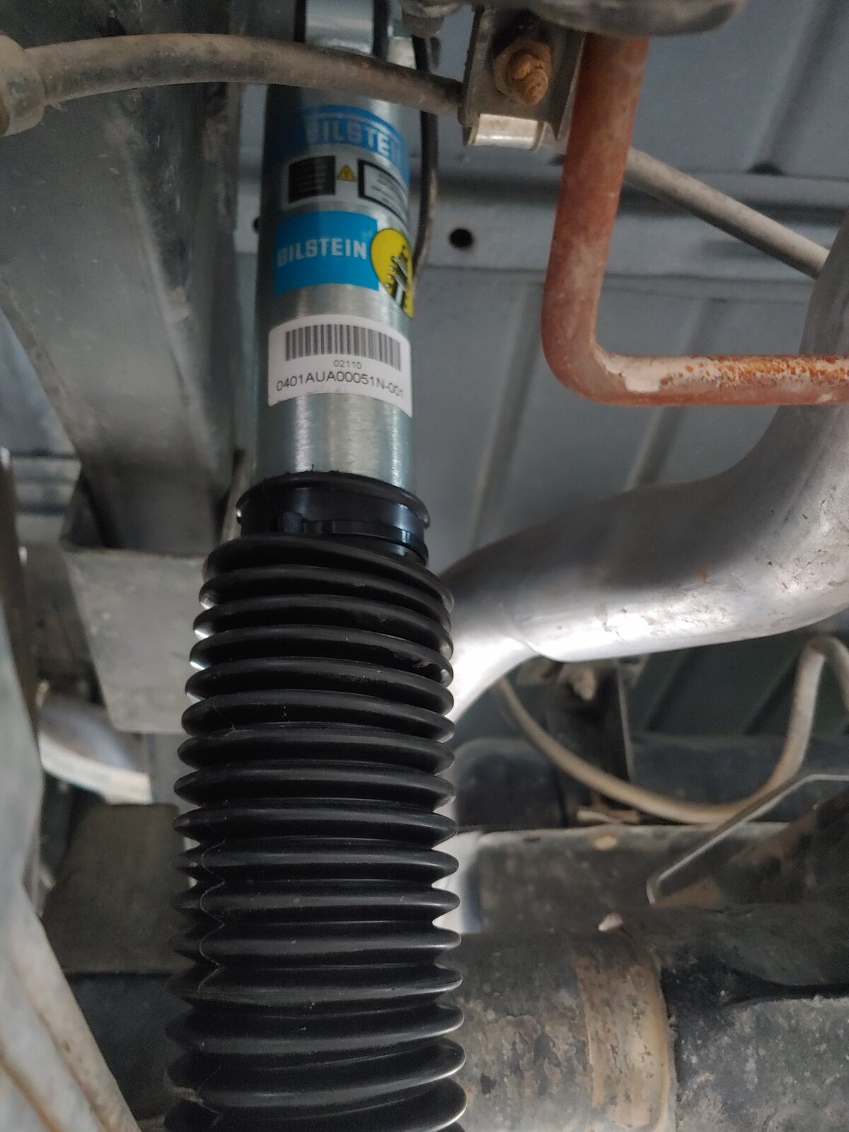

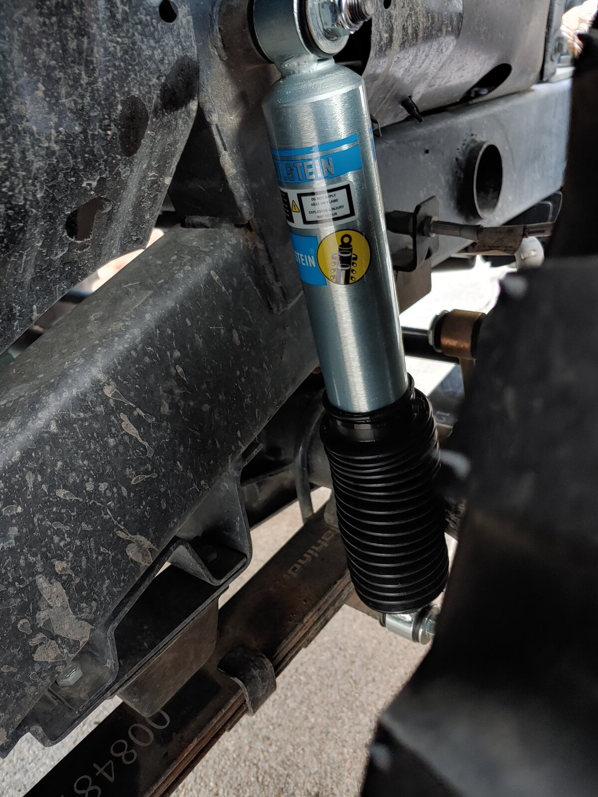

Well easy switch out, took less then an hour, with my pinched nerves in my back. The old ones weren't doing anything, they weren't even compressing or extending at all, no throw in them, as you can see in the picture.
