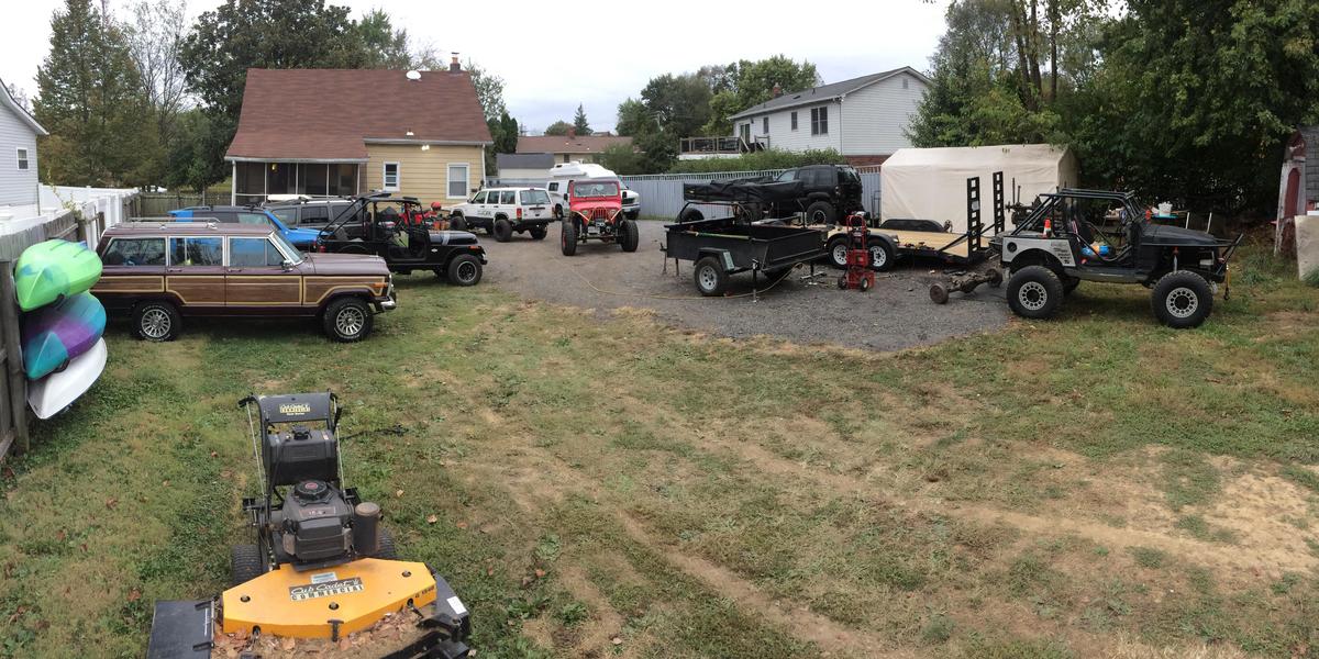

I got home and parked it with the collection. Got out my lawn chair and stared at it, wondering where I’ll go with this project. View attachment 5576
