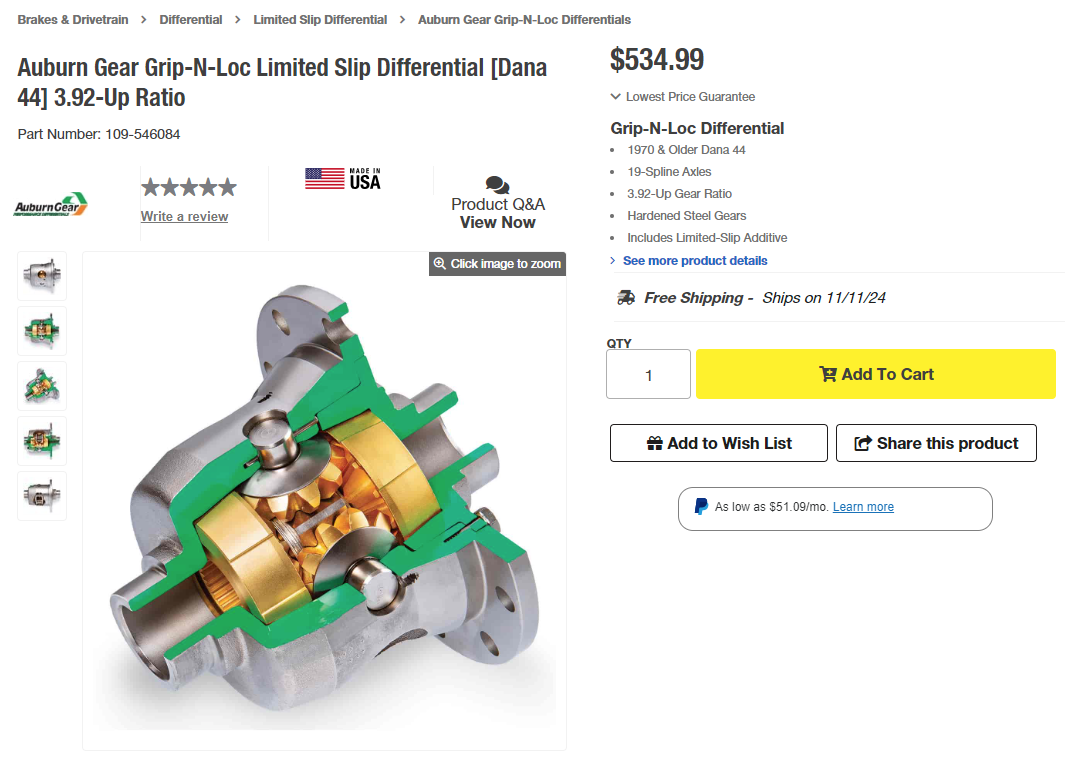

I was hoping somebody on this site had an LSD in the rear; specifically the one below:

Interesting. Looks pretty good. But I am probably just going to go with OX locker and then just lock when I need it. I do that with my mule and it works perfectly.
